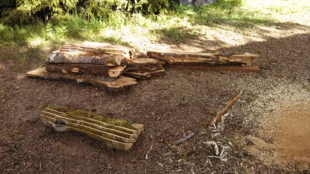

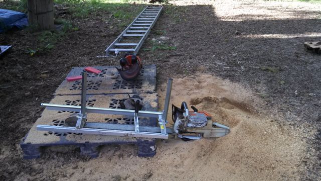

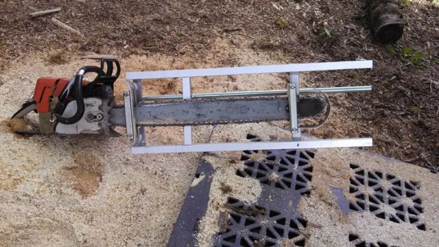

After having it on the shelf for 2 years the inlaws showed up and busted on me for not slabbing up some cherry and walnut we had sitting around. Given everything it wasn't to big of a deal. I need to learn a bit about how to set up the logs itself to accomodate the rig, weight of the log an such. Cutting on plastic pallets wasn't the most effective way I could have conceived. Advice is always taken.

Do you run that with a regular chain, or do you need a special ripping chain? Seems pretty cool!

Well, the wood is not for me. I bought the mill to make a few outdoor benches out of maple and cedars we have. Woodmizer would be great, but at the end of the day we have very little useable timber. Woodmizer would be cool. Yes, I do have a "special" ripping chain. My local Stihl shop ground a normal chain to a straight cut. Said it was cheap and easy way to do it.

Did you use the ladder as a guide for the first cut? How did you level it to the log? Wedges? How about locking it down so it is stable and level?
