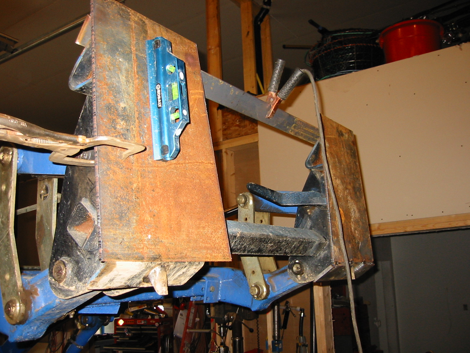

   / Skidsteer adapter plate #8
Have you considered building one? They are simple!
I live in Alaska and the freight would double or triple the cost, so I don't even consider buying one, however where you live shipping cost may not a big deal. I have built 3 they all work great.
Here is a pic "fabing" one up.

AK Pilot,
Any more build pics of your SS plate?
