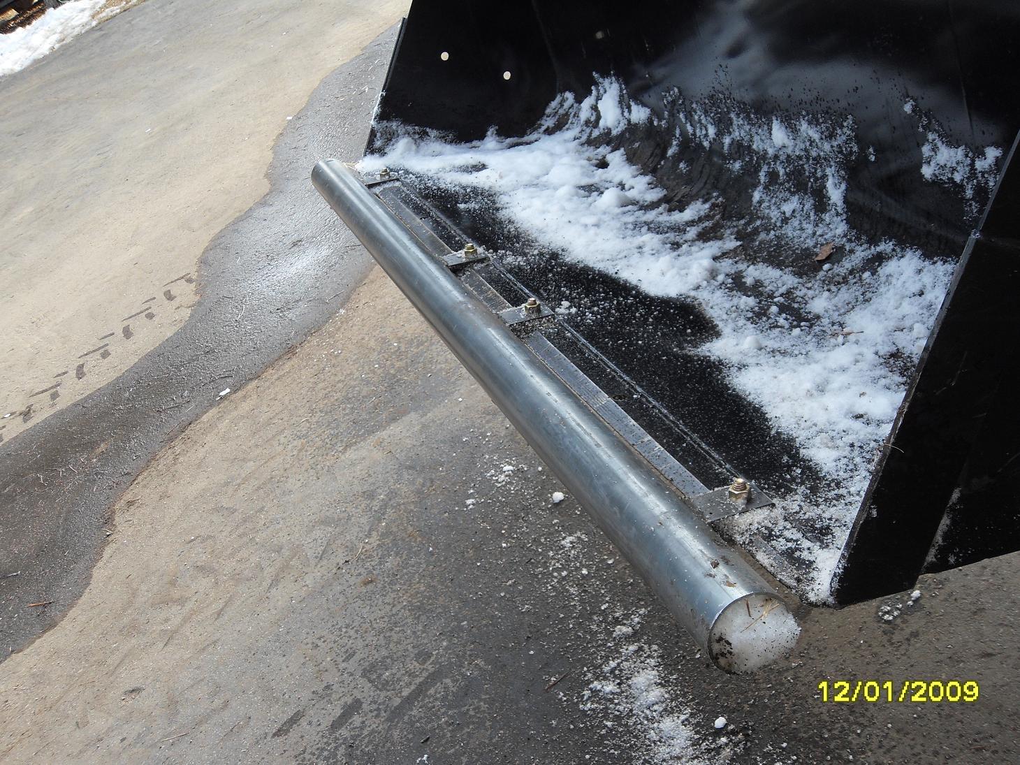

Hey CrKub,
I've been using my FEL for pushing snow for past 3 years .. Prior to that used ATV with Blade.
I will admit I'm not to concerned about scratching my asphalt (but I do understand why you are) ..
I fab'ed up a 3" steel pipe to put on the front of my FEL bucket to prevent me from scraping up all the gravel off of the road ... it works GREAT .. however I will admit that the end of last year, and the 2 storms this year I have not put it back on .. I just keep the front of the bucket angled up a bit and I seem to get the same results w/o the hassle of putting the pipe on.
Long story short .. I would say just make sure the front edge of your bucked is angled up a bit and I think you will be fine. Also .. chains .. make a WORLD of difference for ice/snow traction.

Thanks for the ideas. Never thought of putting a pipe on the front edge. I may give that a try.
I have plowed with a FEL before without too much scratching. And it was on a larger L series Kubota. But the bucket edge was nice and straight so I figured it helped distribute the load. Whereas mine has a curve to it and will put more loading on the edges.
However if tipping the front edge up helps, I'll give that a try as option #1. The back edge is much straighter and should distirbute the load better.
Incidentally both my B7500 and my dad's L series have loaded tires. Never had any issues with the L, but it has Ag tires. Mine has industrial tires and a lighter machine, so maybe it will be a challenge. I guess I'll see how it goes first, then consider a bar and/or chains.
I guess I was hoping there was an easy set of bolt-on skid feet with a softer wear surface, but probably not. It would interfer with getting the cutting edge down, which is often needed.
