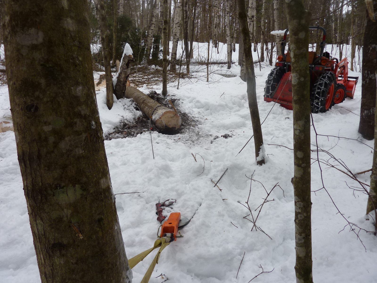

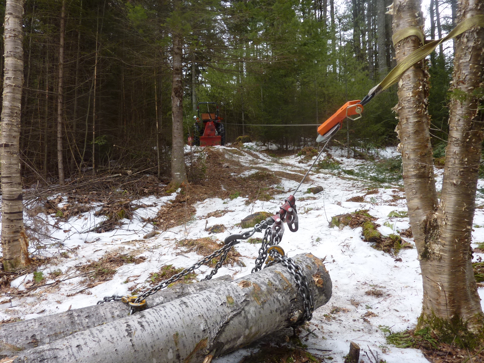

Also get a snatch block if you are thinning so you can protect your keep trees and keep your tractor in a safe position when winching.
gg
   / Skidding winches #4
i have a farmi 351 on my kubotaL2650 and love it..i agree with getting a snatch block for the time when you can't get a straight pull as i did that once and had my tractor on two wheels before releasing the winch!!!!

Thanks for your input, I plan to get two snatch block to do some redirect and get the mechanical advantage going for me. What do you guys think of the self release snatch block? They seem pretty nice. Whats wrong with hydraulic winches, is it better suited for bigger tractor?
Nice pictures Gordon your place looks pretty much like the kind of forest im working in.
   / Skidding winches #6
Self release snatch blocks save a lot of work and time. Here is a short video og mine at work.
Big Pine - YouTube
Hydraulic winches are very slow - at least the ones I have seen. Hydraulic motors are pretty inefficient. That and the relatively small flow rate of a small tractor means the winch will be slow if it has decent pull.
