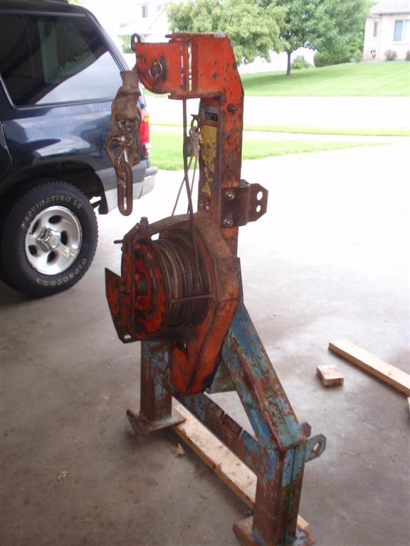

So a friend of mine sent me his old skidding winch, a Farmi JL304 that is right about 30 yrs old. He used to use it on his Ford 9N for his firewood business when he was in high school and college. It had been kicked around a lot over the years and was in sad shape with the main post bent and needing bearings and a lot of cleaning. So I got the post fixed, and they also straightened out the severely bent guard that was binding up the drum. New bearings, new hardware, clean it up, fresh grease everywhere, and we took it out to give it a test run.
Got it mounted on the L3130 no problem, and only had to spend a little time adjusting the clutch to get it working correctly. So we try it out on a small log, and it works great. Then pull a large poplar and it zips it right along. So we go to grab a decent sized oak ~16" dbh, and it won't budge. It wasn't slipping the clutch it actually stopped the PTO shaft dead at full clutch engagement:shocked:. Obviously that isn't a good thing, so I quickly released the lever. Tried again a few times and same thing. It dug the winch feet in deeply but would just stall the PTO in the end.

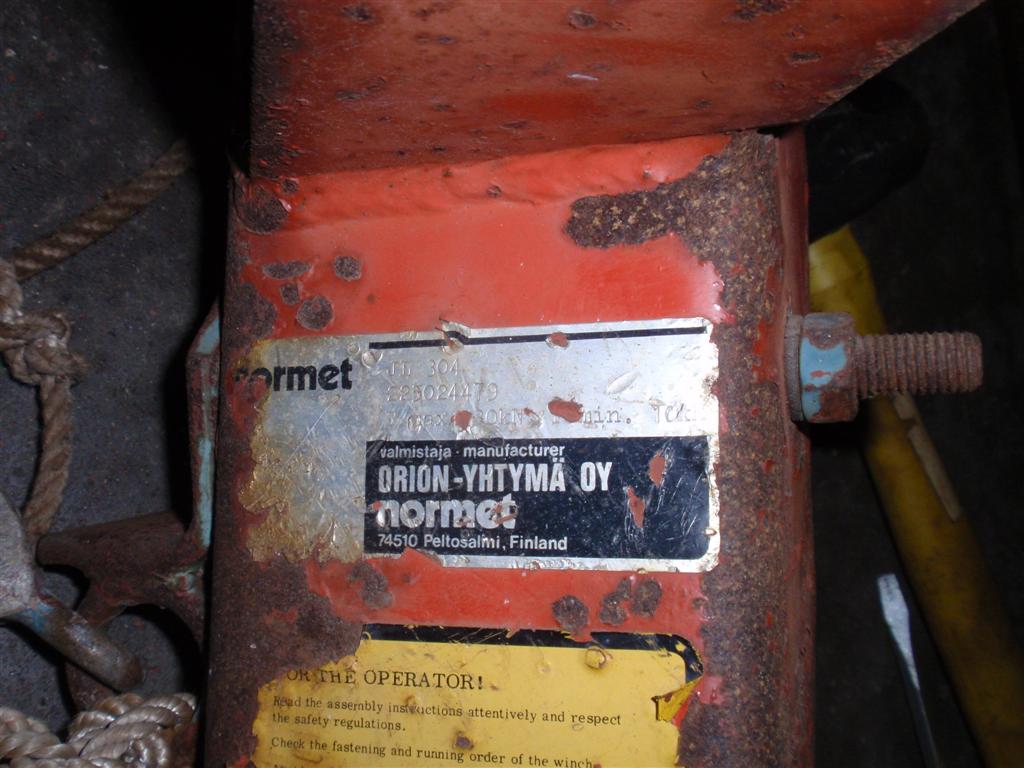

This tells me I need more hp if I really want to run this. I don't consider this one a huge tree, so I really was surprised it wouldn't move. So the question is how much do I need? I would stick with an L-series as it is the right size overall, so I'm wondering which engine would be about right. The only thing I have for info on the winch is the label that says 30kN max 10 kN min. That doesn't do me a lot of good as PTOs are rated in KW or hp (power, not force) and besides, which force? The pull on the cable or the input? No clue.
I guess I'm just fishing for any experience others have in sizing the tractor to fit this application.

Hi Dave, I think your assessment of the winch clutch is right - it's doing what it's supposed to do. When tractors get loaded beyond the torque they can make, they stall. No big deal. The clutch on the winch is to gradually apply the available power, whether there's enough to do the job or not.
The 30 kn winch rating is 6,744 pounds (handy units converter here) which is similar to today's JL351 rated at 40 hp input. By proportion, the 9n has 20 pto hp (not discounting for age and wear) so it would be expected to max out at maybe 3,000 pounds, running about 1500 rpm. What rpm was it running?

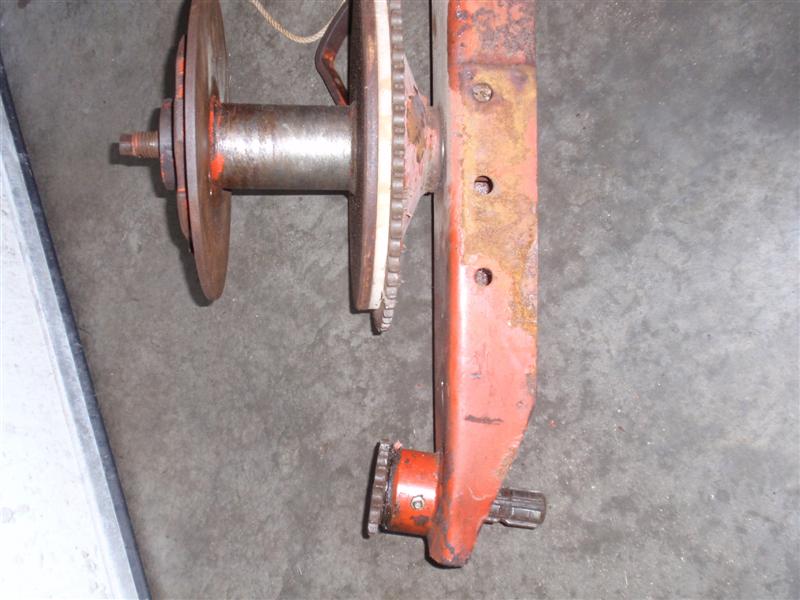

is there anything on that winch to gear down the ratio? this would give you more turning torque with less HP.
   / Skidding winch - need bigger tractor?
It is geared down a lot as built. See the pic below (before the main post was straightened). The lower sprocket is the PTO shaft, the drum sprocket (back of the drum, behind the white clutch friction material) is 8-10x the diameter.

Dave - is the 9n's governor working? When the winch clutch is engaged does the throttle linkage move to give it more gas? My 8n had lots of power after the governor linkage freed up and adjusted.
BTW count the sprocket teeth to get the ratio (looks like 5 or 6 to 1). The 9n is rated at 84 ft-lbs pto torque. Multiply the 84 by the ratio and divide by the radius of the cable to the center of the drum (in feet) - to get the cable force.
