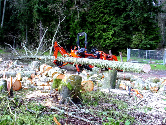

Penokee,
This really doesn't qualify as dragging, but I had to move several logs a fairly short distance (up to 100 feet) and didn't want to tear up my lawn or drag the logs in the dirt. (see attached) I started by trying to use my FEL and it just didn't have the control or lift. Then I tried my BH and it worked great. It was fairly easy to find a balance point, the bucket was easy to get under the log and it has more lift than my FEL. I left the stabilzers down about 6 inches off the ground and SLOWLY moved all my logs over to my cutting area. Plus, I could lift the logs to a comfortable cutting height. This of course requires an open field, but I thought I'd share this, in case anybody needed one more reason to cost justify a BH... /forums/images/graemlins/grin.gif

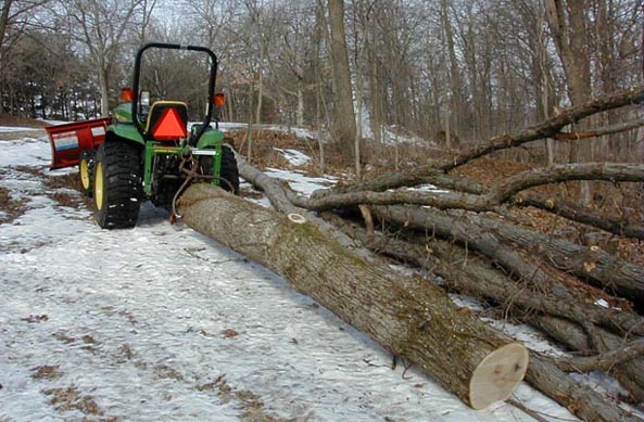

I hook the logging tongs to the top hook on my iMatch and pull big logs out of the woods with that setup. Care needs to be taken to keep the front end down, but the FEL with forks or bucket seem to do that very well on my Deere 4300.
A search on logging tongs here should get you additional information. I find this method the cheap way to do it easily.

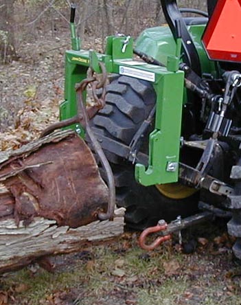

Another shot of the tongs close-up with the end of the log carried high.

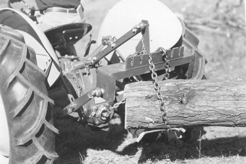

Used to have an 8N Ford with a 3pt 'arch' with chain slots that worked almost as good as the iMatch quick hitch. Here is a shot of that arrangement.

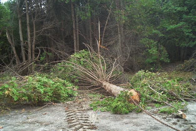

Onee thing that should be noted...
If you are just going to "drag" them be very, vey careful. I know of one local guys years ago (and I've heard of more) that died dragging logs. If you are going at a decent speed and the log catches on a stump or something, it's possible the tractor will stop and then pivot on the rear axel and flip over backwards.
We've been skid logs out of the bush for yeras, either just draggin them or trying to lift them off with the 3 pt. hitch.
I dragged afew cedars out of the bush this summer, but nothing major or for a very long distance.
