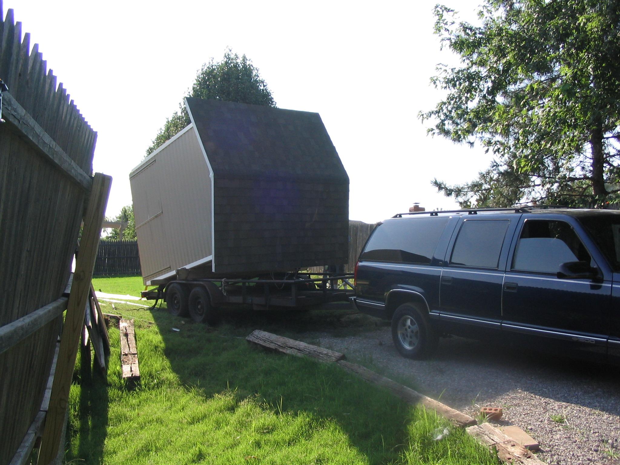

Just built an 8'x8' shed in my shop and had to move it to a new location. Used my tractor with forks, some concrete blocks, and heavy 4x6 timbers from our local saw mill to ride the shed above the wheel wells on my trailer. Just placed a couple of 10' 4x6 timbers as ramps for the way back off of the trailer using my forks again. Looked kinda scary but was actually pretty solid and worked like a charm. Pictures attached.
Pushing out of shop
Lifting onto blocks
Backed the trailer underneath the front of shed then lifted the back of the shed with forks and pushed on.
Ready to roll
