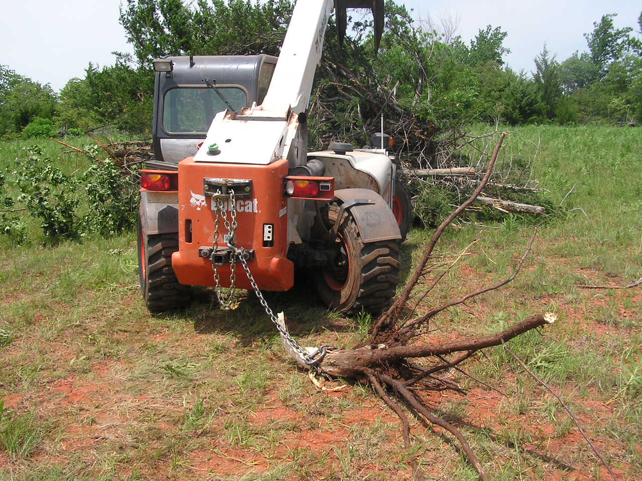

Look for a used Compact Telehandler with a SSQA on the boom. With 4 wheel steer and crab steer it will get aorund in the woods better that a CUT.
Here is my 6' wide, 6.5' high root skidder:

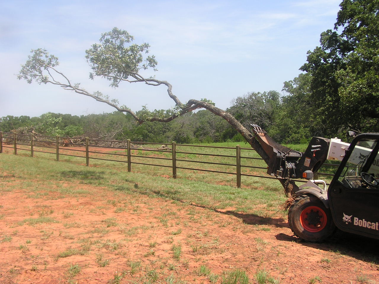

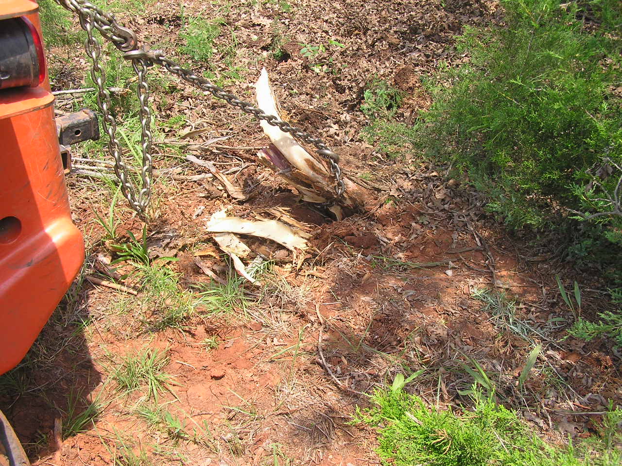

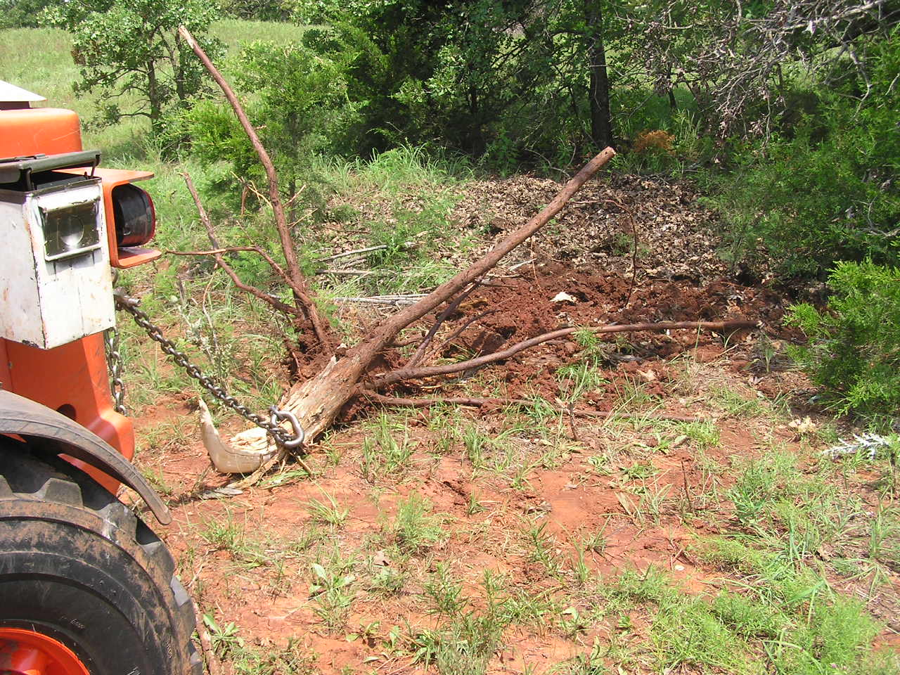

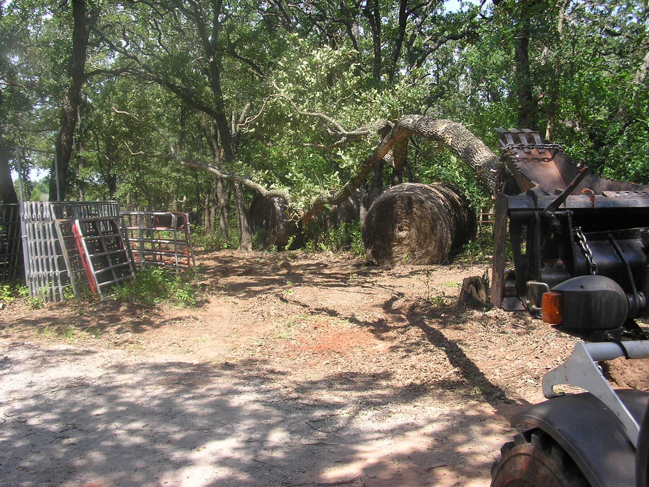

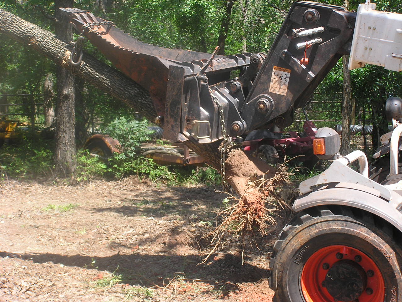

And another way to move trees.
This oak is 35' long, pushed it over with the stump bucket and backed out:
