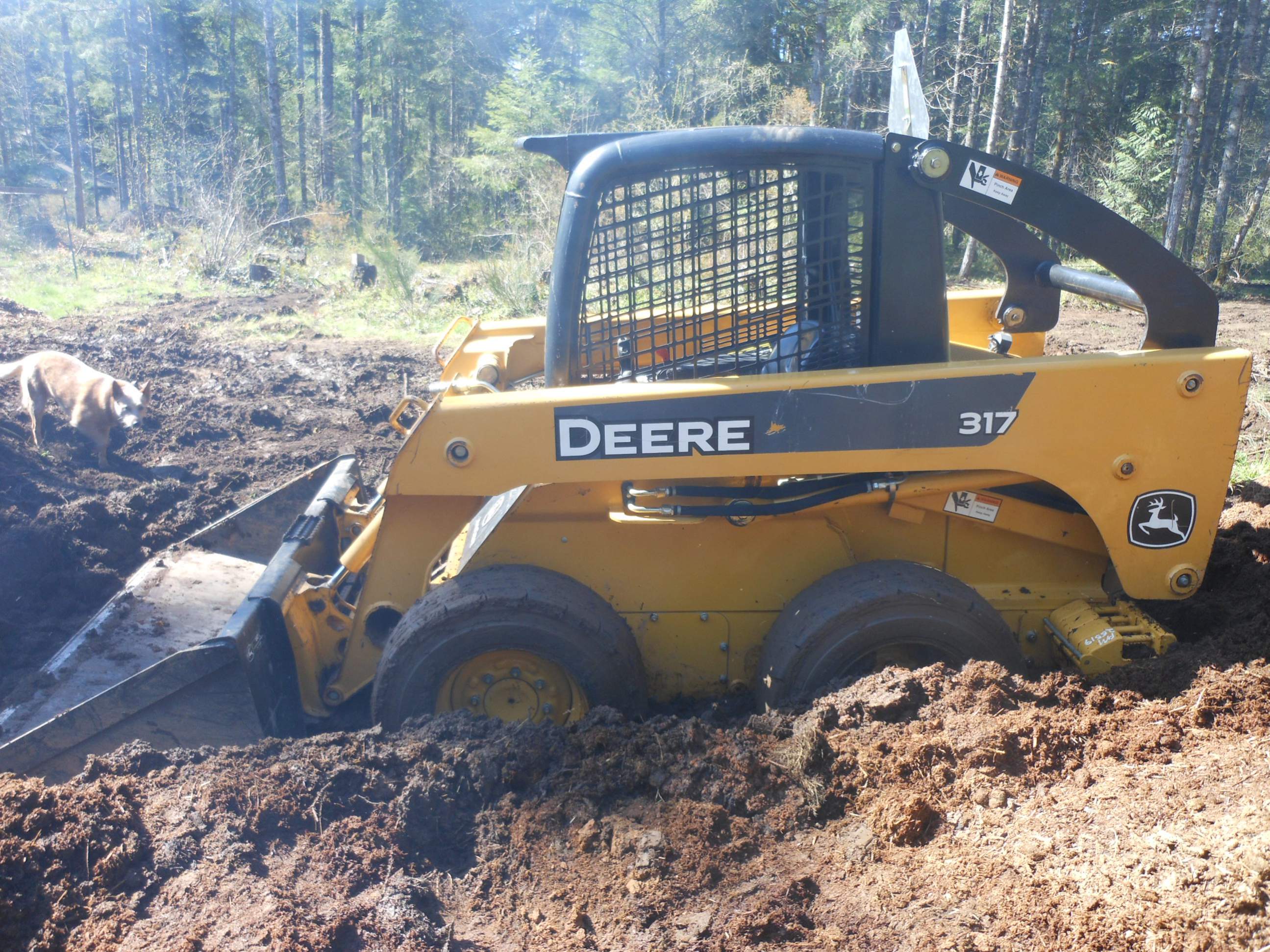

I have operated numerous brands of skid steers and CTL's and personally favor Deere over the rest. I personally have a 2004 Deere 317 skid steer and absolutely love it. The lift capacity w/ rear weights is about 1 ton, it is compact enough to get into tight spaces (I have done some residential side jobs with it before), it has the power to do some serious digging, and you can access almost anything when you raise the boom up and remove the side panels. The new D series is very much alike the "older" 300 series however the inside of the cab IMHO is much nicer, the buttons and gauges are laid out better and I really like the new cooling system Deere implemented into the D series. Just from experience, you can get a used Deere for almost half the cost of a new one, I paid less than half of new on my 317 with only 1036 hours on it. I highly recommend over the tire tracks, it is pretty easy to get into a bind and eventually get stuck in a skid steer, my 317 has been stuck once and it took an hour and a 1 ton truck to pull it out. I also had brand new tires on at the time. With over the tire tracks you get the traction needed for muddy soils, much lower operating costs vs/ a CTL, and they are removable/weldable when they need work done to them. At the same time a CTL has much higher lifting capacities and floats across uneven ground vs/ the jarring effects of a skid steer. As far as other brands go, Bobcat and New Holland make great machines, I personally believe the cab on the new Deere is nicer than the new New Hollands. With ASV and the older Cats you get an undercarriage made of plastic components, it doesn't strike me as the most reliable system and at $10k to replace an undercarriage it doesn't make financial sense to run that as a personal machine. Case and Gehl make reliable units as well, the New Case is exactly the same as the New Holland so you could use that to you advantage on the price end. Just my :2cents:
