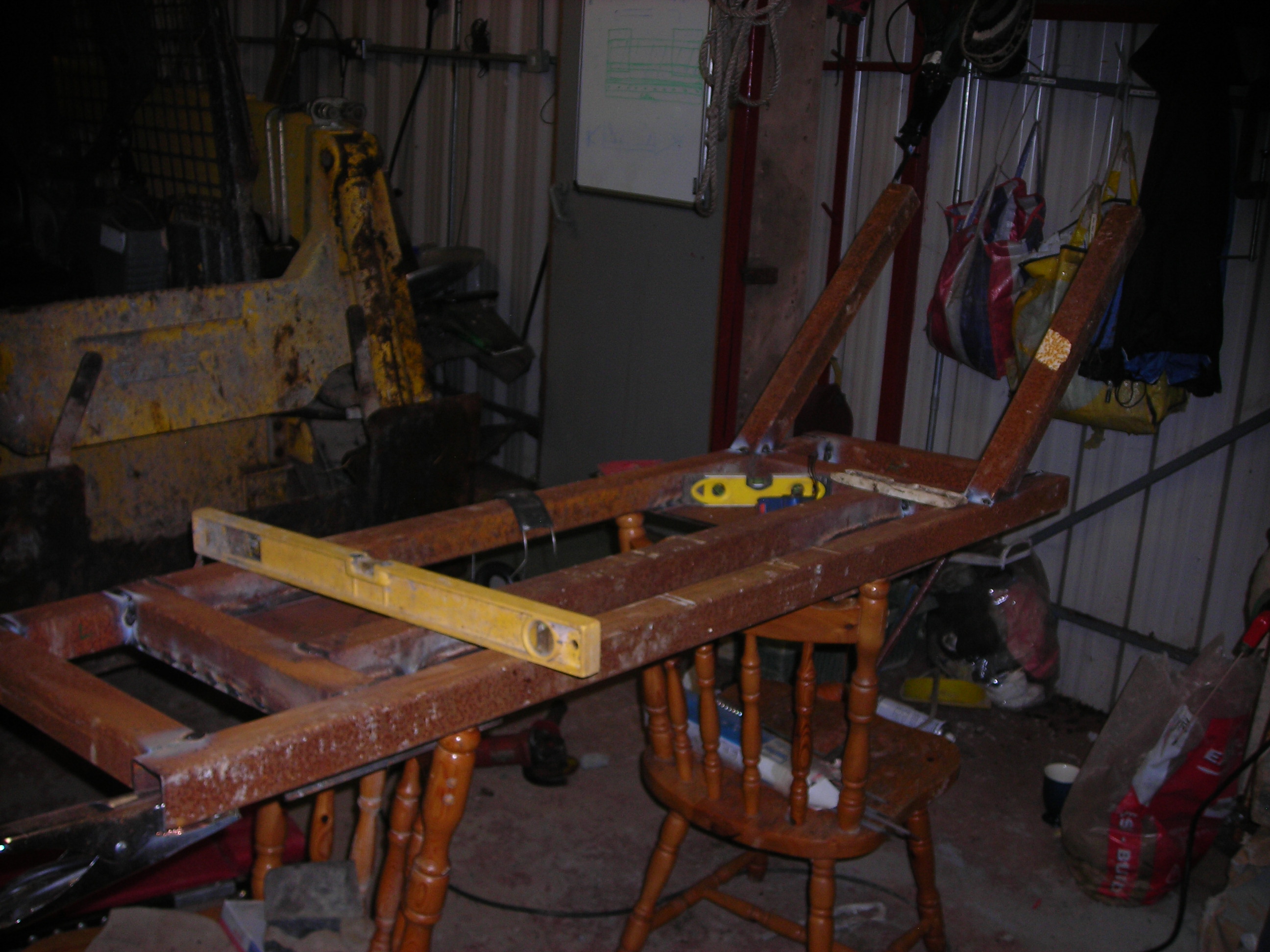

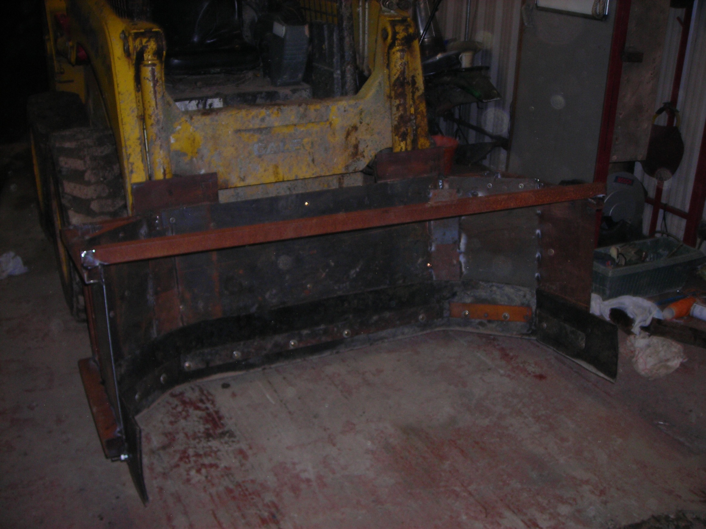

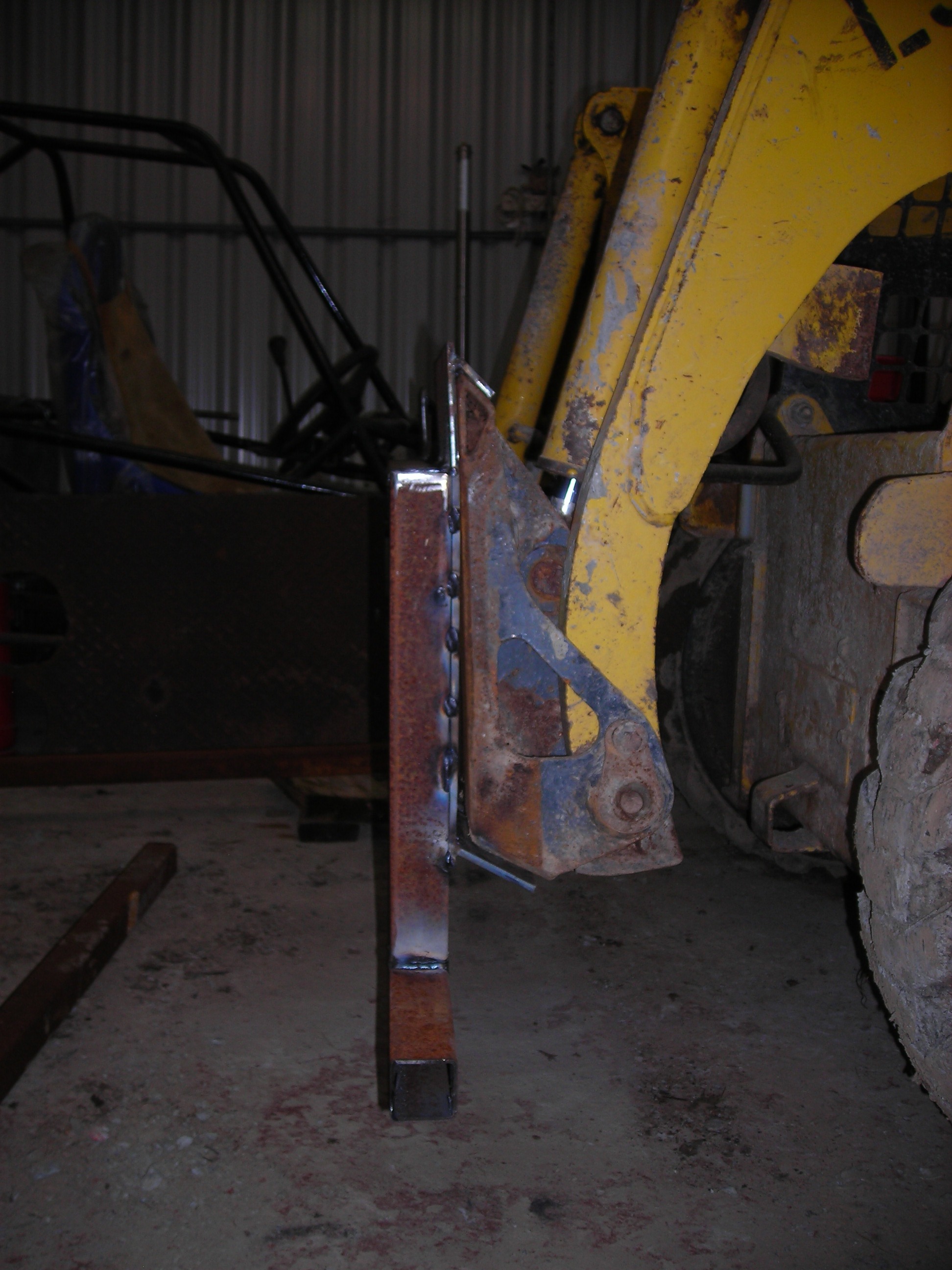

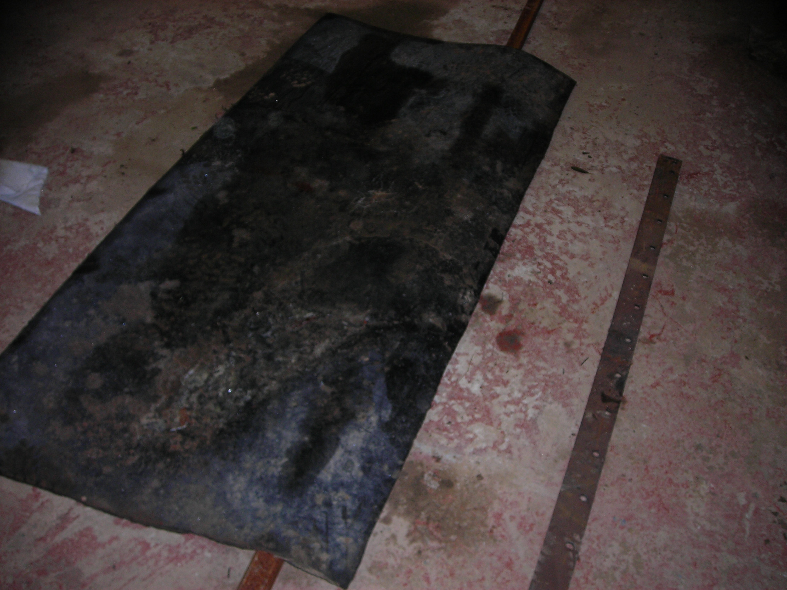

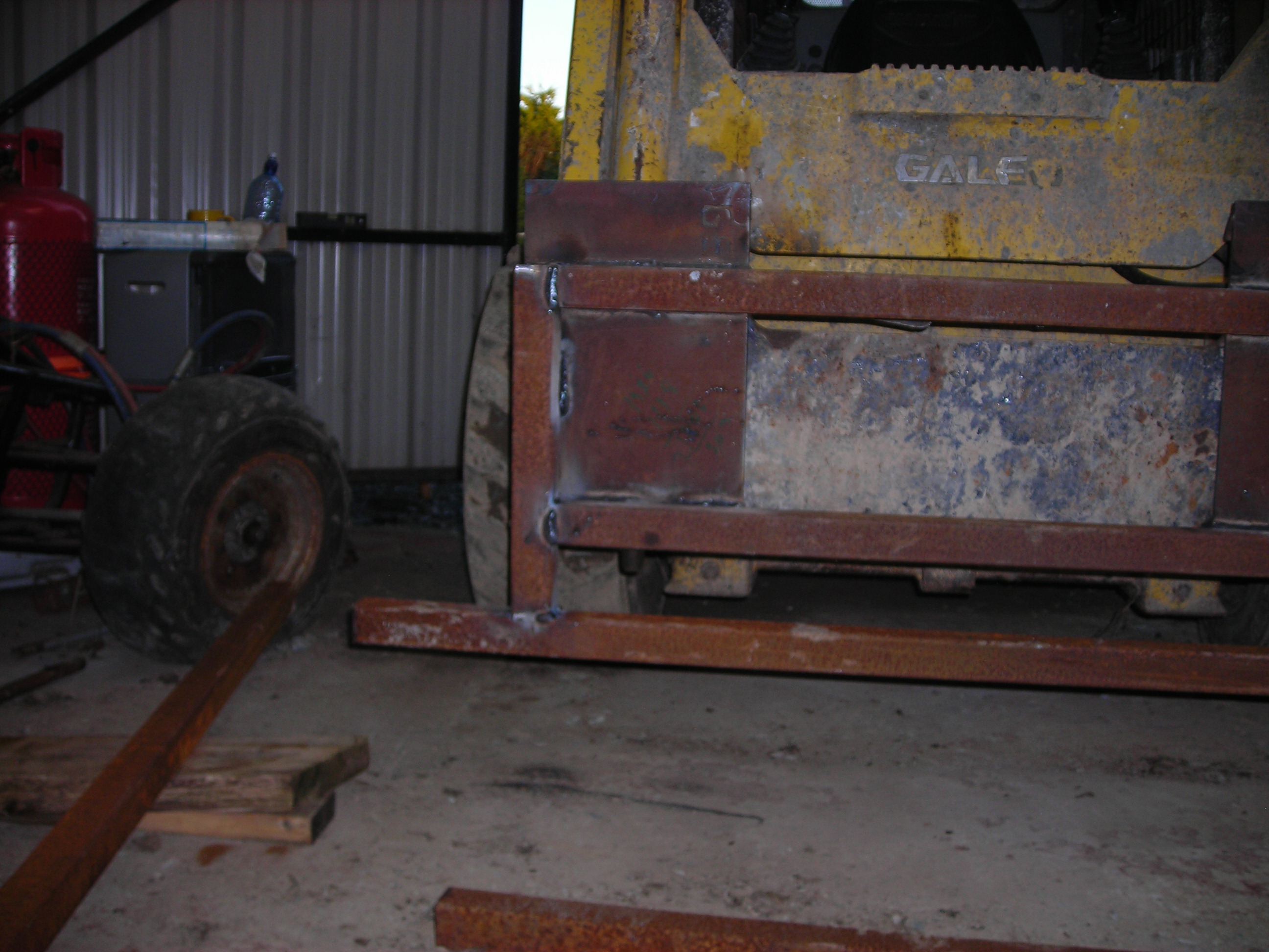

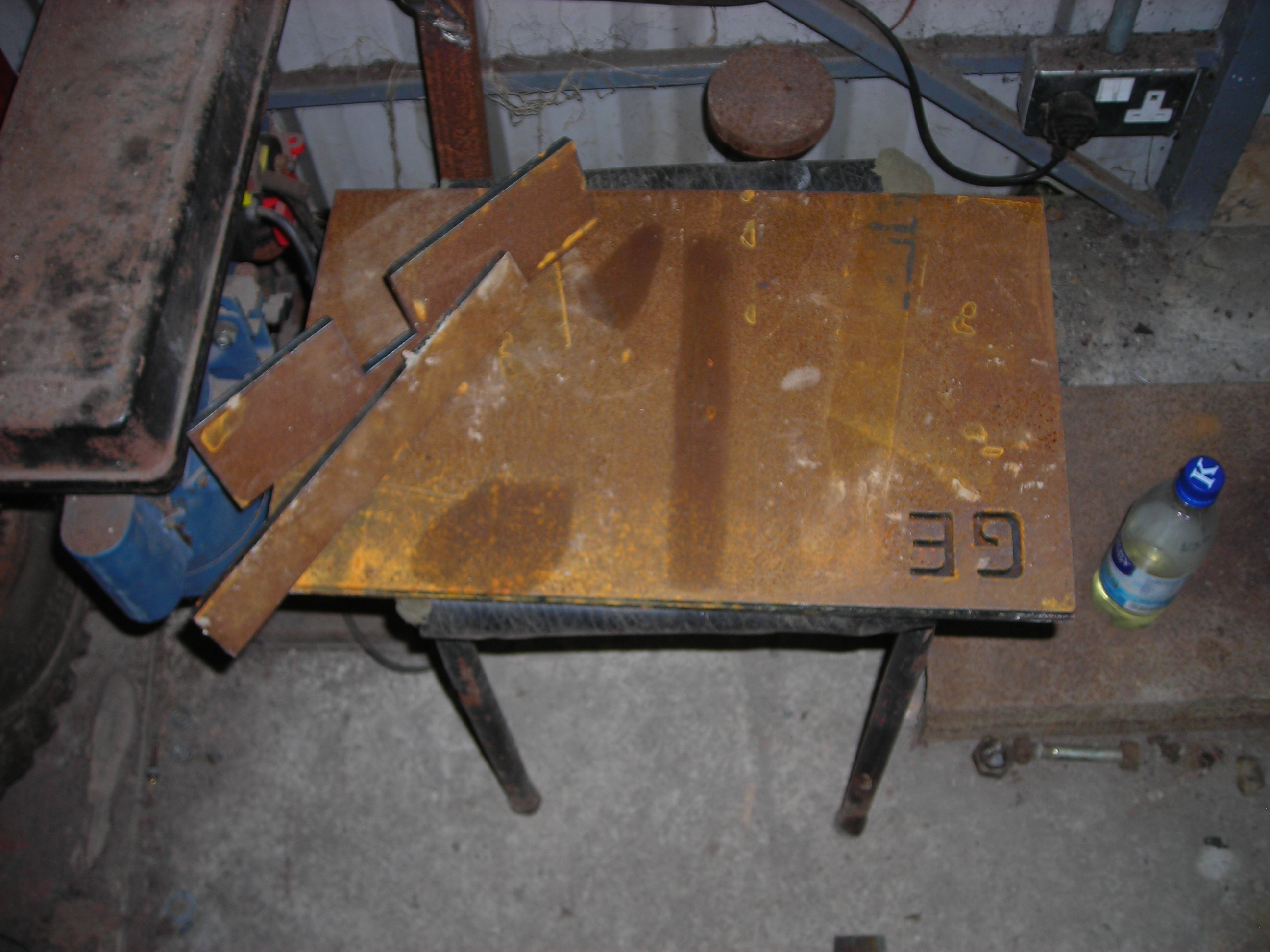

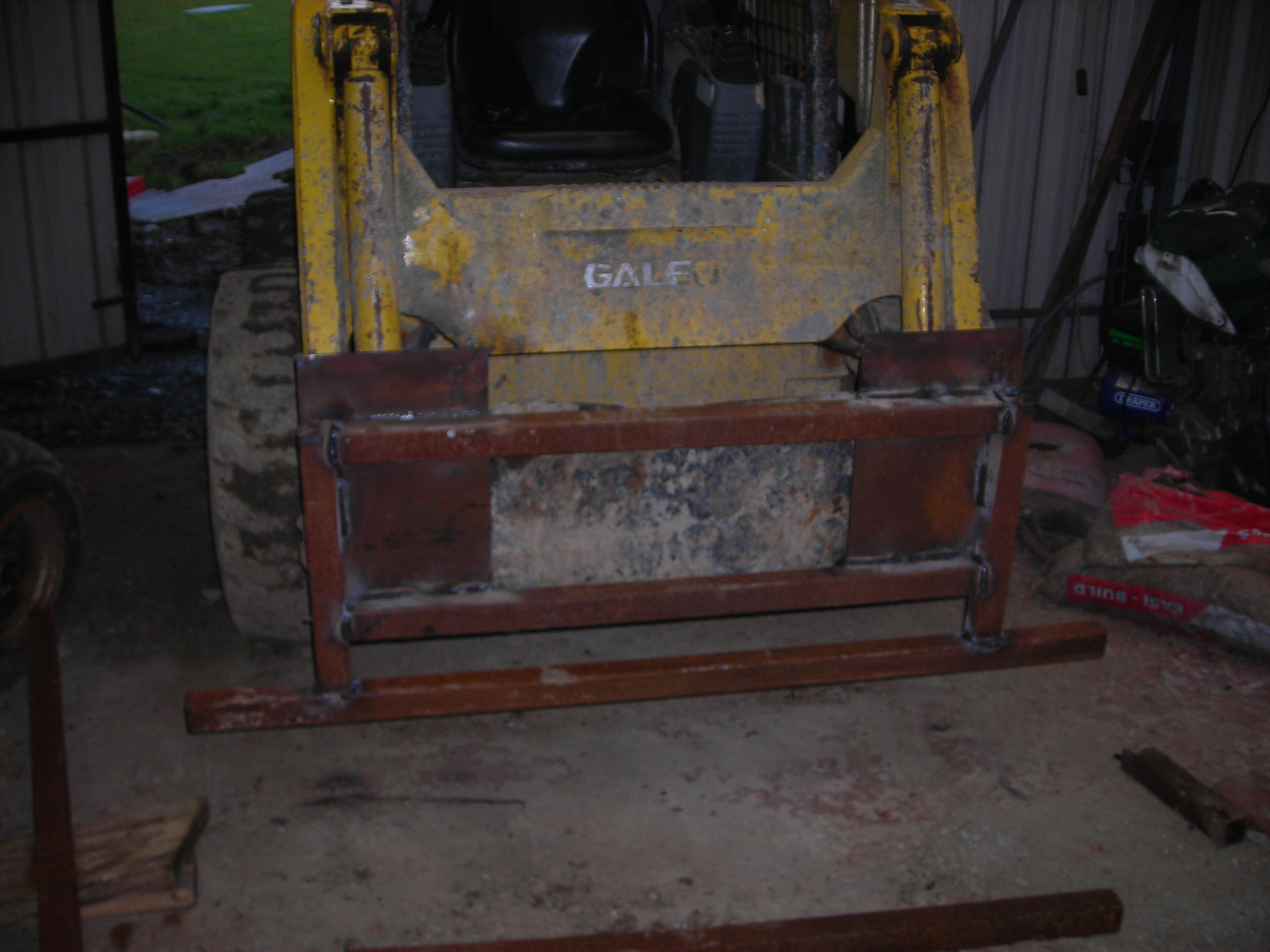

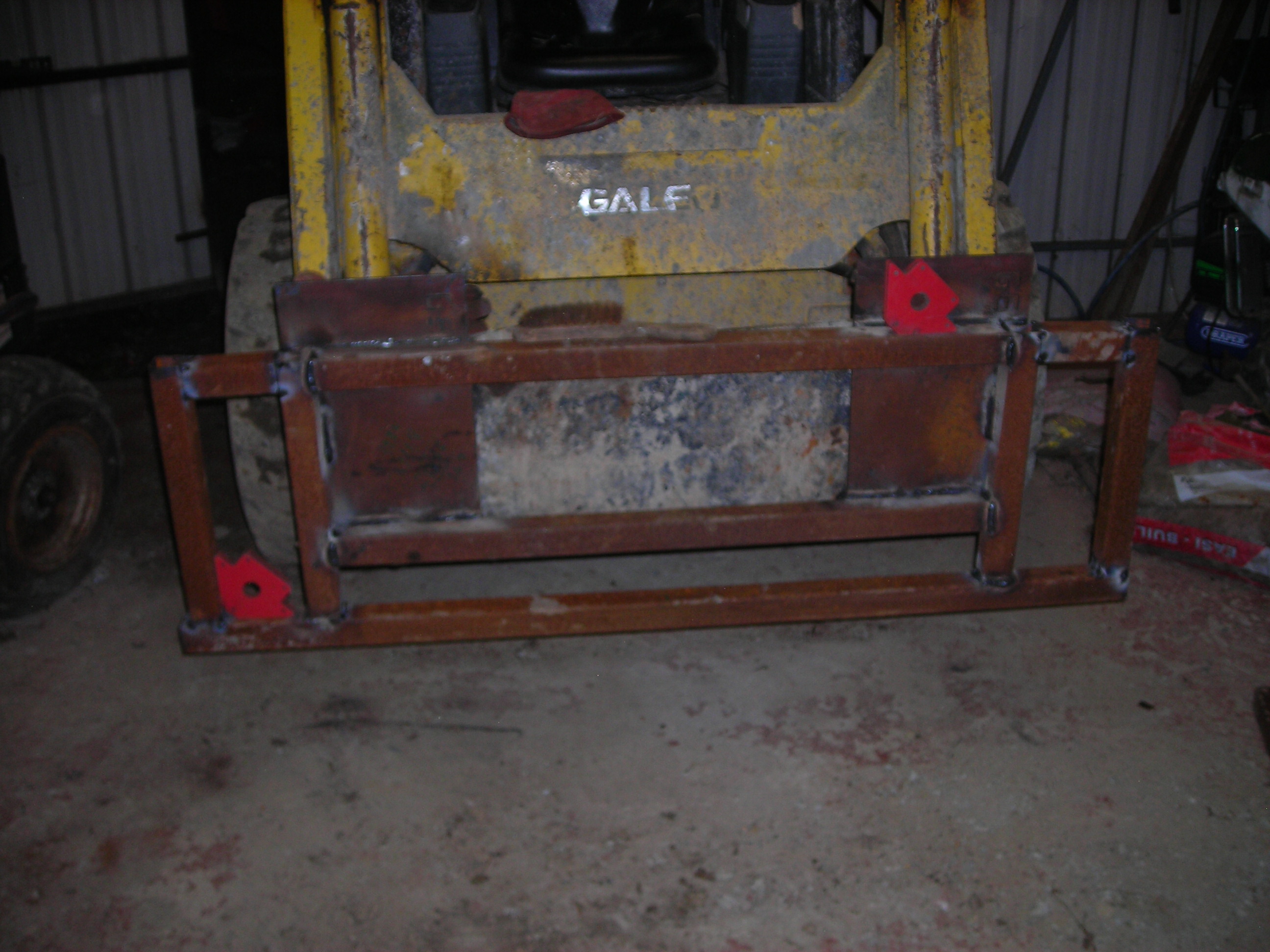

Hi all,
Just finished a scraper for my skid steer to clean the farm yard. Was mostly made of scrap with some plates cut off my brothers CNC plasma. The rubber is off an old conveyor belt. I will put another strip on the horizontal bar on the top of the scraper so that pulling manure back from a wall is possible. Used it this saturday and it worked well except for the places which didnt get the sun and were still frozen. This is the first attachment i have built for it and I have learnt a lot for the next attachment. Need to add some gussets on the lifting hooks to prevent it bending. The back plates warped quite a lot while welding but it still fits well. .
Regards,
Ron

On a more serious note, have you used this to push snow and how well did it work?
