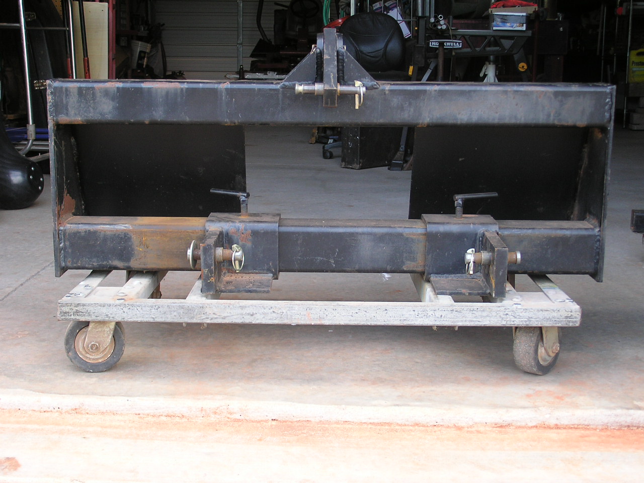

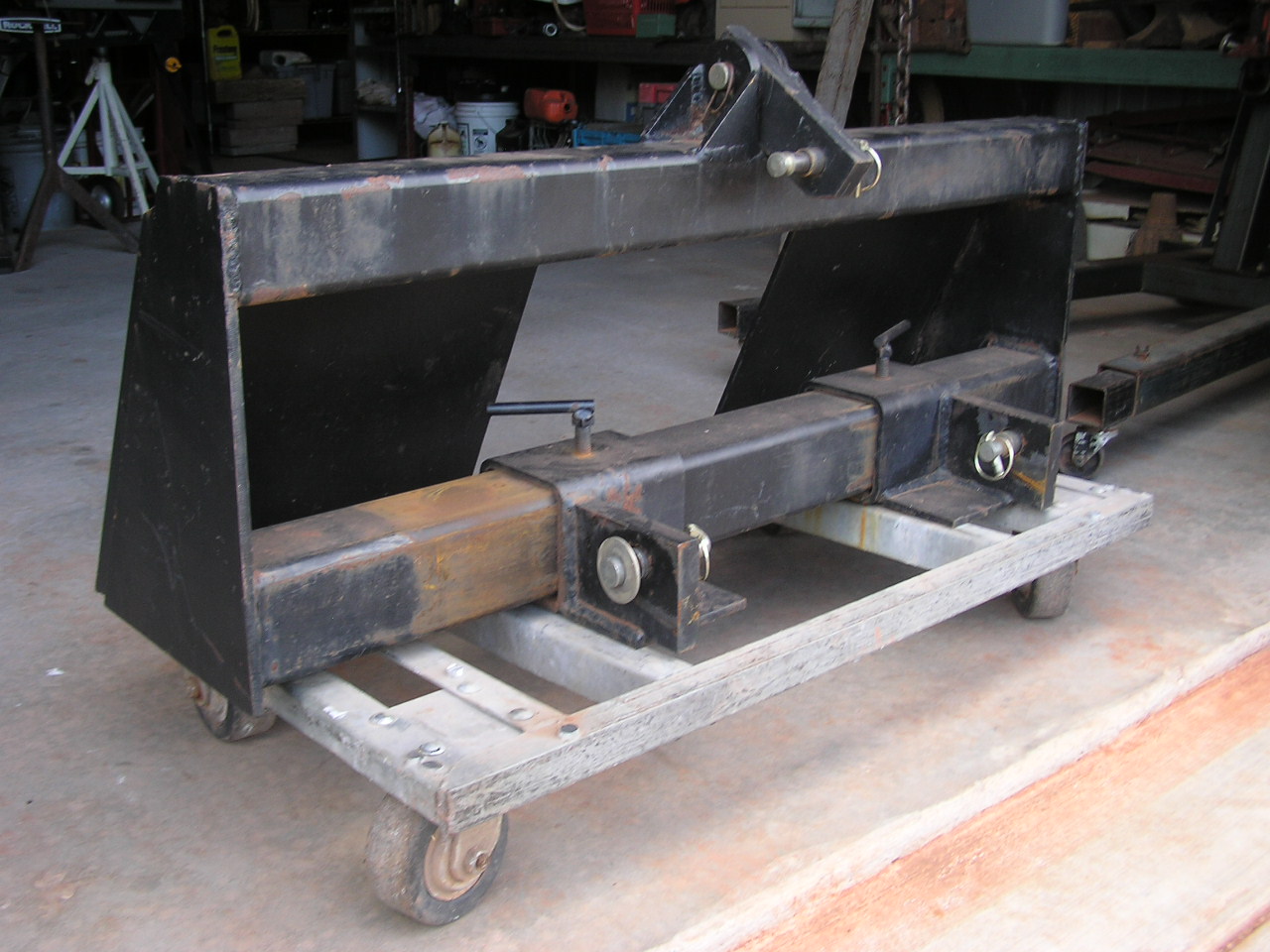

I did just that. SSQA plate, laid a cheap quick hitch on it & started welding. Works great.
Tractor loaders have minimal rollback past vertical, so the SSQA QH really can't be tipped back, but it can be tipped way down. You may want to consider shimming between the SSQA & QH on the bottom only up to about 5". That way it can get some rollback.
Will dig up some pics of mine.

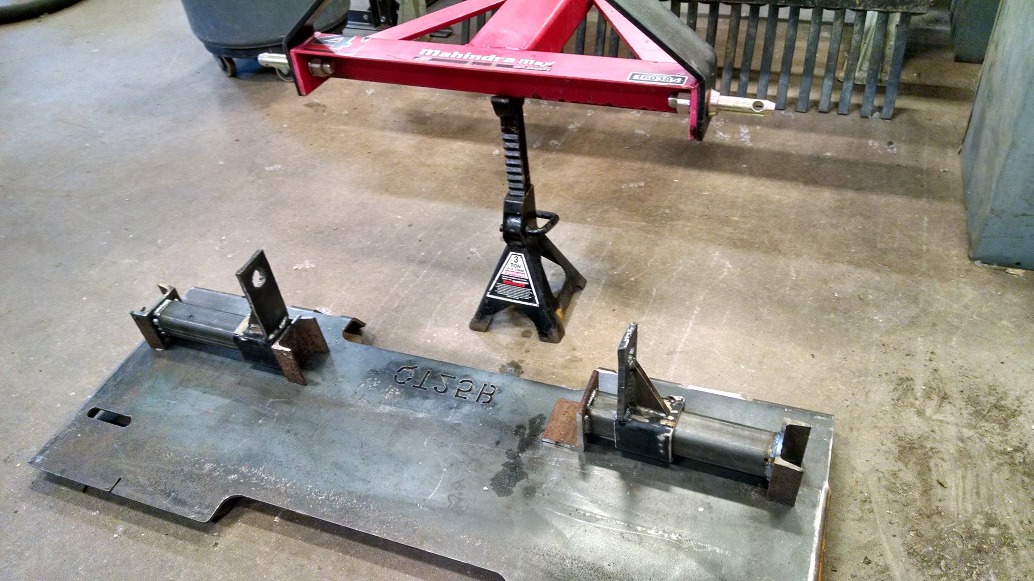

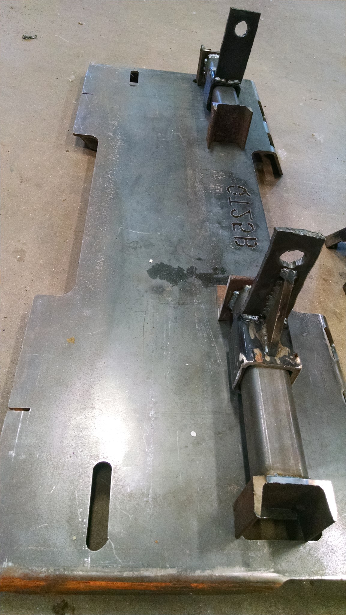

This is what I came up with after a little more research.. I have enough scrap laying around to make adjustable mounts. Now I just have to weld them on... I can make the mounts 21"-33" or I can make them 24"-36". I'm going to have to figure out how big most attachments are because either way this will fit my rake. Should I go with the bigger or smaller dimensions?
/ skid steer plate to three point hitch? #6
Thanks guysView attachment 471320View attachment 471321
I would go with the 24 to 36" range, as that will allow you to use category 1 or 2 hitches with it. The 21" dimension may be too big for category 0, and the 33" will be too small for category 2.

So I guess my next question is... what are mostly cat one implements and what are mostly cat 2 implements? Either way, if I get a cat 2 implement I will probably need to make a second plate anyway.... so since this plate will work either way I weld it up for my cat 1 rake, I'll weld it up to be the most aesthetically pleasing. :eek:)
/ skid steer plate to three point hitch? #8
If you set it up for category 2, you can always use bushings (readily available and cheap) to adapt it to category 1. Just a thought.
I believe implements are categorized by weight and intended tractor horsepower. My 7' tiller and harrow are category 2, where my neighbors are both 5' category 1.

The one that I bought is cat2 with bushings for cat1.
It also has a threaded hole in the sliding bracket, with a bolt, to lock it down:
You could do the same with a drilled hole and weld on a nut. :thumbsup:

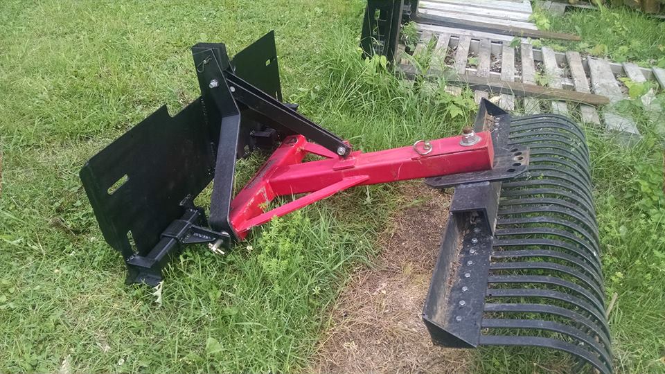

I've got the Titan adapter plate you mentioned and I have used it with my Brillion landscape rake. I spin the rake around (which is what I assume you will do) to drive forward while raking. I've had a few tines snap on mine using it this way. The rake is heavy duty but 30 plus years old and does not have gauge wheels. The loader, even on float is pretty heavy and when the tines have broken they fly backward with pretty scary force. Gauge wheels would probably do the trick but if you don't have them be careful. Nice build by the way.

Good to know about tines breaking... do you mean backwards as in towards the tractor if you are driving forward?
I used mine yesterday. I raked backwards. Works pretty nice!

the final product- works GREAT! :eek:)

Yes I turned the rake completely around in order to drive forward and rake. If you are backing around to rake the tines would spring away from you if they snapped.
