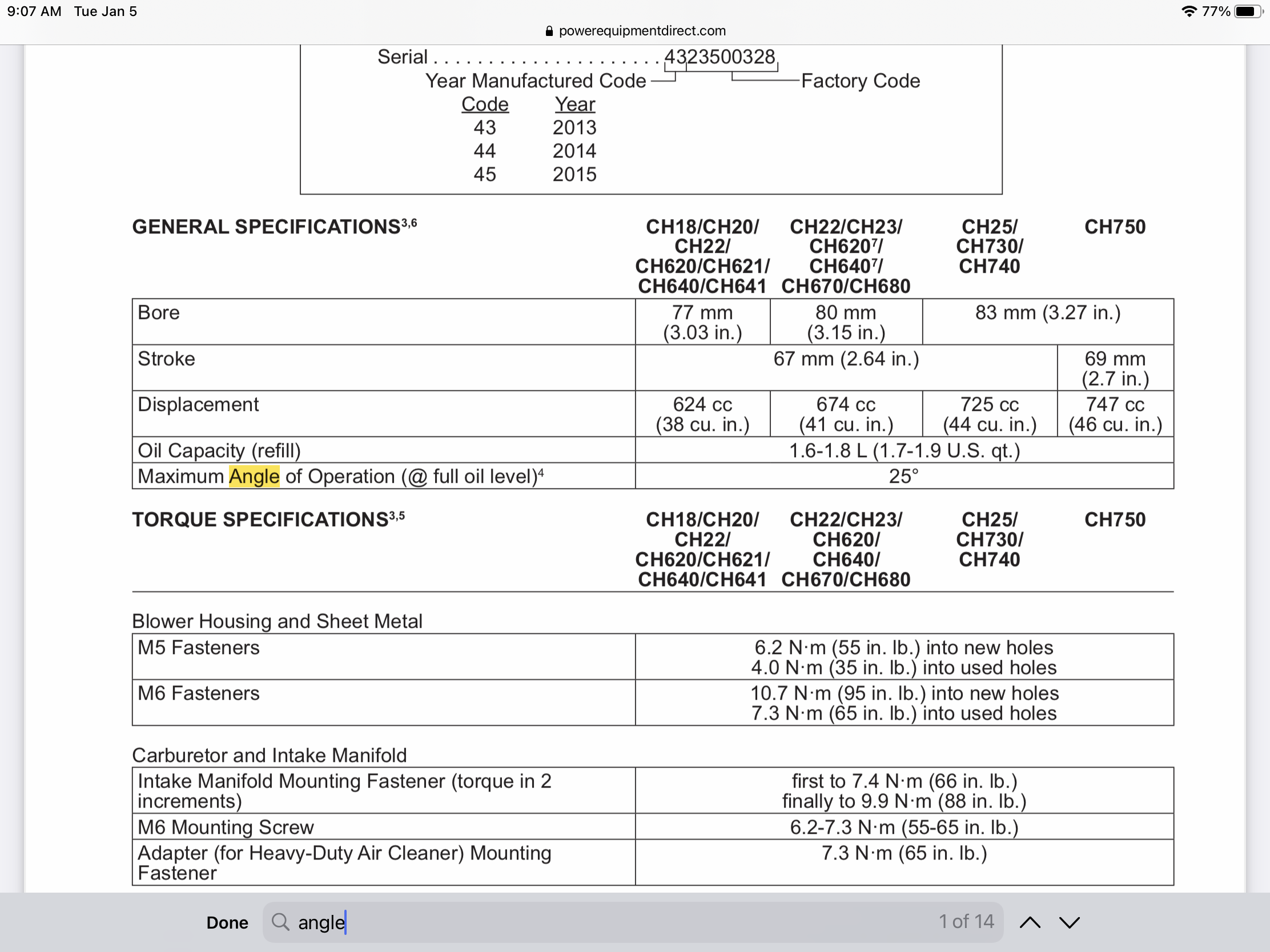

I found that years ago in some Kohler literature related to my Kohler Command Pro CH25. It said something to the effect to not operate the engine for prolonged periods over 25 degrees or oil starvation will occur.

I guess then a more correct statement is that the engine is rated for 25 degrees but not the PT it's self. on the Ventrac rates the Kubota engines 20-30 degrees intermittent and the Kowasaki on the 4500 P 30 degrees continuous now that being said it is tuff to run sideways on a 30 degree slope and cut grass even with the weight transfer on max. It still wants to crab some and it will tear up the grass a little..... jim

The oil pressure issue on severe slopes is why I hooked up the factory supplied low oil pressure switch on my PT180. I used a electronic siren (like some manufacturers use when you get off the seat with the PTO engaged). I have never noticed it come on when using the machine, but it is nice to know I have a way to determine if I lost oil pressure.
This Kohler engine list max angles of cont 20, intermittent 35. http://www.kohlerengines.com/engines/onlinecatalog/pdf/tp_2339_d.pdf
