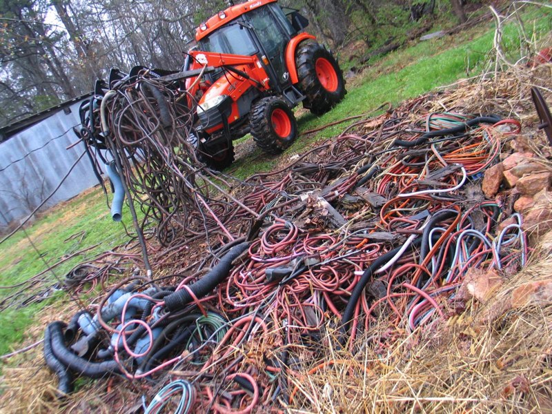

Yes,
I think the weight is an issue. I nearly tipped my DK55 over a couple of times this week loading trash into a dump truck. The combination of not exactly level, high lift to get over the edge, a grapple attachment(more weight) and she almost went over, in fact not sure if it was before or after, it rolled the front tire off the rim.
Here's a pic of my set-up.
On the hydraulic front, I've noticed I either don't have the power or the pump is hot and not working to capacity, but the grapple at some points will not open as I am moving and/or articulating the bucket. Is it possible to go to / retrofit a higher capacity pump? I'd like to get a hydraulic post hole auger.
   / Skid steer implements on a Kioti FEL with quick attach kit? #6
Something is wrong and it is not your pump capacity. It does not take much hydraulic flow to open and close a grapple. I could do it easily with my CK20. Obviously you have either a diverter valve or a third function valve so I would explore whether those are operating properly or blocked in some way rather than looking for a higher capacity pump.
   / Skid steer implements on a Kioti FEL with quick attach kit? #7
Yes,
I would suggest, that if you want to use attachments on the front, you need more weight on the back. If you want more hydraulic power, use one of the PTO pumps below. I have a brother that lives in Hickory, NC, and I used to go their every summer in my younger days.
