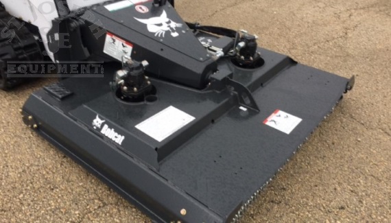

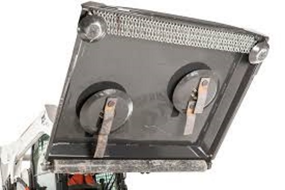

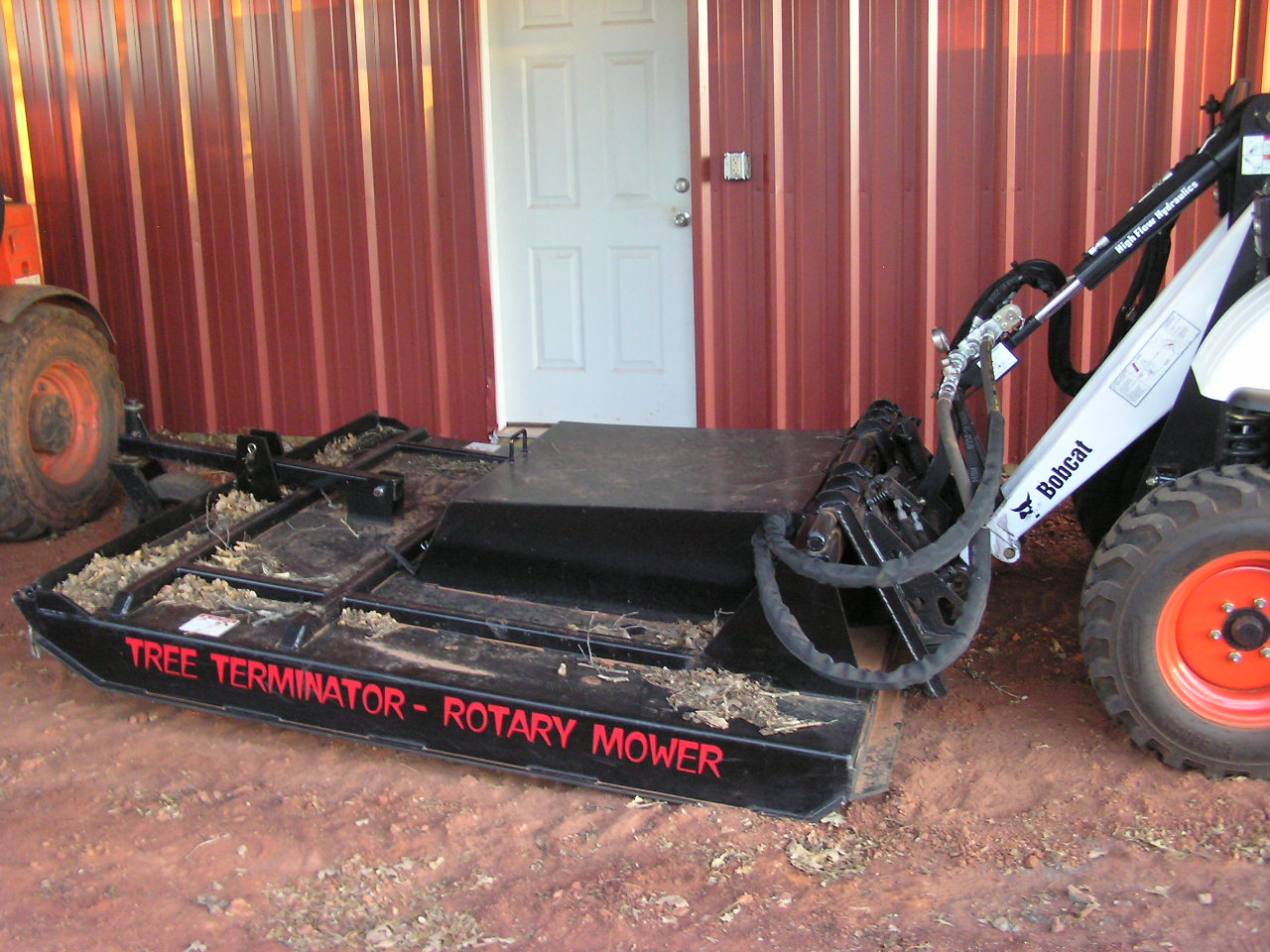

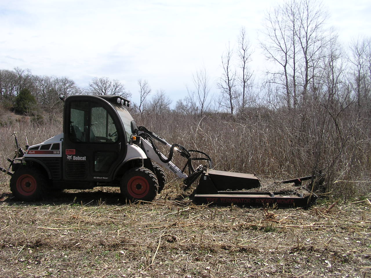

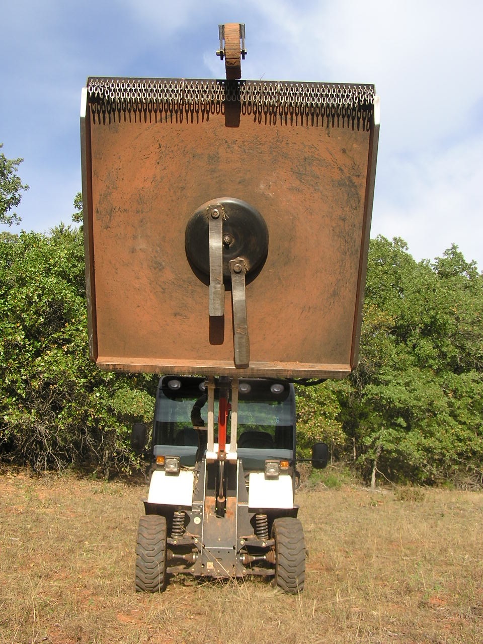

I like this design, the Bobcat Brushcat. No gearboxes:
This 7 foot brush hog was delivered 10-1-2010, so we have been using it for going on 7 years now.
Works well on uneven ground, with the pivot SSQA mount and front wheel carrying half of the weight.
