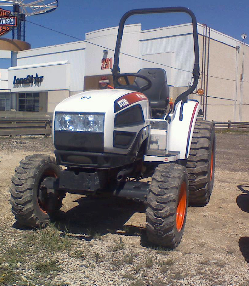

We'll have to see. The salesman, tending to flooding at his homestead, may not be aware that I have opted for the CT235 over the CT225. There is no loader on this unit. I doubt they will want to take it off the 225 so they may order it. Also the 225 had 20 hours on it. I also believe the CT235 is a 2011 model. I don't know if it has any hours on it at all. It smells new under the hood and is also cleaner than the 225, which has a little rust on the grill guard and a scratch or two. Mind you they said they would clean all that up and touch up paint. At this point, I don't mind waiting, I just want them to stick to the other salesman guesstimate that $1500 to $2000 should be all that is involved. Granted this was a conversation about the engine. If he tries to up it, I could promise to buy the 72" Finish Mower as well. I need it anyway, I'll just refrain from springing it on him until I know for sure.:D
attachment.php
   / Skid Steer Backhoe on Tractor #9
attachment.php
So somewhere in between $$$. But it is a 2011 model with 2 hours on it,instead of the 2010 CT225 with 20 hours. They will transfer the Loader with Bob-Tach from the CT225 and the 7TB is the reinforced model coming straight from ND. They will bring it out first. I am probably out of town tomorrow for at least a week, but when I am back! When the Hoe comes, they will come get it,take it to the shop and then return. Gotta love that of Bobcat Manitoba seeing as I am 18 km out of town.:D
