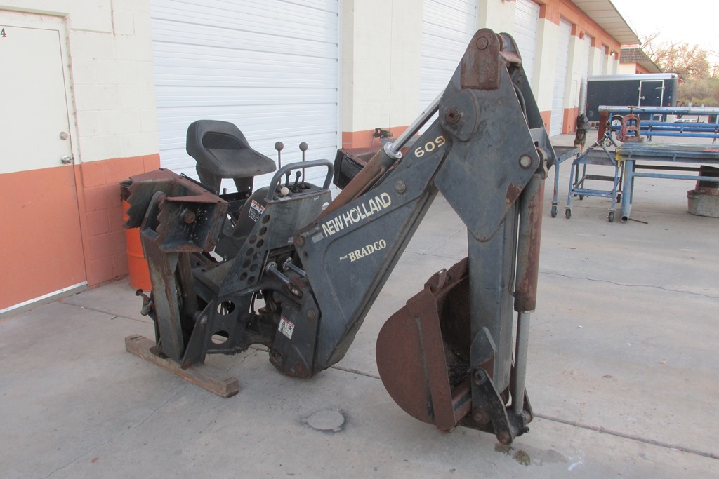

Funny you should mention this... I just bought a Bradco 609 to mount to my MF1455. The 509/609/511/611 backhoes all use the same mount pattern, and the SSQA mount just bolts to the backhoe frame. Actually, the skid mounts attach to more than just the "SSQA" plate... They have arms going to the skid steer in at least two other places.
The great news is that Bradco makes mounting kits to put these backhoes on many popular tractors. I bet they make one for your MX5100. Given the weaknesses of the SSQA setup when pulled on, and the extra attachment points that the skid steer mount uses to overcome this, I think you'd be better off unbolting the skid steer attachment system and making (or buying) a proper subframe mount for your tractor. Bradco's mount kits are 4pt, and do not require removal of the 3pt hitch, at least for the applications I've looked at. The 4pt system looks like it would be fairly easy to hook up.

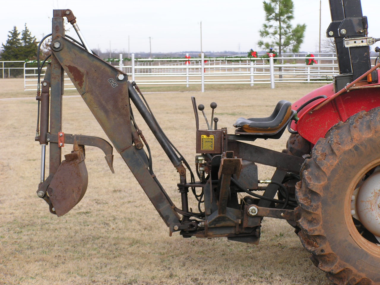

Unfortunately, I'll have to build my own mounting kit, as they don't offer one for my older tractor. I'm not scared... I have pictures of several now for similar tractors, and I can figure out the rest. Bradco's customer service is excellent, btw. :)
I got my Backhoe from Florida for $2500 shipped to NM. The place I got it from bought several from a municipality, and they all need some TLC... I got the "best" one, which has pitting on only one cylinder. But it needs a seat, some hoses, lots of WD40, and eventually paint. It also has a 24" bucket, which I'll probably cut down to 16" to work better in hard ground.
As you've seen, if you have some time to watch, you should be able to get a nice backhoe for less than $3500.
I just received the hydraulic hoses I need to plumb the tractor for Power Beyond, and I'll be starting the subframe project as soon as my trailer is done. Should be just after Thanksgiving. :)

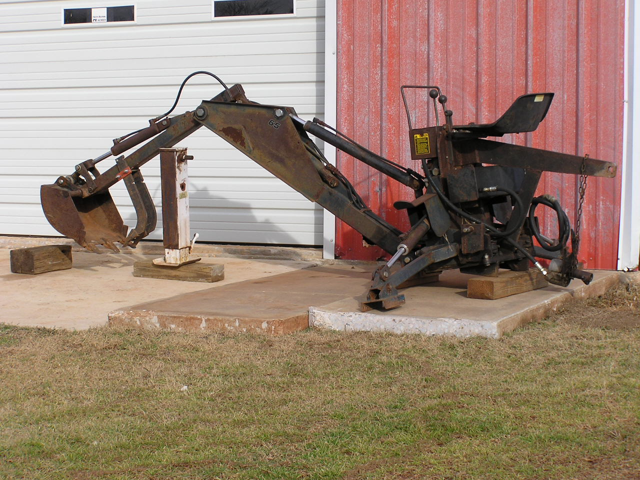

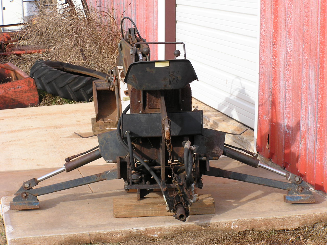

Bought this at an auction many years ago. It had been converted from sub-frame mount to 3 point.
It had a PTO pump and reservoir on it. The top link frame was 3/4 inch thick

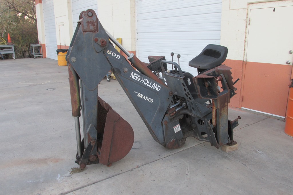

From what I can see on mine, it all unbolts. Four bolts per side and the SSQA junk falls off and you're left with the backhoe, which will accept any of Bradco's tractor mounts, or 3pt hitch conversion kit. I don't think you can go wrong... BTW, the prices in that link I posted seem to be in the ballpark. I was quoted the backhoe side of one of the MF mounts at almost exactly the price listed...
dfkrug, I was planning to put the backhoe just far enough back to fit the seat... Seems like the closer to the tractor I can mount the BH, the better for many reasons...
