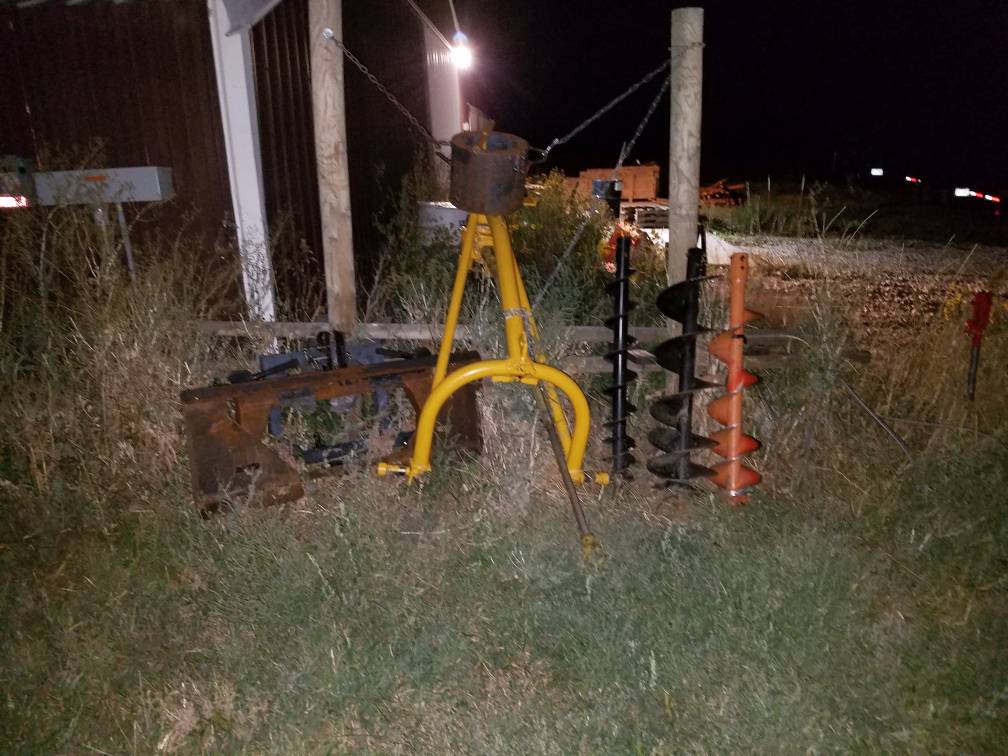

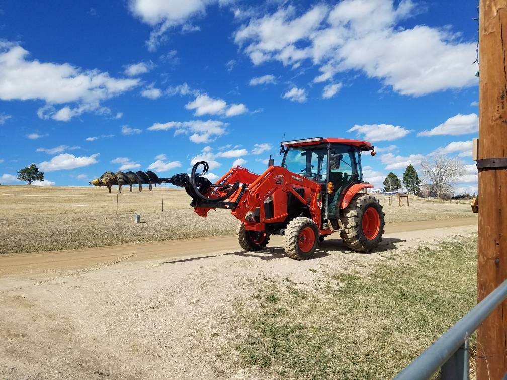

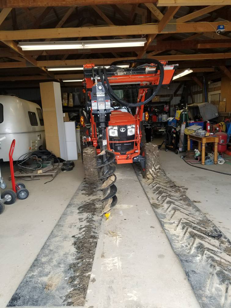

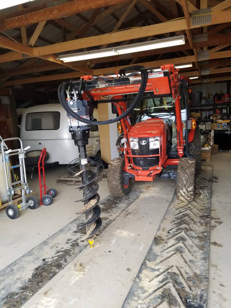

I have a Danhuser hydraulic auger for my L4060 & it works decent. It's slow & less power than a PTO 3pt, but is superior functionality that makes up for it. It's the one for 10gpm on their site & they have a chart for model to gpm. I got the 2" hex drive instead of the 2.5"ish one. Not sure if one is really any stronger than the other but both are noticably stronger than the 2" round drive PTO augers use.
I even rebuilt my old 3pt PHD to fit on a 3pt QH. It only worked with TnT & had lots of limitations, but had downpressure for the first foot or so. I strapped 200lbs of scrap steel over the gearbox too.
Get the offset SSQA mount. It makes it so much easier to see rather than being hidden behind the hood or killing your neck for a 3pt mounted one.
Downpressure & reverse is nice. Raising or lowering the loader stops the auger from spinning, which is annoying, but not actually that problematic.
Just match the gpm on your tractor to the right PHD motor size. 20170402_145306-1.jpeg20170401_133255-1.jpeg20170401_133249-1.jpegDSC06433.JPGDSC06434.JPG20160828_220700.jpeg
