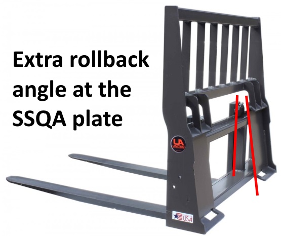

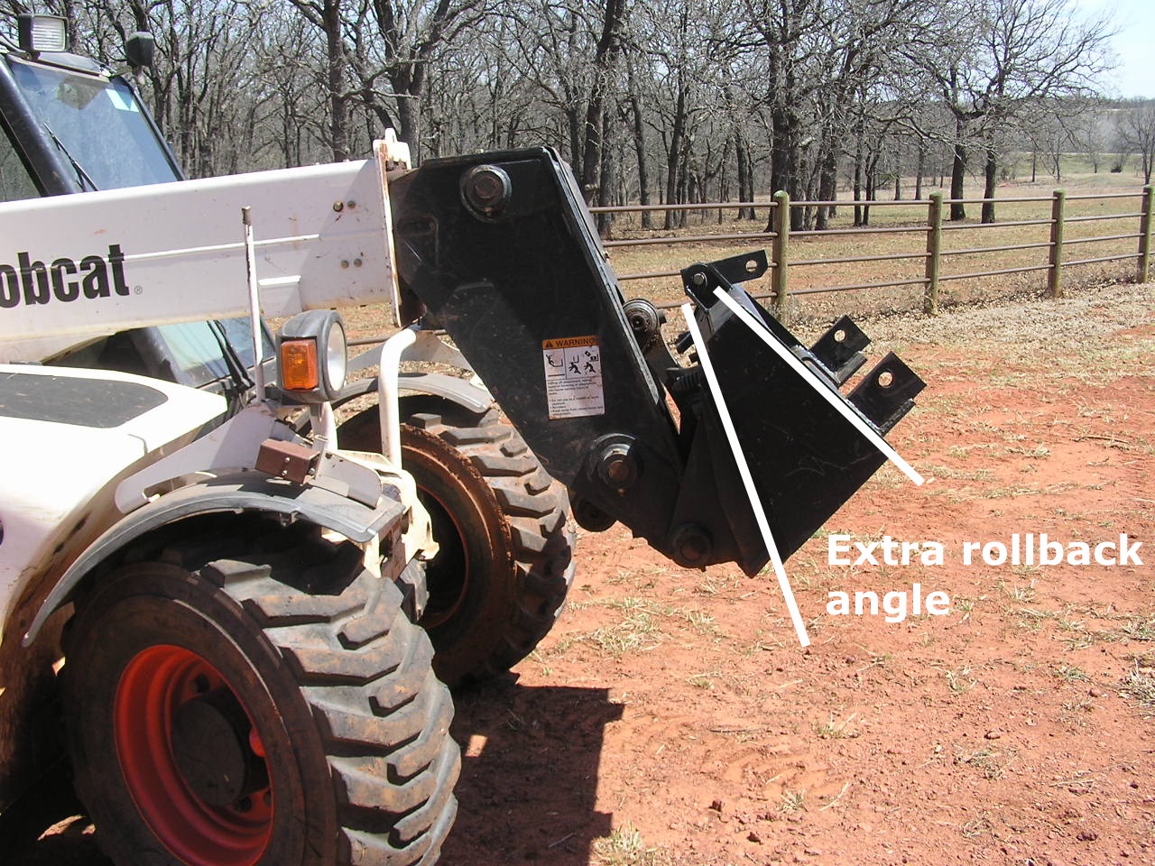

There is no standard angle that I know of, but have read a lot of posts wishing for more on forks. You might want more than this:
You can customize it for your equipment.

I sure wished my ssqa to 3pt adaptor had some extra rollback built into it as it is just straight.
