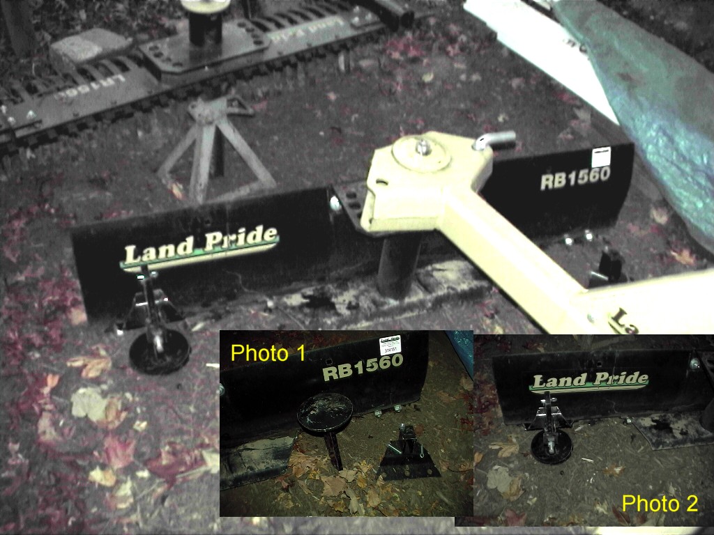

I haven't contributed in a while so I thought, as I was prepping the rear blade for it's skid shoe installation, that I'd take some photos. There were posts in the past about the best way to plow with a rear blade depending on driveway materials, etc.. Since I have block, stone and asphalt driveways I believe these skid shoes to be useful. They are sort of like gauge wheels on a rake. My LP rake is in the photo too and you can see how it interchanges with the rear blade. Just remove a cotter pin and nut and swap. BTW, the part number for the skid shoes are the same regardless of which size LP rear blade you are using. Photos 1 & 2 are just close ups of the hardware. Sorry, you'll have to scroll to see them.

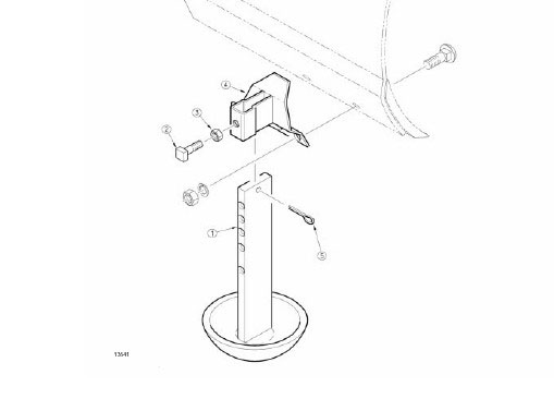

Here's the Landpride drawing in case the photos missed the mark.
