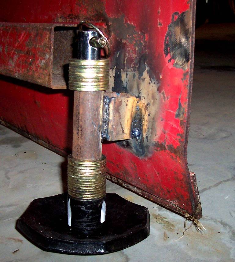

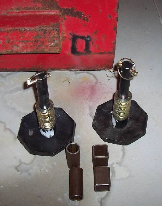

I've enjoyed reading other people's endeavors on making skid shoes, and have gotten some good insights. A guy at work suggested purchasing skid shoes for a pickup snowplow (Western snow plow replacement shoes were the cheapest) and welding some square stock and round stock to the plow. I did this over Christmas break, and it turned out well. Two replacement shoes (including washers and hitch pins) cost $34 (since then I've found them for $28). The square stock and round stock cost $7. The only trouble now is waiting for the snow to fall!

Attached is the pictures of the skid shoes for the rear blade after they were attached.

I found the place locally but you can mail order them from anywhere, the place is Angelo's in Wixom, Michigan. The link is Western snow shoes W49067 I think shipping and handling will run around $10 depending on where you live. I would just call around where you live and ask for the Western 49067 skid shoes. I've found that there are many different manufactuers for the replacement shoes, some are much thicker than others. Northern Tool sells them for $16 the link is: Northern tool
I don't understand why some other snow plow brands cost 2 to 5 times more than the Western shoes. I do know that there are different thicknesses you can get, the standard duty (which is what I got) and a heavy duty. Depending on how heavy your plow is, I would doubt you would ever need to replace them unless you use them as much as a professional.
By the way, I used the square stock to keep the shoes from being under the plow, otherwise I would only be able to lower the plow to within 1 1/4" of the ground. The guy at work says he keeps his 1/2" off the ground and it works fine.
