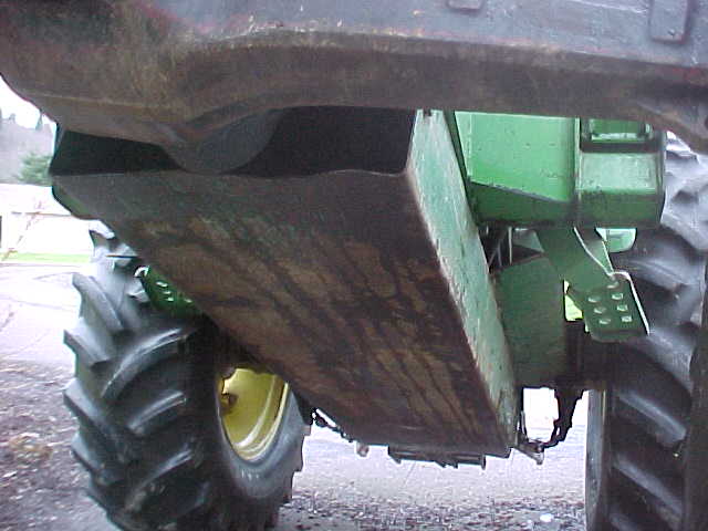

I built this for my JD. It hinges at the front, and is held up in the back by the rear hitch. Notice to the rear where I have flanges to the sides. They protect the brake, hydraulic lines and wiring. Have fun with it.
