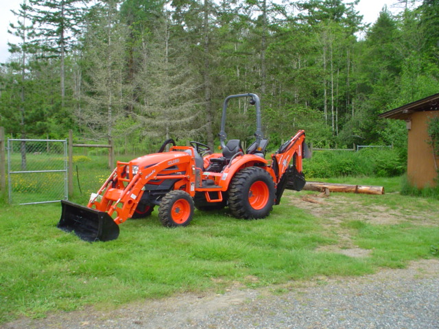

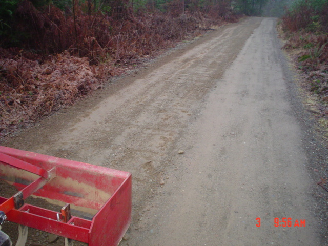

I have a CK35 HST. Bought a used 6 ft box blade that works fairly well. If I had to do it over I would get a 5 ft which would cover the width of the tires
The CK35 does not seem to have a problem using the 6 ft but I have to watch it doesn't get to full of gravel. Having said that I normally grade in two wheel drive.
