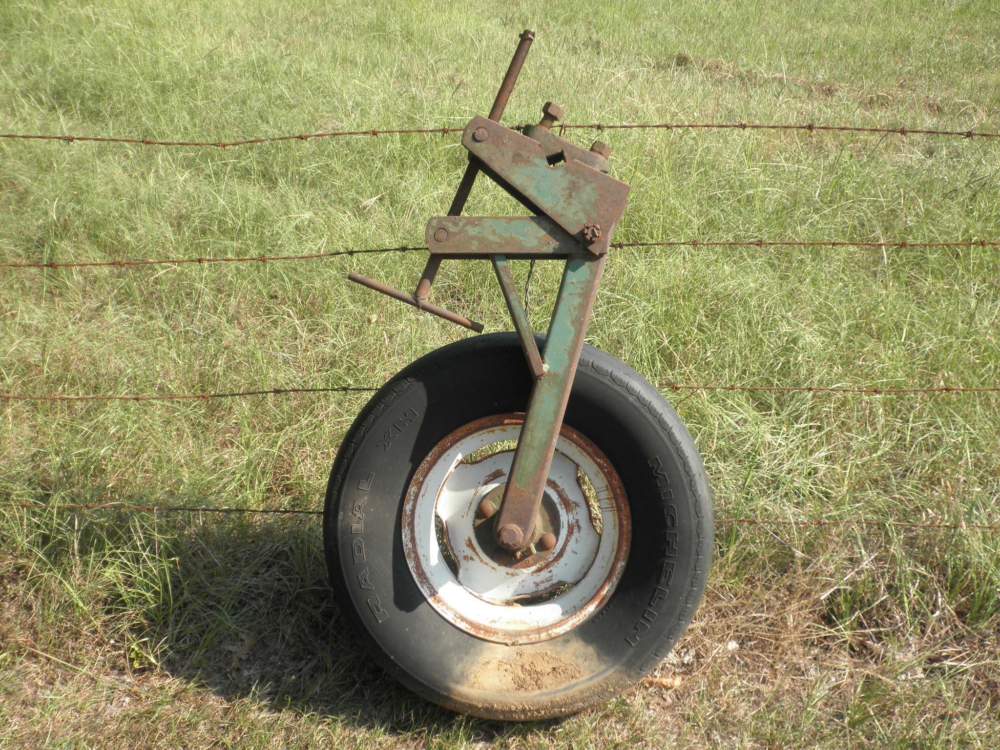

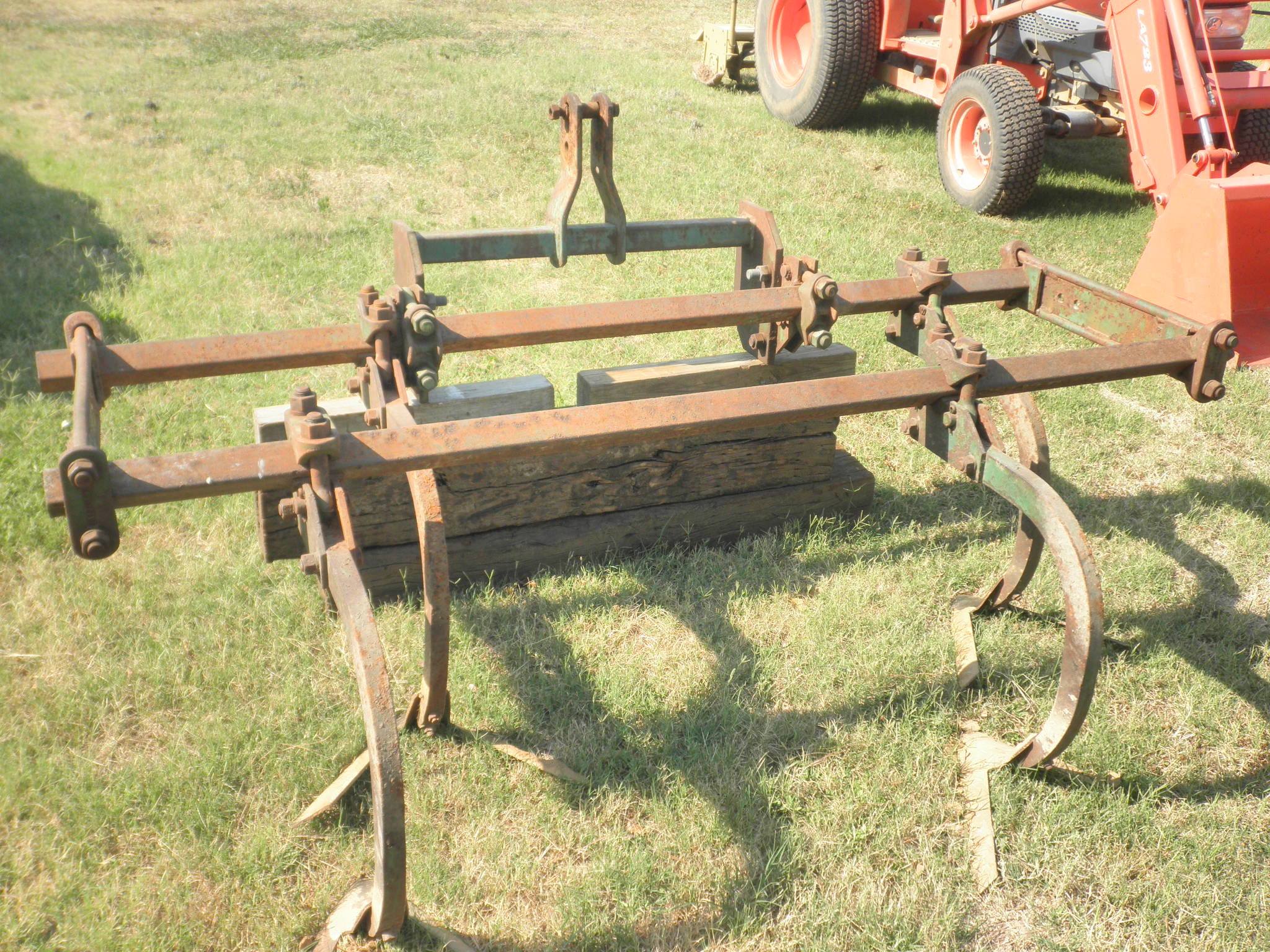

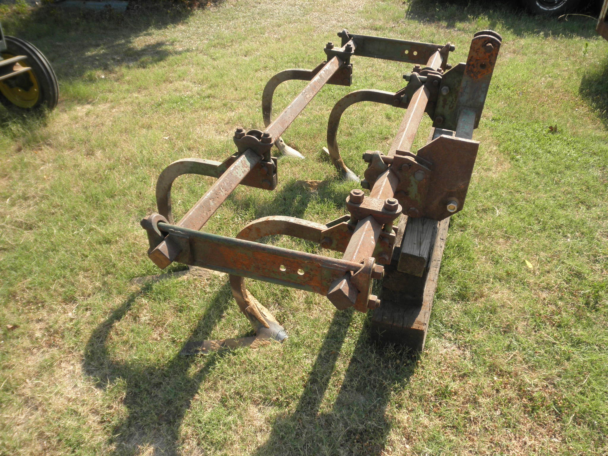

Bought a large used cat II field cultivator 14 feet wide, double 2 1/4 inch diamond tool bar with ties and large 15 inch screw-adjustable gauge wheels. I cut one bar in half (two pieces 7 ft long) put them together with two of the four ties to make a tool to fit my cat I JD 850 (ca 25 hp). I like the way the tool works and the four shanks are easily adjusted left and right on the bars. These shanks are tall and that gives good clearance of the crop but it also means that it doesn't have a lot of ground-clearance when lifted and traveling from place to place but it is adequate if I don't forget to ensure that it is lifted all the way. It is a heavy beast for my tractor but I don't have to add any more weight to make it bite:laughing:. It tends to make the front end want to come up if I lift it too quickly:(.
The shanks are very heavy duty and by changing points or blades I can use it as a ripper (have to determine how many shanks my machine will pull) or subsoiler. To do that I will almost certainly need some gauge wheels to control the depth since my tractor cannot handle much depth all at once and I would probably need to make more than one pass in the same slot.
The problem is that the gauge wheels are massive for my machine and the spindles of the wheels are very worn. Do you think I could cut off those spindles and weld on new ones for smaller wheels? I am not sure that there is room for this large gauge wheel to run behind the tractor in the tractor wheel track followed by a cultivator shank (e.g. when cultivating; but wouldn't need a shank behind the wheel when ripping with one or two rippers).
OR-- would it be a better choice to get a straight vertical shank gauge wheel of smaller diameter with flotation tire? This would lighten the load since the tool is already very heavy.

you need to use 5 shanks. put three on the back and two on the front even spaced. then put the guage wheel directly under the center link and in front of the middle shank in the back. if this pulls to hard then cut off some of each plow.be sure to get them even spaced or it will pull right or left.

Thanks for your thoughts. I only have four shanks but I do have two of the gauge wheels. I also have to be able to straddle one row of my crop of flowers planted on a raised bed (about 4-6 inches high) with sloped sides.
So, I think I would need to have a gauge wheel on each side of the row and at least one cultivator shank running behind the gauge wheel to remove the compressed tire tracks of the tractor and gauge wheel.
I am sure that this application is not what the attachment was made for so I am trying to make it work for me if possible.
For the gauge wheel I have I think I need to mount at least one of them and see how it fits where I was describing above. May need some fab work to make it work.
I played around with the tool as I have it configured and used it in some fallow ground and it worked havoc on the weeds and grasses trying to establish themselves there.
I still have another 14 foot tool bar and two more ties so I could cut this bar in half and add on a third bar for attachment of more shanks in a better arrangement if . . .
