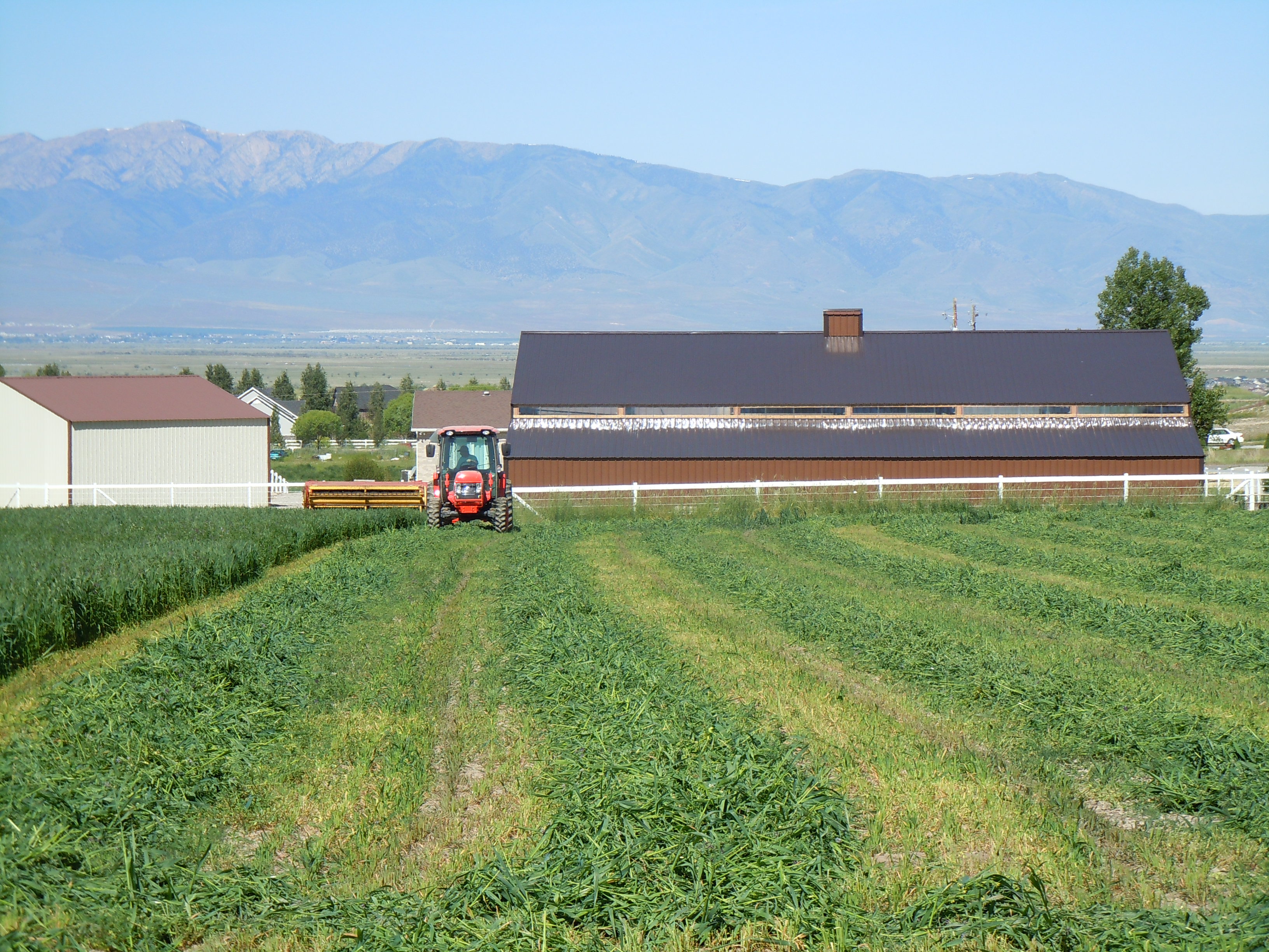

The owner of RMT (Brent) has a place in Woodland, on the bench north of the highway. They sell New Holland and Kioti. To me it seemed like I was getting more tractor for the money with the Kioti. They were really good to work with. No pressure at all. Brent also grows hay so I'm sure he can point you in the right direction.

I have 80 acres, a mile long driveway and big Ponderosa pines rather than hay. My first tractor was a 28 hp, 4WD Ford which was OK for winter snow removal. This tractor was not big enough for summer driveway maintenance, running a big chipper, moving large rock and could not lift/move sections of my big pine. I finally got a Kubota M6040 and now these "larger" jobs can be accomplished easily.
I recently got a grapple which is far and away the most useful implement I have. My hydraulic top link is great for its easy & infinite adjustment of all ground engagement implements.
