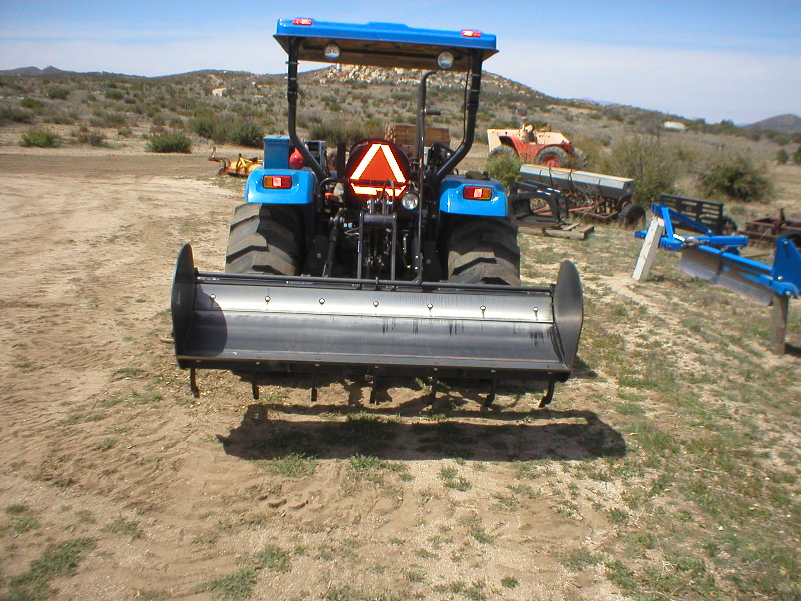

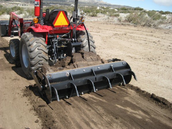

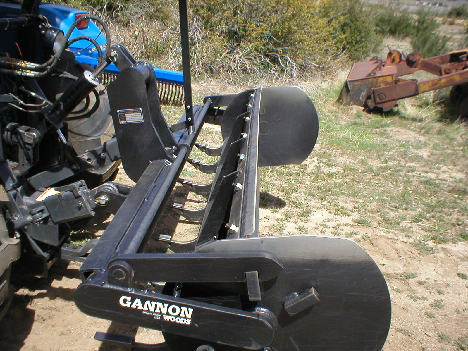

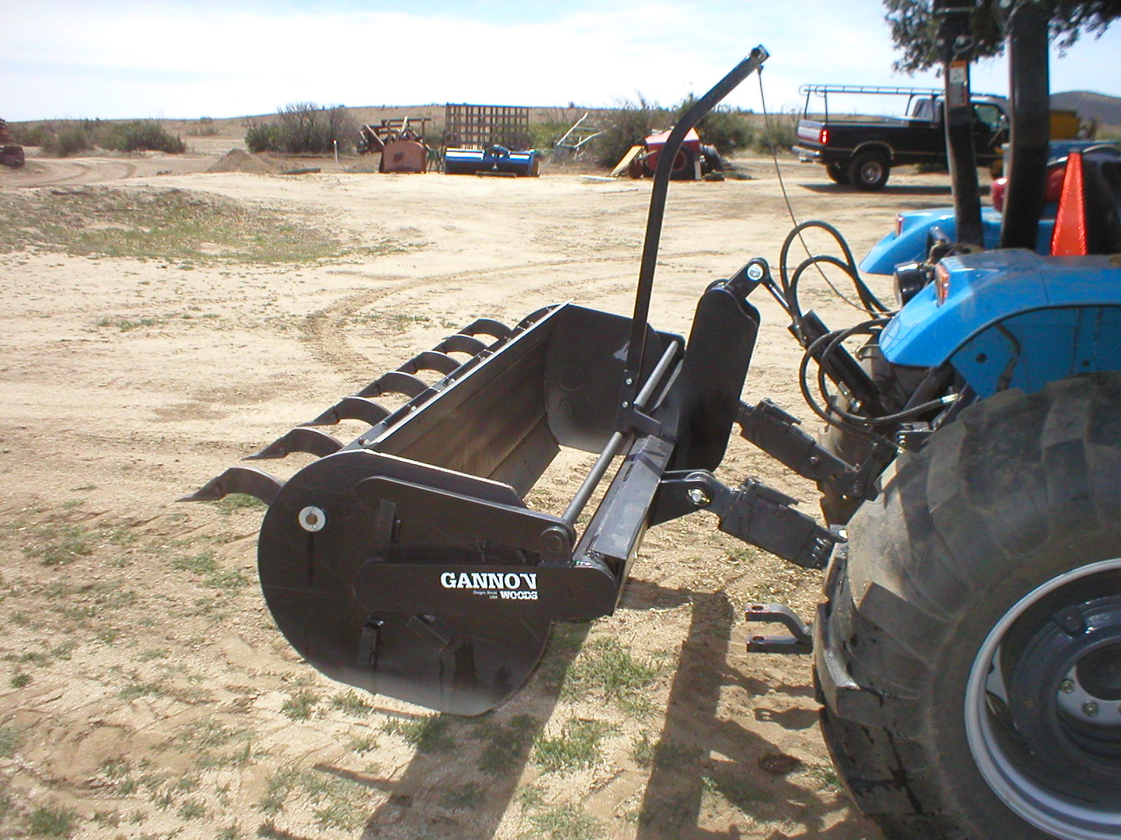

This is what I consider the perfect bob blade for your tractor. Bush Hog has some also. Just not quite as heavy.
These ROBB (roll over box blade) work very well and are about the next best units there are next the industrial grade box blades with the hydraulic actuated rippers which are the units that have replaced the ROBB as the commercially used box blades.
I happen to have Gannon units which sadly are no longer built. :( But these units are fairly tough and have held up well for me. I have a 65" unit and an 81" unit that I run behind my 5000lb 32hp & 12,000lb 75hp tractors.
Just remember, you typically get what you pay for when purchasing new implements. ;)
