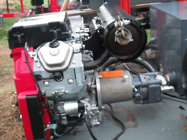

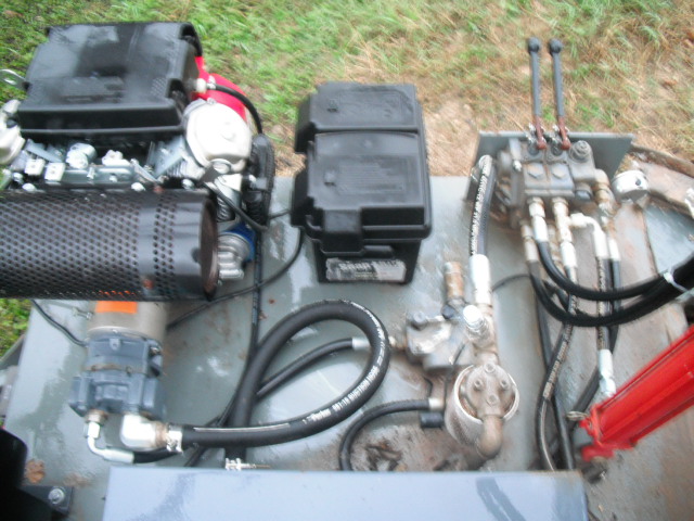

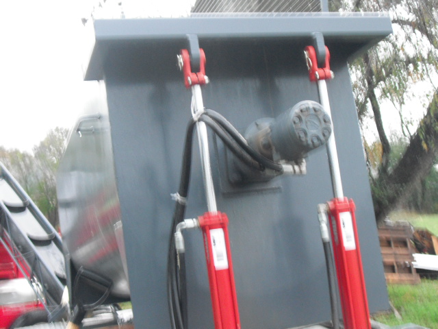

I believe I致e addressed your questions. With the pics you might get a better idea of what I知 working with.
In the first you can see the motor, side of the tank, lift cylinders and in the back the conveyor.
In the second you see the current Engine pump
In the third you see the layout of the hydraulics.
