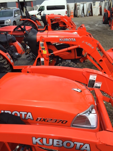

I've been thinking of going a little larger too, and have been asking the same question about size comparison between the B01 and B50 series machines. I think I've posted this already, but here is a pic of a BX2370, B2620, and a B3350 in a row. Maybe not the best angle to show the size difference between then, but my impression is that the B20 looks closer in size to the BX than and the B50 is bigger. The hood height on the B50 series is almost chest height (I'm 6'). It has very large rear tires and sits very tall, which makes it seem big, but I have not driven either around. Hope it helps.
