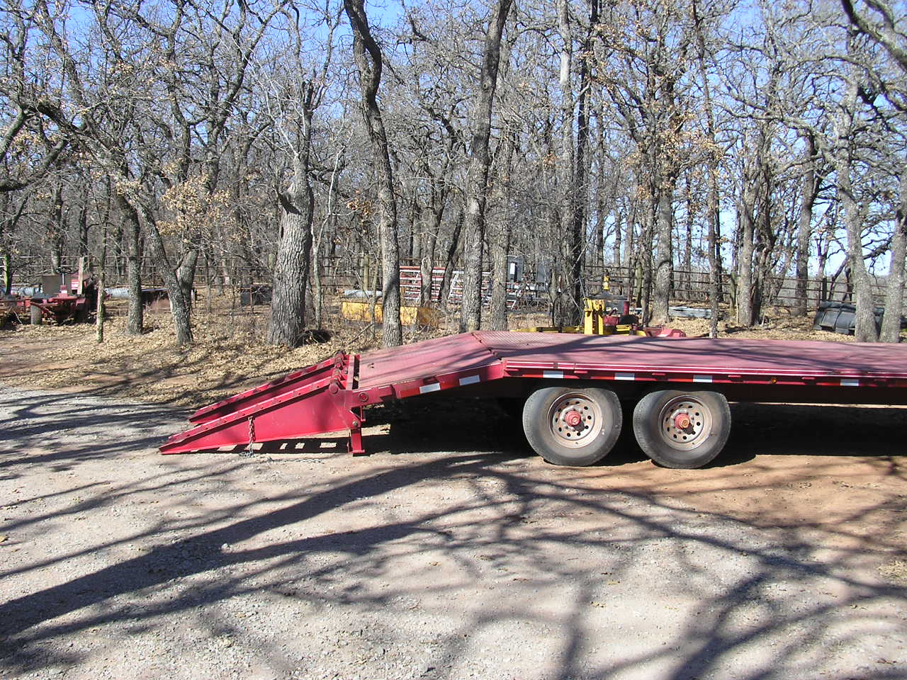

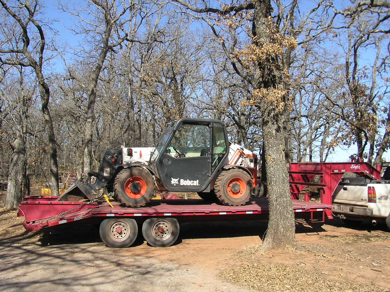

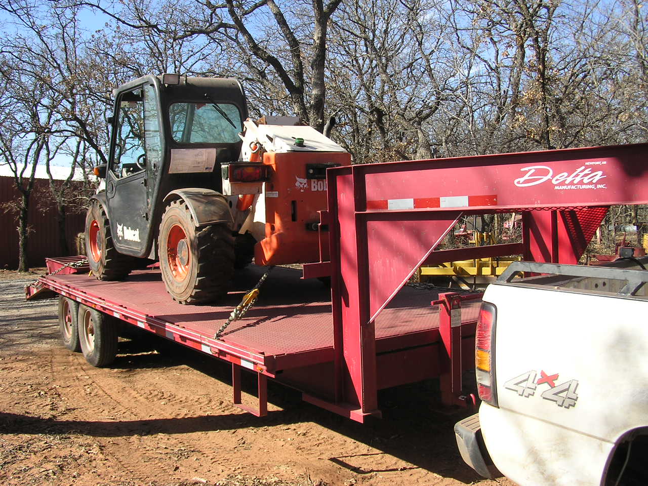

I have a 14K with a single jack, would not want dual jacks. Have had it for 8 years and have loaded the V417 many times without the trailer hooked on the truck. I can do it safely because of the supports built on the ramps and 4WD not pushing against the ramps, trying to slide the trailer.
Here is one from the day I got it, showing the 4' Pop Up Dovetail in the up position.
Used it this way to haul square bales, the ramps provide a backstop.
   / single vs. dual jacks on a 22-25 ft 14k deckover bp/tag trailer #6
The design of that ramp support is different than mine (or most I have seen). So I can understand now how you can load when unhooked.
With just the fixed leg on the ramp, and BEHIND the tail of the trailer, when the weight is between the support on the ramp and the axles, if the weight is great enough, can still lift the tongue. EVEN with the 1-ton truck still attached. (ask me how I know).
Also, with the fixed support like is common, there is clearance between the support and ground to be able to put the ramps up and down. It isnt until there is a little weight on the ramps that the supports touch.
Not an ideal set-up, but when loading my 5000# tractor on the 24k trailer it is fine. When loading a 18000# piece of equipment, I have jackstands that go under the tail of the trailer.
