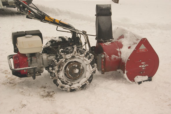

If you are flush with cash, there might be one more option to get more traction!!! I vote for the metal one!!!
   / Single plough attachment
Ha, yes just seen them a minute ago.
Would be great, but importing them to Australia won't be cheap.
Pretty sure i could get close to making something like these though, a good winter project maybe.
