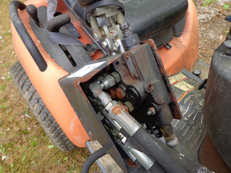

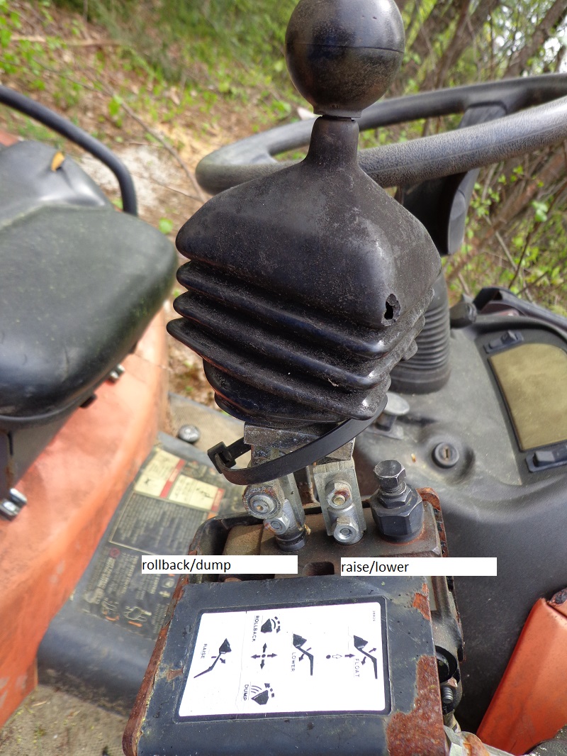

Sorry for the delay in getting back to you. Here's a photo of the joystick(what is it really called?). With the tractor off, I can move the joystick left and right (rollback/dump). It will not move up or down at all (raise/lower). It is stuck. I also attached a photo of valve assembly. The parts list of the fel is attached, but the valve assembly doesn't look the same as what I have. I'm a total hydraulics noobie but have worked on small engines.
   / Simplicity Legacy Front End Loader does not lift #6
Have you removed the lever from the valve and pushed or pulled the spool?
Your only other option is to remove the spool and check for obstruction.
I would remove the cans on the bottom first ans see what is normal.
On the raise and lower, you will have centering springs, and a detent for the float if you have float. Check for broken springs, rust, loose nut, etc.
If you remove all parts from the spool, you can remove the spool to check for debris.
If you think you are not capable, remove the valve and take it to a hyd shop for inspection and repair.

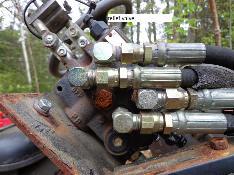

Ok, I'm ready to take this apart. I need to release the pressure. Do I just unscrew the bolt at the top of the relief valve?

   / Simplicity Legacy Front End Loader does not lift #8
Loosen the IN hose on the valve, loosen the cyl hoses.
If the cyl are up, they will come down,so be careful.
So, do you have a breakdown of the valve in case something goes wrong?
When removing the float assembly, watch out for the little balls and springs.
#9
It's a Duke Model 1627. I have a parts diagram. I should get to it this week. Thanks for all the tips.
