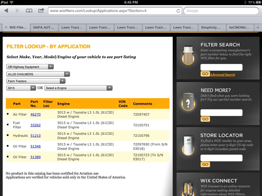

Simplicity 9518
I am having a hard time try to get the a set of filters for a Simplicity 9518. I know this is older compact tractor. I have went to the dealer that the tractor came from and which is an agco parts dealer. We tried to compare the allis 5015 model # that is also listed on the tag and to I think a 1020 MF for the filters. Well I started to service this tractor and filters that were purchased are not the same that came off. I was hoping that someone may have some numbers that I could use to get the right ones or know where I get find this part numbers at
The sold me these
O/F #72101498
HD/F # 72100796
Fuel # 3608255M1
   / Simplicity 9518 Filters #'s #3
HEre are the wix filter numbers.
