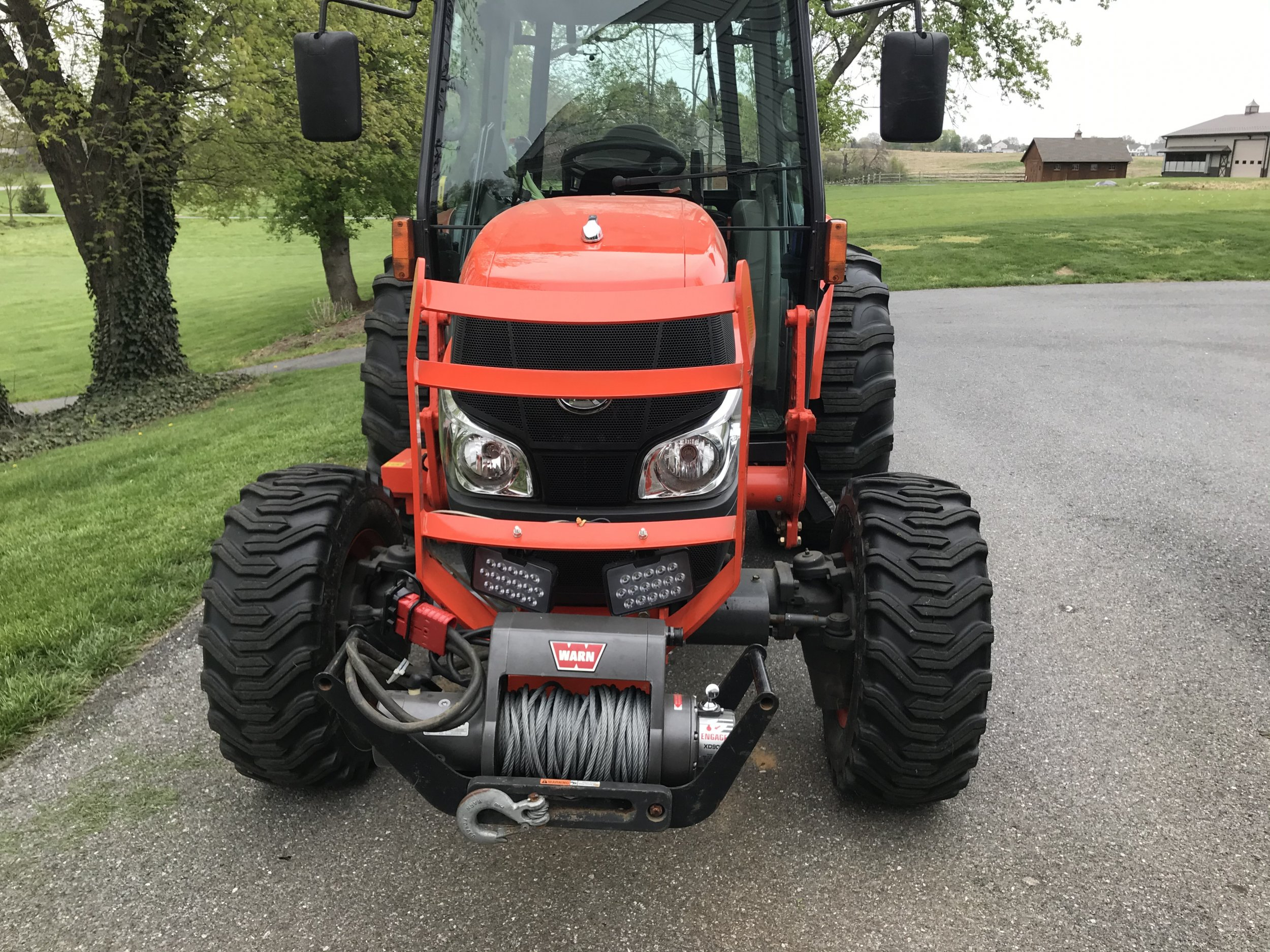

At work we bought a used bucket truck that came with a Warn XD9000i with a cradle mount. It's in nice shape, but the prez said to pull it off. The winch sat on a cart in the Tool Shop for over a year, and I asked three times what plans there may be for it. The third time the prez said "Just take the friggin thing". OK

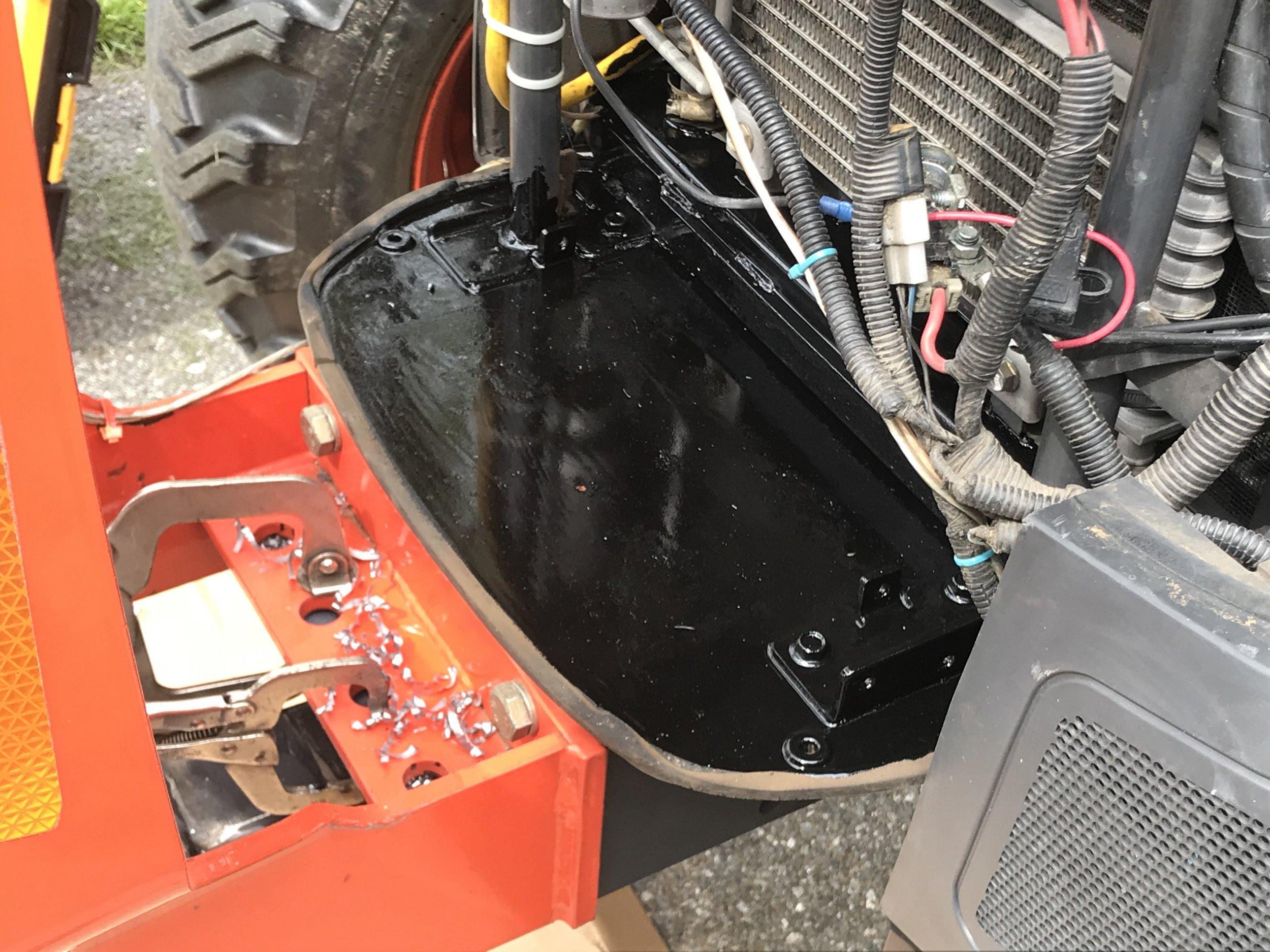

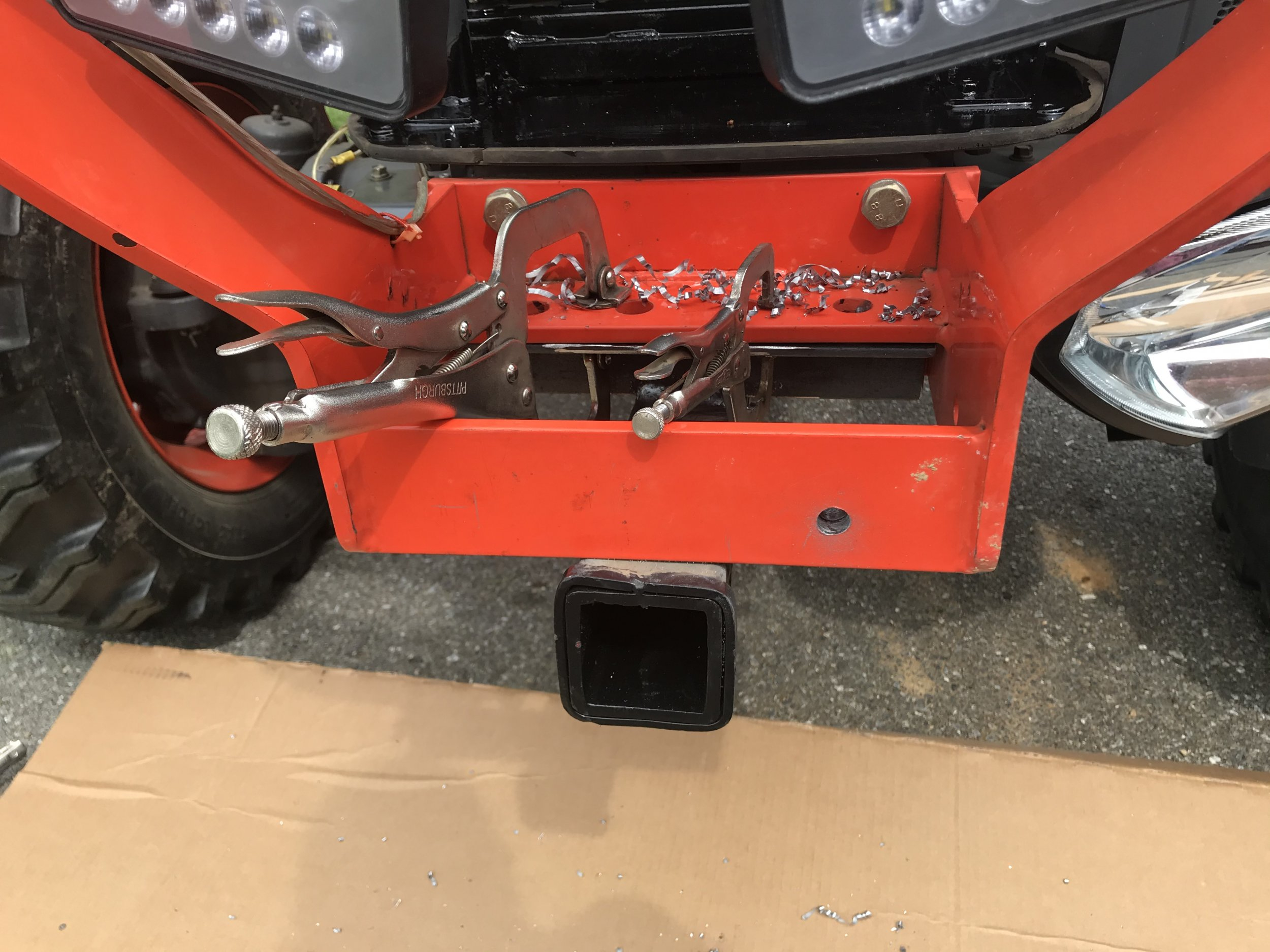

Mounting was easy with a 2" x 12" receiver tube from HF. Welded 3 pieces of 2x2x1/4 to the tube. Front angle has the leg up and is bolted to the front of the grille guard with 2 bolts. Picture was snapped before the second hole was drilled. Next piece is flipped so it can bolt through two existing holes in the GG cross piece. Third is in the leg-up position like the first. That angle isn't bolted, but is simply tight against the inside of the tractor frame. None of the bolts has much of a load on them. The angles lock the little frame into the GG and tractor frame.
While I was fooling around the battery area, it was a good opportunity to clean it up and hit the tray with a 2-part paint.

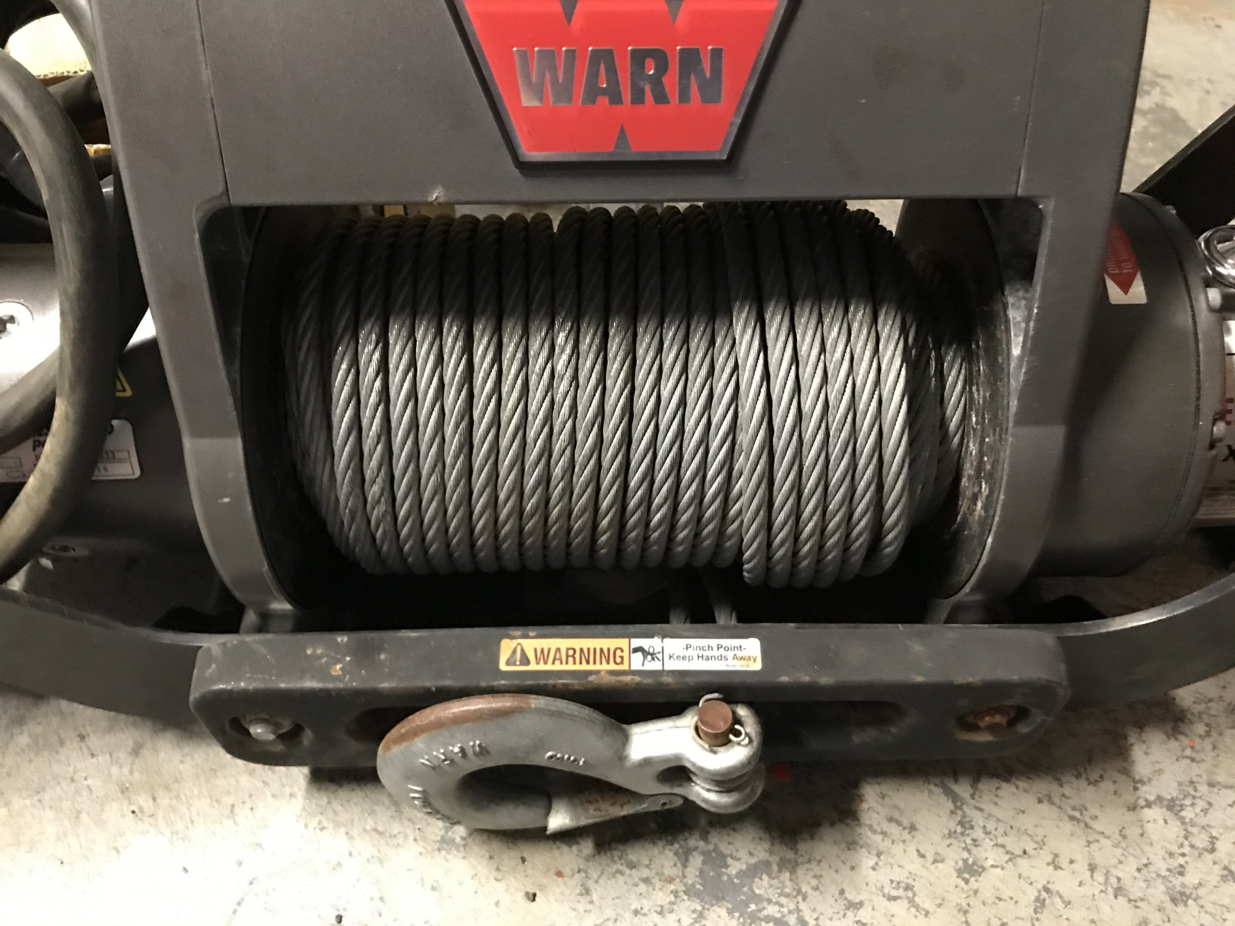

Just be aware the tractor electrical may not be robust enough for heavy sustained winching.... And please unspool cable and rewind, it could really turn in to disaster to unspool when you really want to use it, it was obviously wound loose after last use, and it should have been under some tension....

It looks really close to the ground, how far off the ground is it?

Last official act this evening was getting all but about 5 wraps off and winding it up under tension.

It looks low, but the lowest point is 2" lower than the grille guard. It would affect the angle of approach, since it does stick out some. Pretty certain the loader crossmember won't clear it, but there's a solution coming as a small part of another project. And it wouldn't be a difficult to whip up an adaptor for the drawbar to use it on the back.
No definite plans on what to winch. The tractor mount was mostly a fun project. The L4240 doesn't weigh nearly enough for serious pulls. For anything more than light work, I'll run an anchor line from the mount and under the tractor to something solid behind it.

Pic below is what it looked like last night after respooling.
