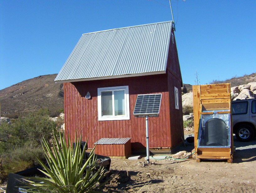

I wanted to share a simple solution to getting power to your outbuildings. I installed this 67 watt panel along with two six volt batteries a controller and an inverter and wham power!
The entire thing cost me about a thousand bucks and I have enough power to run several lights, and a TV. I will use this small cabin as a place to stay while I am building my house and with the solar I no longer have to listen to the generator.
My next step is to run some electricity to my tractor/ carport.

I see the bread box water heater, what is the source of the water? Is your solar system also pumping water? How about a refigerator? Do you have a propane one?
Jim
   / Simple Solar shed
To run my well pump I use my generator. They make a solar well pump and panels but I found out this after I had already bought my well pump and at 700 feet I am not changing it out until it stops working. I'll have a 10,000 gallon storage tank so I will not have to run the generator very often.
No refrigerator for the cabin. When I build my house it will have a propane refrigerator. I only stay out there for two days max so I simply use a cooler.
The "bread box" you see is actually the back side of my solar shower. It works great in the spring, fall and summer but it's a little chilly now at 3,300 feet even in Southern Ca.

Can you post a materials list for your solar setup, and maybe where you got your supplies?
Thanks T.
   / Simple Solar shed
I purchased everything from Backwoods Solar out of Sandpoint Idaho. Give them a call and they will set you up.

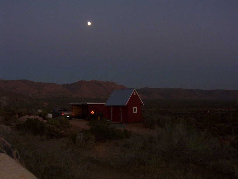

My property is about an hour east of my house in El Cajon, CA. Near Jacumba CA.

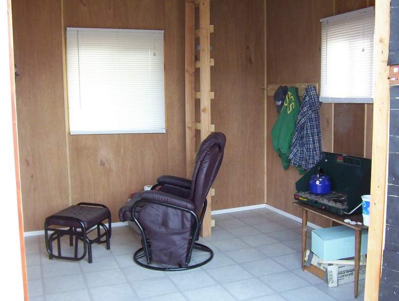

The shed/cabin started out as a place to keep my motorcycles but once I started building it I decided to add windows and a loft so it ended up more like a little cabin. I then built a shed for my tractor and my motorcycles.
Here is a photo of them as well as a few interior shots.

That's one comfortable looking setup also looks very peaceful...moon light for street light can't beat that.

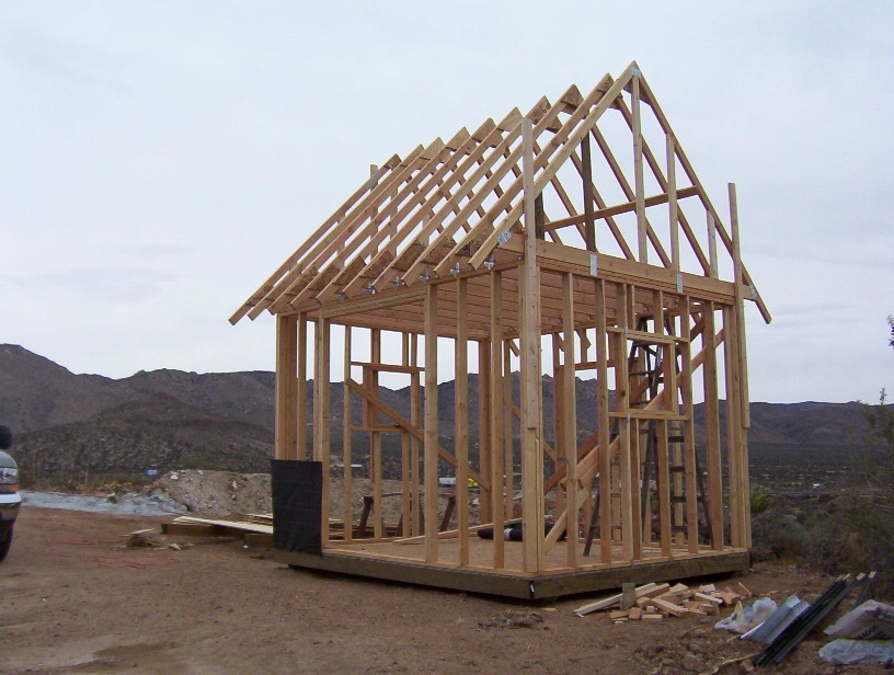

Nice shed, what size is it? I am starting on a 12x12 building tomorrow to house my rc planes so i can get them out of the house.
   / Simple Solar shed

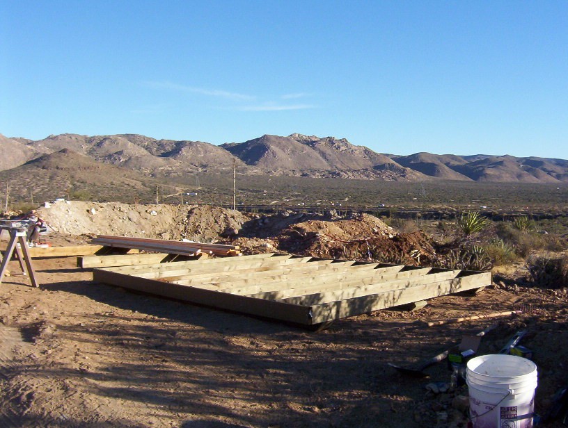

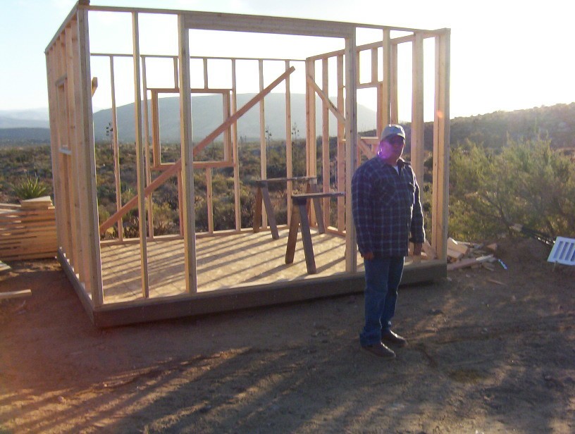

The Tractor storage shed is 15x20 and the cabin/shed is 10x12 and a loft. It has a 12-12 pitch so there is a lot of room upstairs, the entire building is about 15 feet high. I wouldn't make yours near as high.. unless you plan on sleeping in the attic/ loft!! or need the space for storage.
I used 2x4 walls, 5/8 sheeting on the roof, 2x6 floor and ceiling joists. Everything is 16 inch on center and I built it on 4x6 skids.
