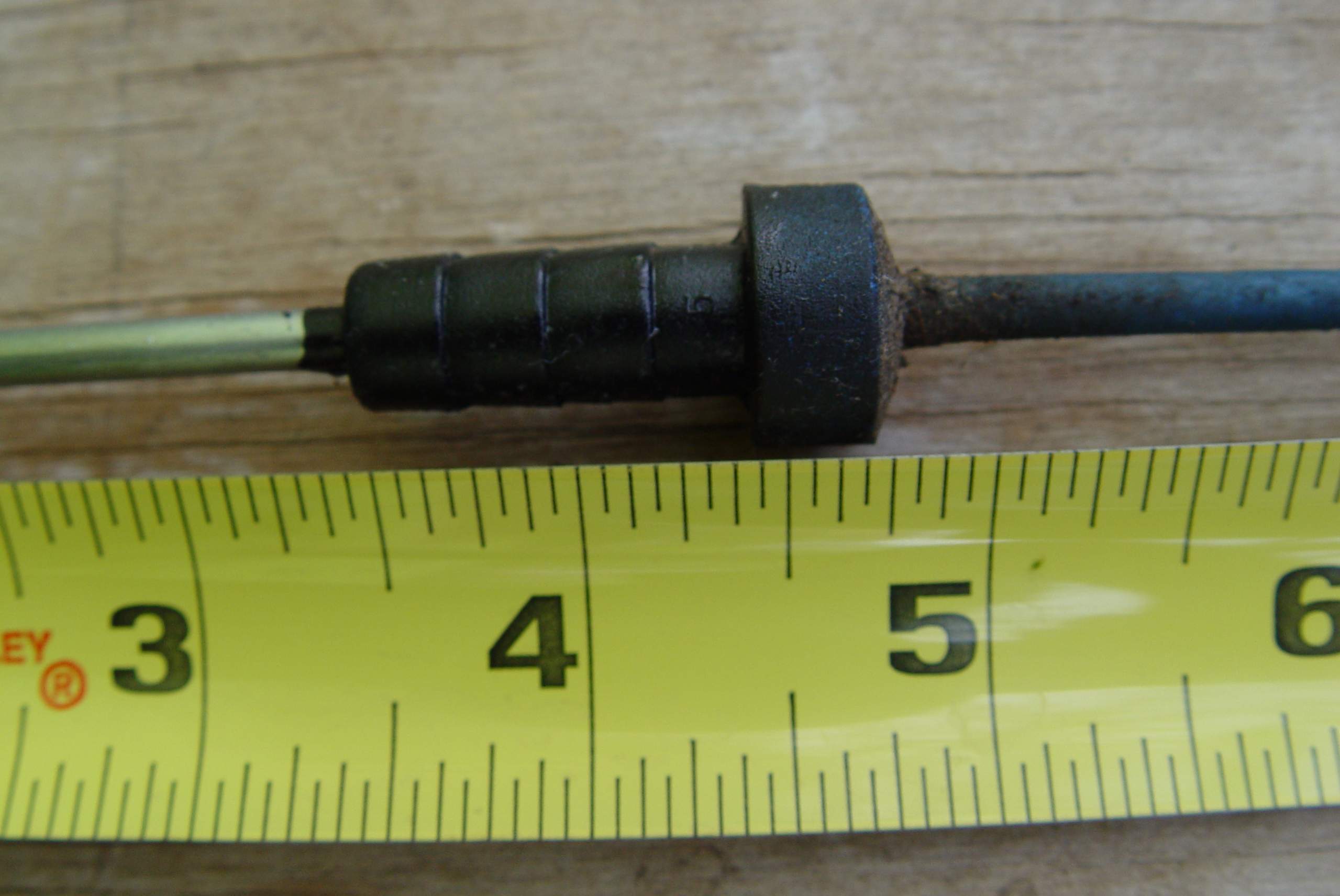

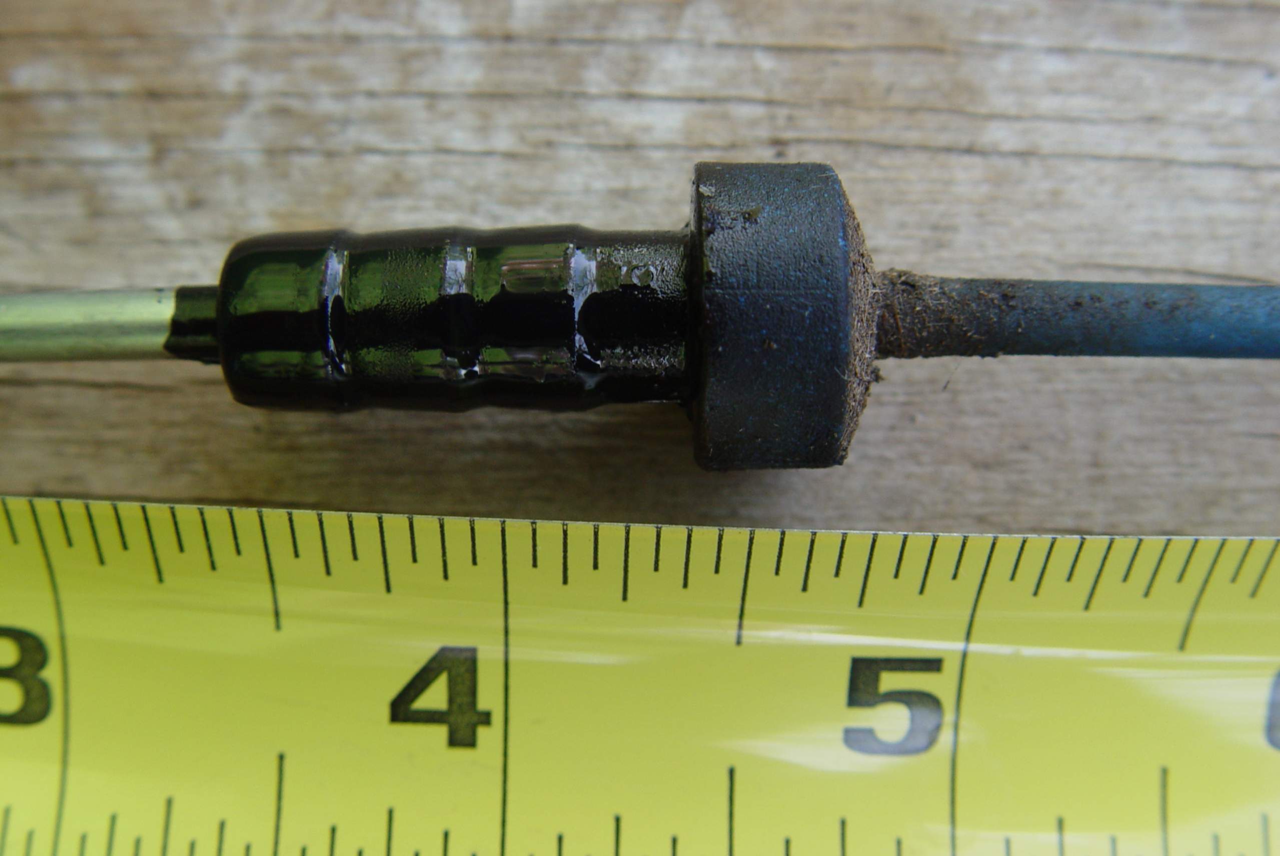

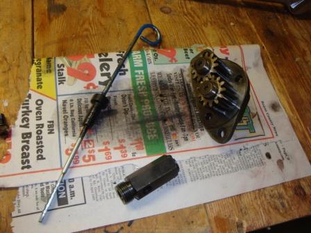

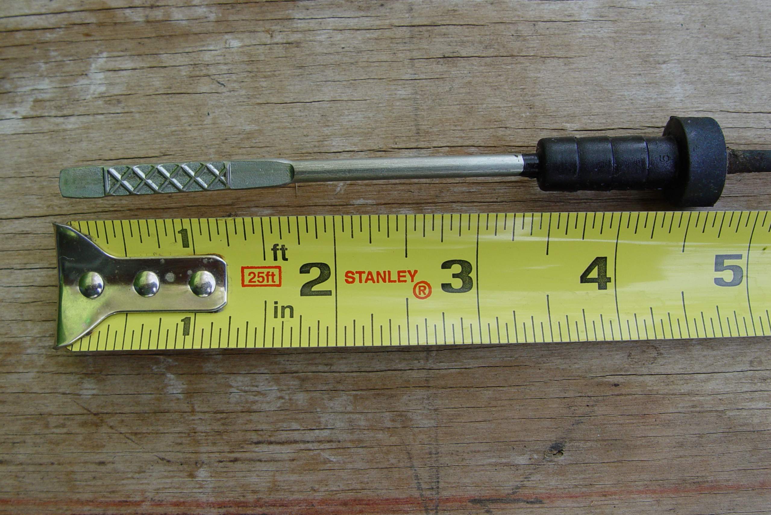

These pictures from my 1700 also a 1981 (double click on the picture to enlarge) as near as I can tell if you set the top of the rubber flat area (not the dome but the widest part) at 4 11/16 up it will be as near as possible. When I change oil and filter the new oil always shows 1/16 to 1/8 inch above full and stays there. To the underside of the rubber stop plug looks like 4 7/16", I hope this helps. Ray I
I have a great close up camera if anyone needs pictures of the outside of a 1700 I will be happy to take some for you. Anything visible without disassembling the tractor can be taken. Mine is a 4 X 4 that I bought new.
