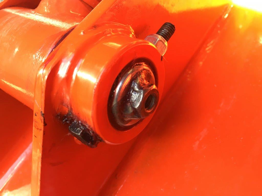

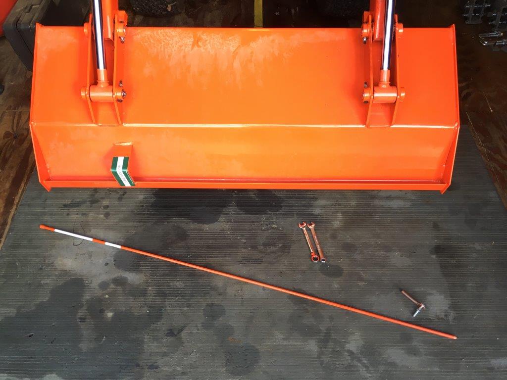

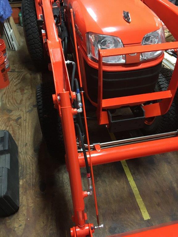

Another option for a Front End Loader (FEL) Bucket Level Indicator...
I saw multiple posts on TBN and around the internet for DIY FEL Bucket Level Indicators while looking for ideas for one to install on my Kubota B2320 w/LA304 FEL. I set off to town to get the 'parts' after I had decided on a variation of several different 'designs'. My initial design was going to be the typical steel rod, but that changed while I was shopping/configuring and I came up with an indicator that consists of very inexpensive parts and was a fairly quick & simple install. I decided to go with a fiberglass rod as it would be more forgiving than a steel rod, if bumped (and I liked that the orange rod was a close match to the Kubota Orange). Stainless steel hardware was used to ensure a clean and maintenance free installation.

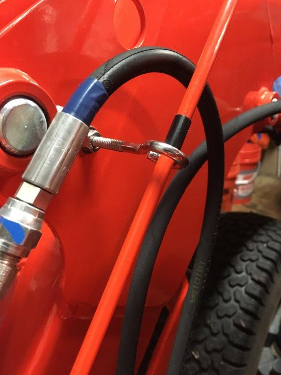

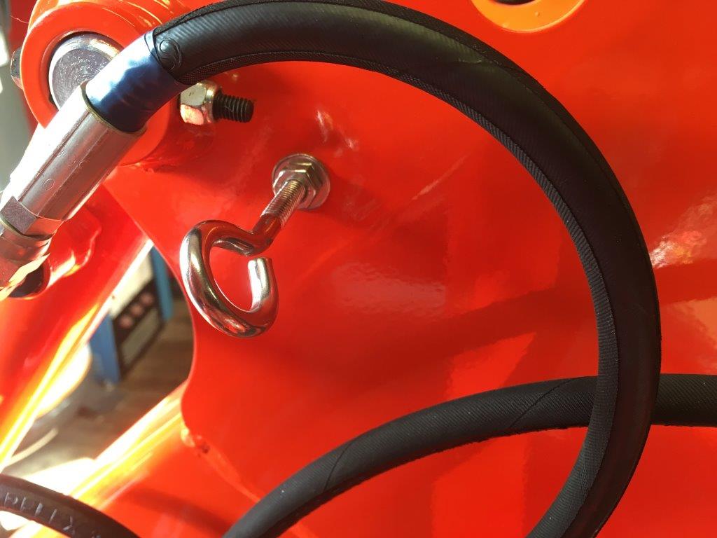

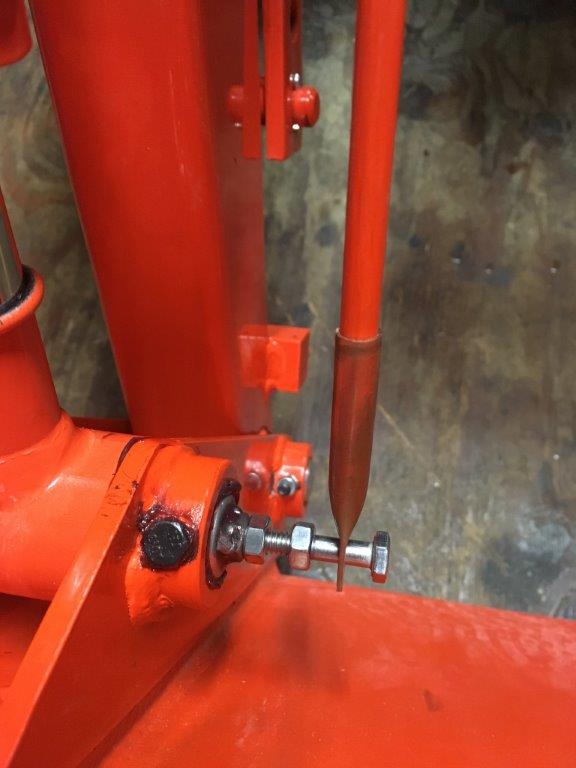

- An eye bolt was used for the rod 'guide' as the LA304 FEL already had a couple of factory holes near the bucket cylinder pins on the loader arms. A 3" eye bolt was chosen to ensure that there was enough clearance between the rod and the bucket cylinder hoses.
- Rather than drill & tap the cylinder pin at the bucket, a 1/4-20 nut was tack-welded (on 3 of 6 nut 'flats') to the center of the cylinder pin to create a mounting point for the rod 'pin'.

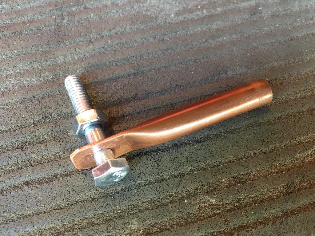

- A 1/4-20 x 1 1/2" bolt was used as the rod pin. A nut was 'bottomed' at the end of the threads, limiting the travel of the rod end to the bolt shoulder between the bolt head and nut. A second nut was used as a lock/jam nut against the welded nut to lock the pin in place.
- A piece of 3/8 copper tubing was used for the rod end as the fiberglass rod slipped snugly inside. 3/4" of the tubing was flattened to form a 'tab' and drilled with a 1/4" hole for the rod pin. The original plan was to use a 3/8" x 3/4" long steel spacer and tack-weld a 1/4 flat washer to one end to use as the rod sleeve/end. Another variation would be to make or modify a clevis end to slide onto the rod. Both are still options if the copper rod end doesn稚 hold up.
- Rod was trimmed to 2" above the eye bolt guide with the bucket in the fully-dumped position and the protective cap reinstalled.
- Electrical tape was used to mark the 'bucket level' location on the rod at the eye bolt guide.

   / Simple & Inexpensive FEL Bucket Level Indicator #3
I like it, nice and simple. I really like the use of the fiberglass rod.
   / Simple & Inexpensive FEL Bucket Level Indicator #4
Good old "Buggy Whip" Fiberglass Rod. I am trying to figure how this indicates level?
I have never seen one work on a tractor.
   / Simple & Inexpensive FEL Bucket Level Indicator #5
Good old "Buggy Whip" Fiberglass Rod. I am trying to figure how this indicates level? I have never seen one work on a tractor.
It looks exactly like the factory Kubota level on my bucket. It only works at one height and mine squeaked so I took it off. Experience is the best bucket leveler.
   / Simple & Inexpensive FEL Bucket Level Indicator #6
I have to agree with that. I thought about adding a marine trim meter to my little 'Bota but the more I used it I could just tell by the look of the arms/linkage when it was level to the ground. And gauges and rods don't help a bit if you're not on level ground. ;)
I agree on both the experience and the level ground requirements. I just wanted to put a variation out there for the folks that live on level ground and might want a quick reference that is not costly to add. Thanks for the comments.

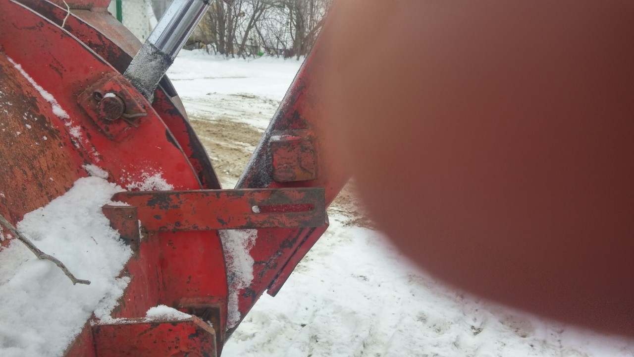

This is as simple and inexpensive as it gets .
As you lower the bucket you can see it from the cab ,the bar was on a pallet of auction junk and the bloke was from factory on the loader .
