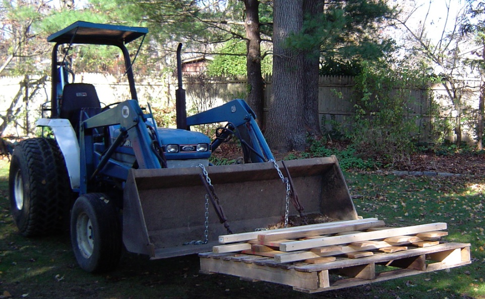

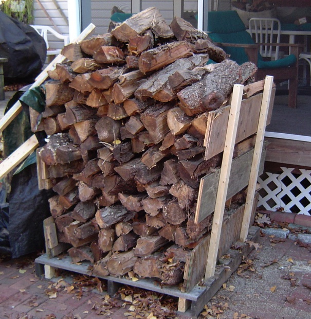

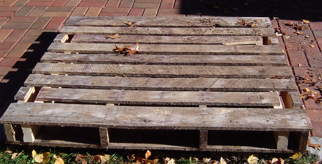

I was looking at what others on the forum were doing with firewood and did not see any racks made this way. The stone quarries use a similar setup, although it's smaller to handle large flat stone. I thought I'd modify it for firewood. Just add a couple of 2x4's to a standard pallet. Cut some slots for uprights and you're done. I figure each pallet holds a little less than 1/4 cord of wood. They come apart for storage and are mostly free.
Thought someone else might use them too!
Mike

Very nice. Now I have another reason to get a set of forks!
   / simple cheap firewood racks #3
Great idea. I just brought home 6 pallets today and was trying to figure our ways to stack the wood on them.
I'll try your method this week end.
