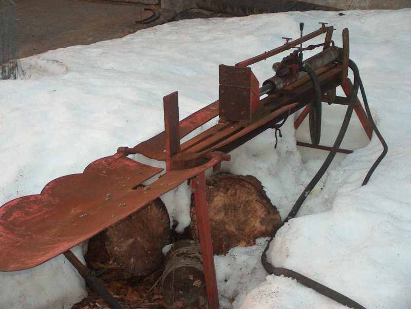

Easy to make. 2c beams back to back, small cylinder, valve on top, handle directly connected to the stroke length adjustment rod.
Tall knife and "pusher" making it easy to split 2 logs on top of each other. No fancy stuff, basic engeneering. Pushes only 5-7 tons, still good enough. Splits almost any seize log if you start from the outside of the log and work your way towards the middle. It will stop if you begin in the middle of a big log.

One more pic

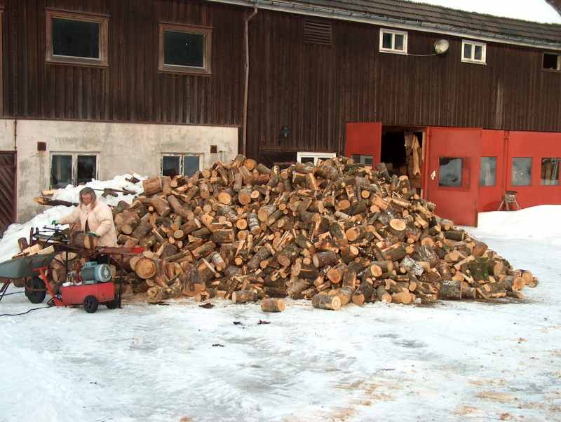

The splitter has been working for 15 years whitout any trouble! For the very few logs I dont manage, I use the chain saw. Here with electric pump
