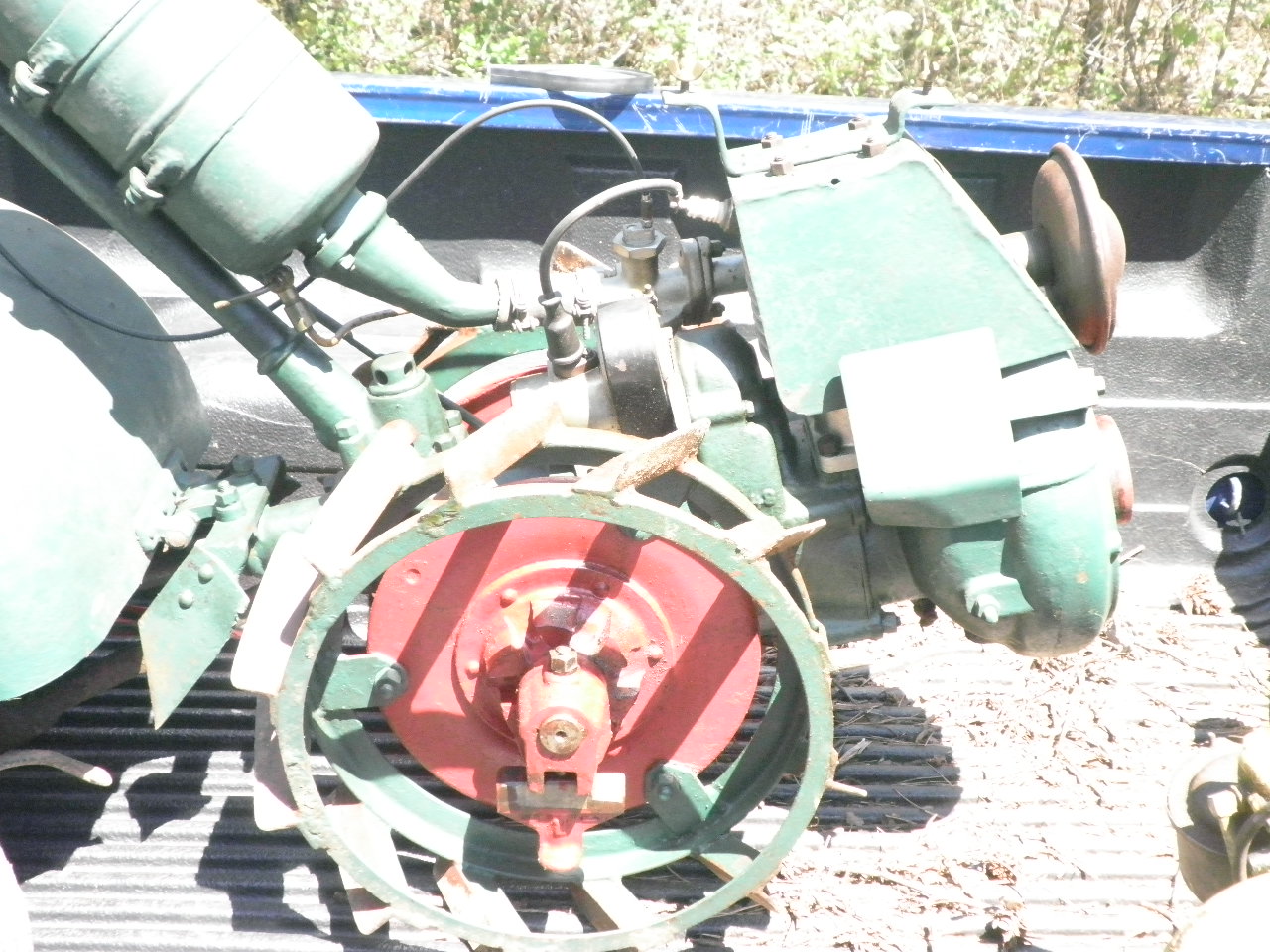

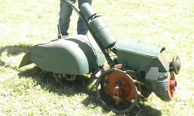

Hi, I'm a new member & I already have a need for your expert advice. I have an antique Simar rototiller first owned by my grandfather, then my father & now me! It has spark issues & will run briefly & then stop. It's about a 1946 model & not much on the web for repair help. How do I check condensor and or magneto? The points seem ok & I have fresh fuel every year. Any help with a Bendix magneto or ignition system help is much appreciated. Thanks!:confused2:

Success at last. I cleaned points once again & made the gap a little smaller. Made sure timing was perfect. It started first pull!!! I finally got garden rototilled & partially planted. Would be nice if the rain held off enough to get everything planted! Thanks again for the help & encouragement. H
