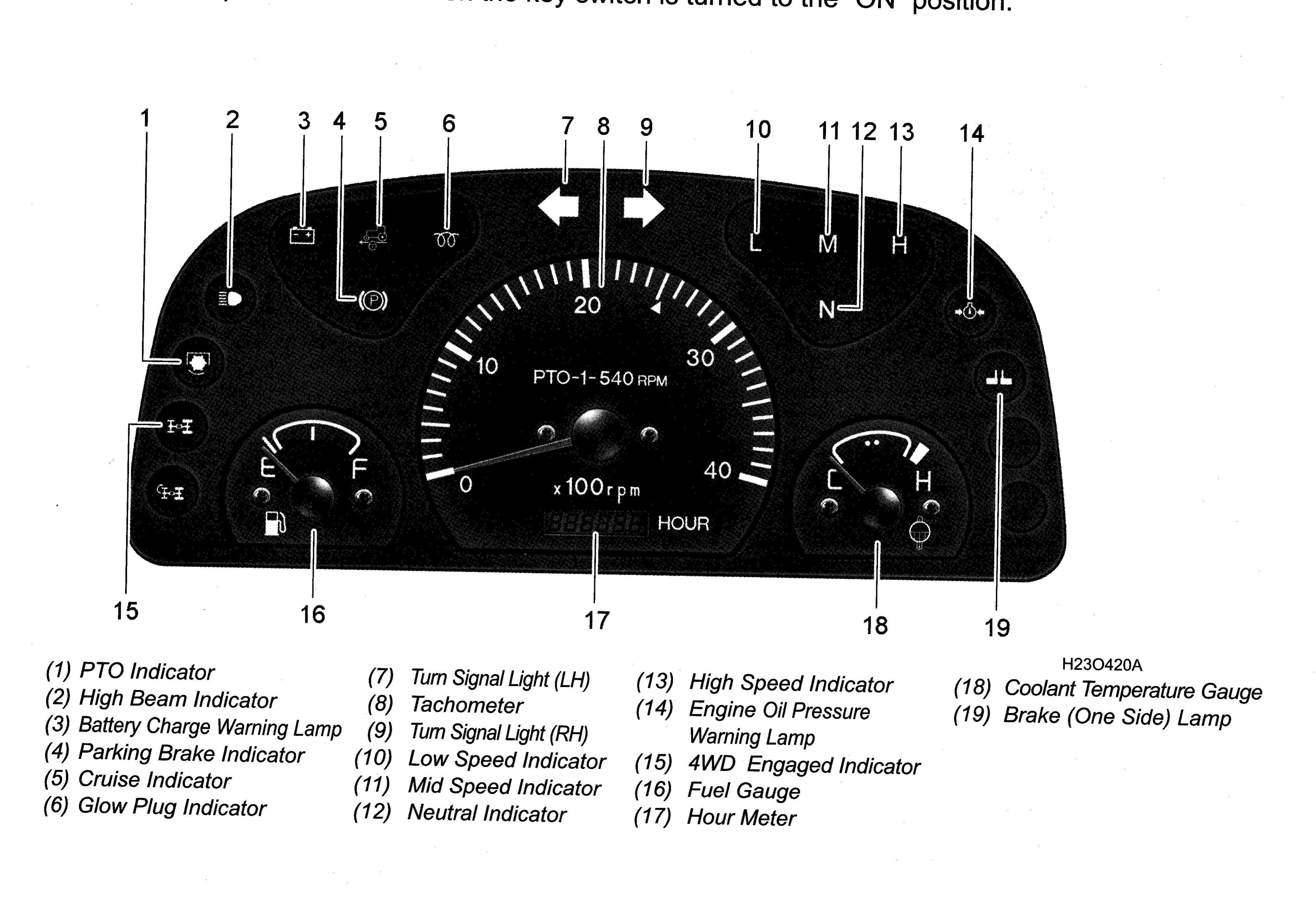

i was reading the tractor manual and one of the instrument panel idiot lights shows an image of a tractor drive line and its called "4 wheel drive engager light " which illuminated when tractor is in 4wd.
but right below it is the same symbol with a arrow in front of the front wheels and there is no mention as to what this idiot light is for. (its the one below #15)
any ideas????
also.....the manual states that the hour meter reads in 1/10 of an hour increments, but mine is only reading in full hours. how about yours???

The hour meter on mine just reads in full hours also.

my manual states the last digit on hour meter is tenths, i know this is wrong otherwise i only have 2.8 hours on my tractor after a month of using it :laughing: :laughing:

I have gear 2009 DK45S and the hour meter shows tenths. They are different color than than the hrs. I have some tractors that show tenths and some don't.

My CK27 HST does hours only now got 96, and H range work on road on a flat surface or going down hill LOL, M & L for any sort of work.
