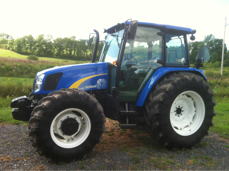

I just put a set of ag tires on my agco 2027 (27hp diesel subcompact) which I plan to use for plowing this year. Two questions: how bad do again tear up a hilly lawn when mowing? And, which way is the "v" pattern on the tire tread supposed to point? Forward or rearward?

To answer your second question...

If you take it easy on the lawn. No sharp turns you should be fine. The tires when looking from the front will point towards the ground. There will also be a arrow on the sidewall that says "forward". If you put the tires on backwards they will not drop the mud like they are supposed to. I have seen them on that way and they look goofy. A picture sums up what I just said best.
