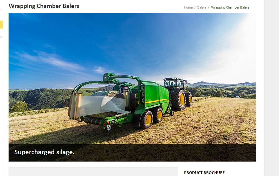

I'll add to what Rick stated that most silage bales are baled at a smaller diameter than dry hay due to the extra weight of the bale. I think the hay is baled at around 65% moisture. Some baler models such as JD,Krone & McHale bale and wrap on the go.

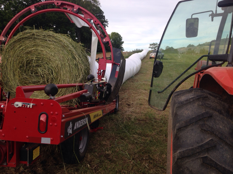

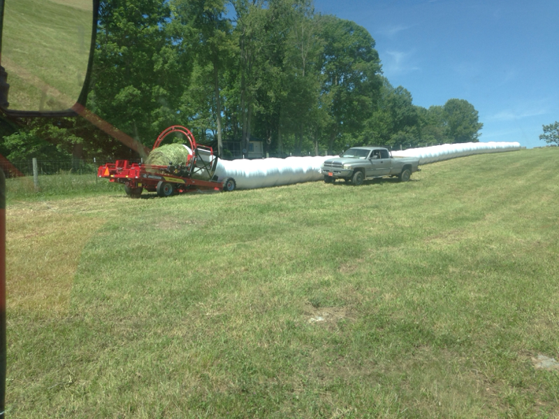

Most folks around here seem to have went towards using "inline" wrappers, although there are still plenty of the single bale wrappers around.
Inline wrapper.
http://youtu.be/5ho-Lev2gsU

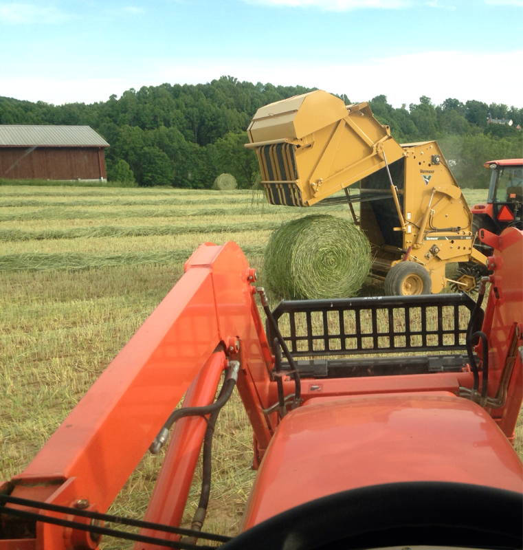

I helped a friend wrap some of his hay this summer. He did the baling and I fed the wrapper.
   / Silage balers? #5
I meant to say that he wrapped some of my hay this year and am currently feeding 50:50 dry and wrapped hay. The cows tend to migrate to the wrapped.
While I have helped others in the past wrap their hay but this is my first year feeding any. One thing I have noticed is that if there is a hole in the plastic you may as well dump the roll over the hill and get another one. The hay will be black and have mold near the hole, not something the cows willingly eat.
