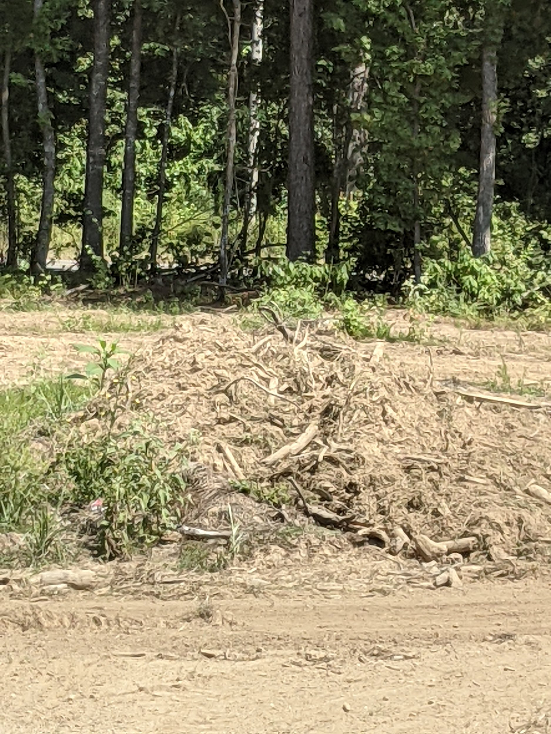

Hey guys, it's been a while! We just finished up building our shop house, and now I'm out to get the yard in order. I borrowed a landscape rake to rake up all the small stuff left over from digging stumps and the dozer pushing everything up, and it works great! But, it also grabs a lot of dirt, especially if the weeds and grass have started growing up. I raked some this weekend, and I have a pile of small sticks, roots, grass, and dirt. This pile won't burn because of the dirt obviously. Any tips on sifting out all the dirt somehow? Should I just pull the pile down a little at a time and pull out the woody stuff by hand then disc in the grass and dirt (please say no...)? I have a box blade, and I have access to a landscape rake and disc. Dad has a rototiller, but he's not fond of using it where there's still so many roots and all. Picture of the pile of junk is attached.

Roll the pile 3 or 4 time and leave in the sun.

With more skillful raking you could eliminate most of the dirt to begin with but at this point without a screening device I don’t see much to do besides separate by hand.

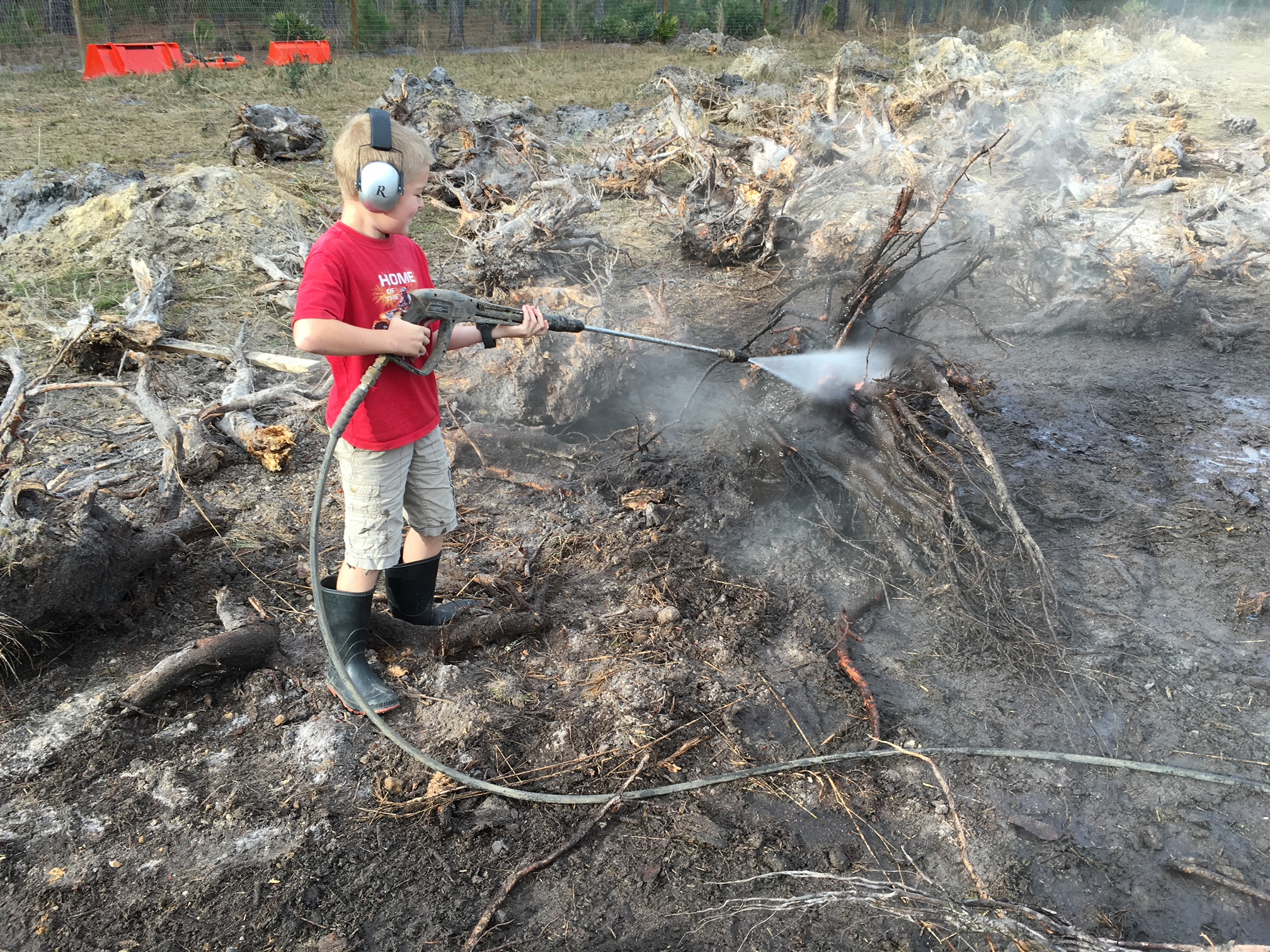

Pressure washer is my tool of choice for that nasty sticky sand/dirt on stumps and roots.View attachment 709981
On stumps that size I’ve found picking them up and dropping them on a stump that’s still in the ground to be extremely effective at knocking the dirt out.
How much of a hurry are you in? Do you need it cleared NOW, or can it wait? You're in a wet area. Rain will work wonders, but it will take time. Break it up, spread it out a bit and let Nature do the work.
