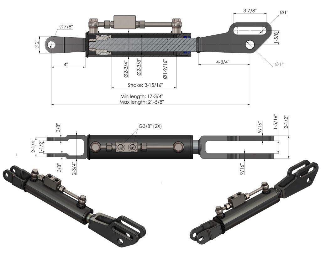

Ok.. I’ve been looking all over for a side link and it appears that I’ve totally missed the bus.
My fixed side link is 19 or 20 inches depending on which hole I use on the fork.
As I understand the use of a side link, it would be best to have 4-5 inches of movement at least….
Some have said 3 up and 3 down from level.. but I have not found a link such as that.
What advice does the hive mind have ?

Your Kubota uses a 4" stroke, so 2" in each direction. Your Yanmar uses a 5" stroke, so 2 1/2" in each direction from implement being level.

Has anyone purchased a side link from Spare Parts Holland? How well is it working?
I do not know why there is a slotted hole on one end. Any ideas?

Because it is made for a different tractor. There are tractors that have that slot on the lower clevis. Most commonly on certain LS models.
The linked to side link will not work properly for your Kioti DK series tractor.
Be sure to check ALL dimensions before purchasing off the shelf units.
