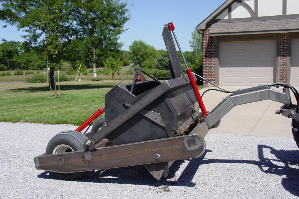

I wonder if anybody has built a "mini dirt pan scraper" for a CUT, and I don't mean just a pond scoop. I just worked a friend's driveway this week with a rear blade. I wish I could have just scraped up all the gravel at the bottom of his hill and moved it to the top, but there was too much material, too much slope and too much distance.
Do you mean like this?
Hoelscher Commercial Products - DB Scraper
or this Model 300 Dirt Scraper,3 cubic yards,Rowse Hydraulic Rakes Company Quality Haying Equipment, Burwell, Nebraska
or General Information about Mini Dirt Scraper
Some enterprising individuals have made them for themselves too. There are a couple of threads which give a little detail about scrapers that are sized for smaller machines. Cute working miniatures of the huge machines that are used on major "cut and fill" projects.
