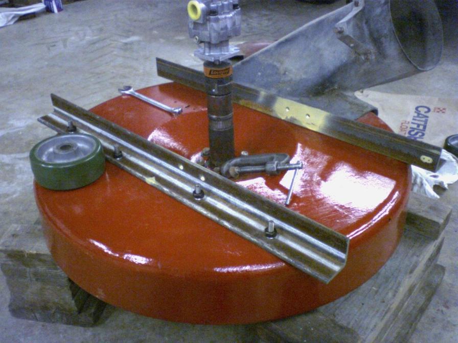

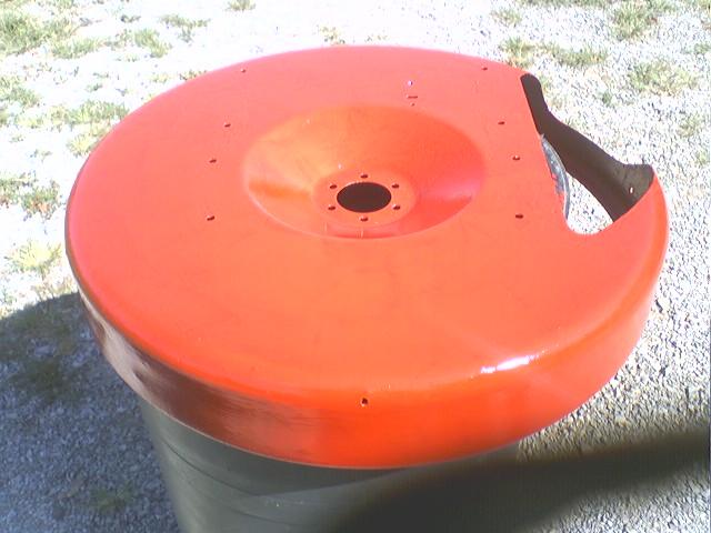

I am starting to build a side mower. I believe this will be the hardest project I have taken on yet. It will most likely be 2 or 3 weeks before finishing. I will post more pics as progress permits but for now does anyone recognize this deck?

Looks like a Snapper deck.
   / Side Mower #3
Are you going to put an engine or a hydraulic motor on it?
   / Side Mower
Yes that is right JJ it’s a 28" snapper deck. I am of course going to us a hydraulic motor and build it somewhat like Power tracs. There are so many advantages in making it hydraulic. The motor is a .7 cc. I hope I have calculated right!

I would just match your pump output to a hydraulic motor, seems like it would be larger that .7cc. You don't want to much pump , and not enough motor, or the relief valves would be bypassing. I believe that your pto output is solenoid control, and therefore you have full output at all times, where as mine, has a handle control, which I can control the hyd flow. The blades for this deck would normally turn about 1600 to about 2500 rpm. I have used the Snapper decks before, and they will suck the dirt right out of the ground with that rounded deck.
