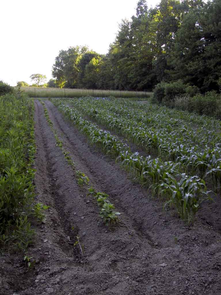

I remember talking to my neighbor, who's an old farmboy from Northwest Ohio shortly after I had hit the corn with urea. He had seen the corn shortly after it had come up (it was late in the year, we planted late) and it was still pretty small ..... he didn't hold out much hope. A week or so after that it really took off. Unfortunately I never got any pics of it after that .... attached is an image which was taken July 2nd probably around the time I put the urea on. It ended up being around 6' - 7' tall and tasted pretty good.
.... anyways we (and the deer) really liked it.
