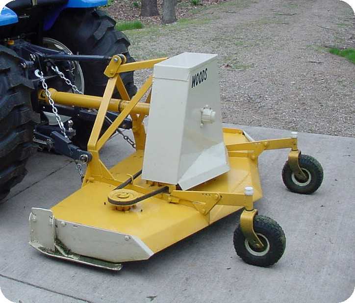

Andy, my old Woods mower is both. The only difference is removing the side shute, and replacing it with a plate. The plate is identical to the one on the near side in the picture. I've used it as a rear discharge for over 20 years. No baffling changes underneath the deck were necessary.

On my rfm, the discharge opening is virtually the whole width of the back of the cutter so it doesn't block. Sticks and stuff can still get fired out at high velocity but at least only backwards. I could stop this with a chain skirt if it was an issue which it isn't.

Yes, the discharge side was on the left, but the plate on the left side is exactly like the one on the right, and that I had a picture of, so I figured, it didn't matter. Nothing else was changed - took chute off and put plate on.

Whow, no wonder the questions! /forums/images/graemlins/blush.gif I posted the wrong picture. Try this one. Plus, the discharge was on the right side, but covered with a plate just like the one on the left, which is in the attached picture. Sorry for the confusion! /forums/images/graemlins/grin.gif
