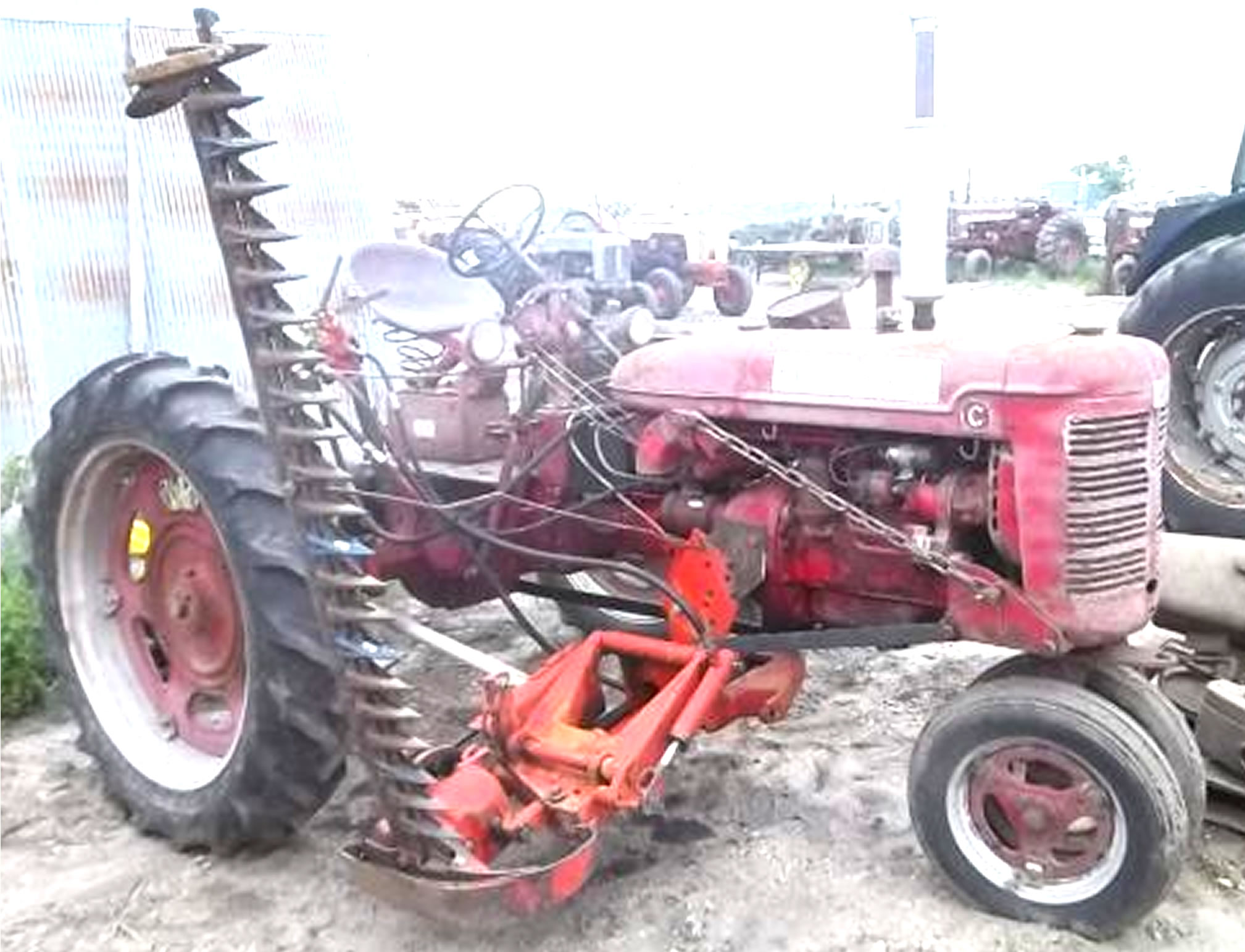

Soon as the weather clears I am side mounting the same IH balanced head mower on an old $400 buck 1950 Farmall C. See image below for a side mount installation:
The mower will be permanently mounted and that's all the tractor will be used for.

I love that side mounted bar.

I have the old rear mount 16A mower for my 42 A and would really like to have a side mount like he one pictured and mount it on my 49 Super A. The side mount is the way to go IMO...
