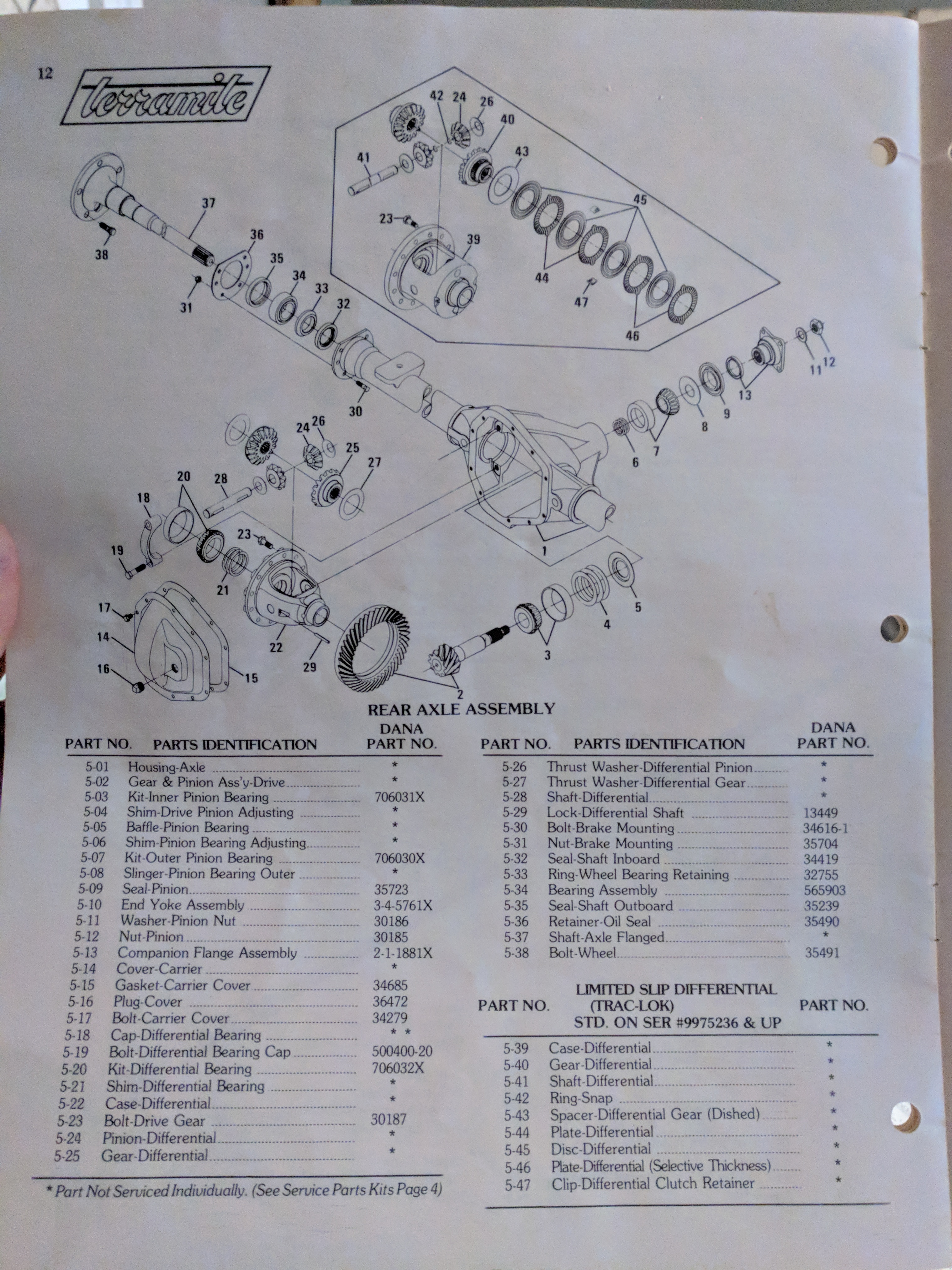

I am rebuilding a T3-15 and like a dummy I loaned it out to my bother...well the hydrostatic rear end, pinion and gear are chewed up. I contacted Conequip. to see if they could help me, but its still up in the air because the T3 is so old...I am asking if anyone has any ideal for a rear end or parts I might track down..thanks jeff

Jeff do you know if the 3-15 shares the same rear end as a terramite 4? If it does I can get you some information on it

You know, I can't honestly answer that because I have never seen a T4 terramite. heck..I never saw a T3 until I bought this one off the side of the road....but I would assume that if its hydrostatic drive rear end and being the next type they came out with...well I would think they would match...I don't know what year they went to shaft drive, maybe T7....? but think you and yes if it hydrostatic drive ...please let me know...I am stumped on this hitting brick walls at every turn so far....1167bp thank you for responding either way..

Thank you....1167bp I will try to use this information in ordering the parts I need...of course that is if they still have them.... think positive right !! this is it...same rearend..I'll get on it today!!

Glad to hear it's the same rear end.. you may be able to source the parts elsewhere too. They will probably just not be able to search "terramite" to find them

well after a closer look, this rear end is a shaft driven not a hydrostatic drive...but the pinion and gear appear to be the same..I sent a copy of the drawing to equipment/terramite and I'm waiting to see what they say....I have the number off the gears, you would think that's all I needed

The Dana 44 diff is popular amongst most Terramite models. The power of the units are in the pumps and their abilities. From around 2013 those diff's were changed. Spares should not be difficult to get.

I have tried eastcoast gear, westcoast pinion, conequip, and dana who refered me to shafer drive who has yet to respond...etc..so if you know something I don't please let me know. I am going to start calling junkyard next. info on pinion is ( 500A14 60 12 V1W173) gear is (02 0598 DANA D 840045 P8L137 60 12) if anyone can help and I will call terraquip too. might as well...thank you TractormanSA...south Africa....really.
