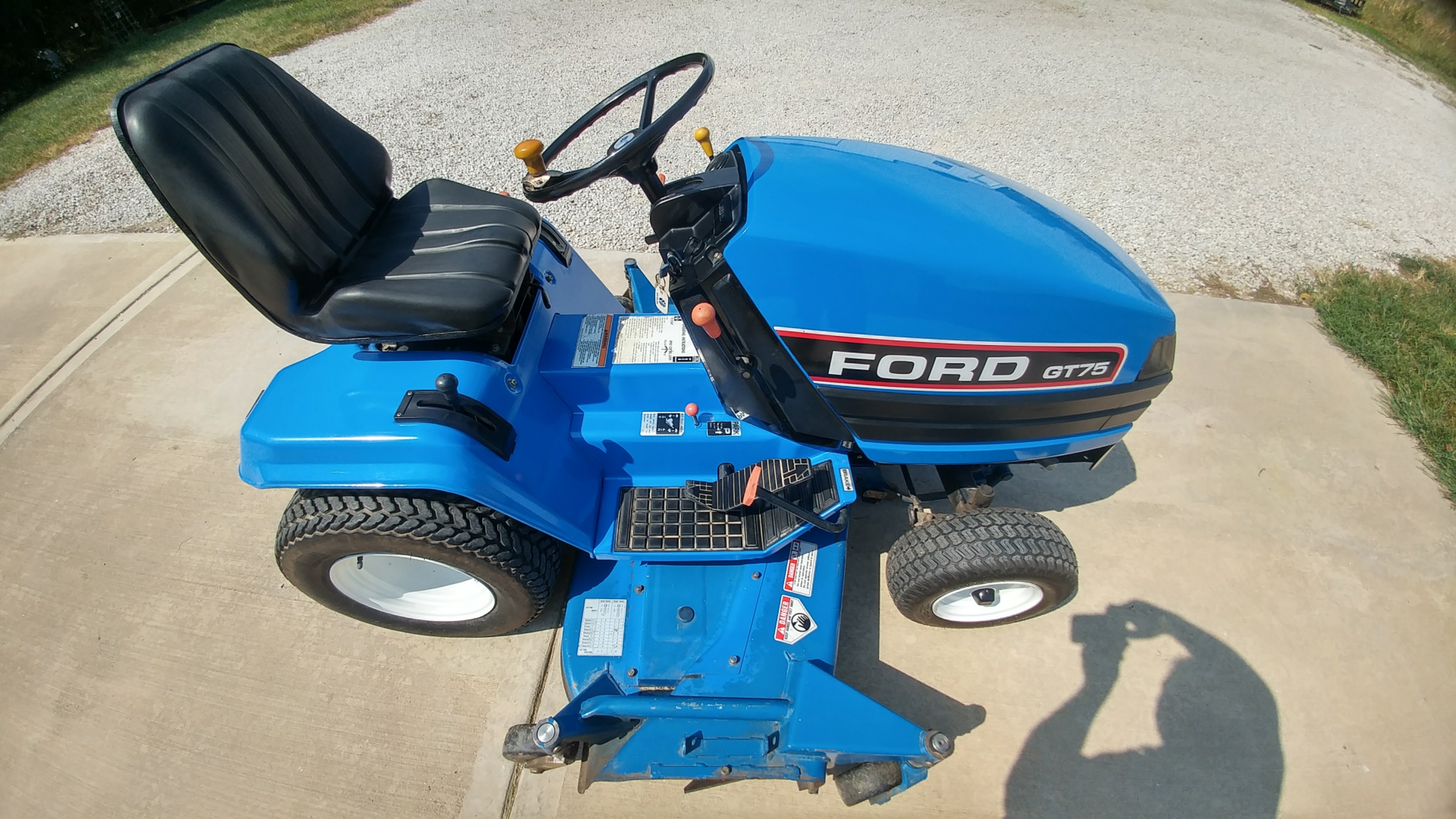

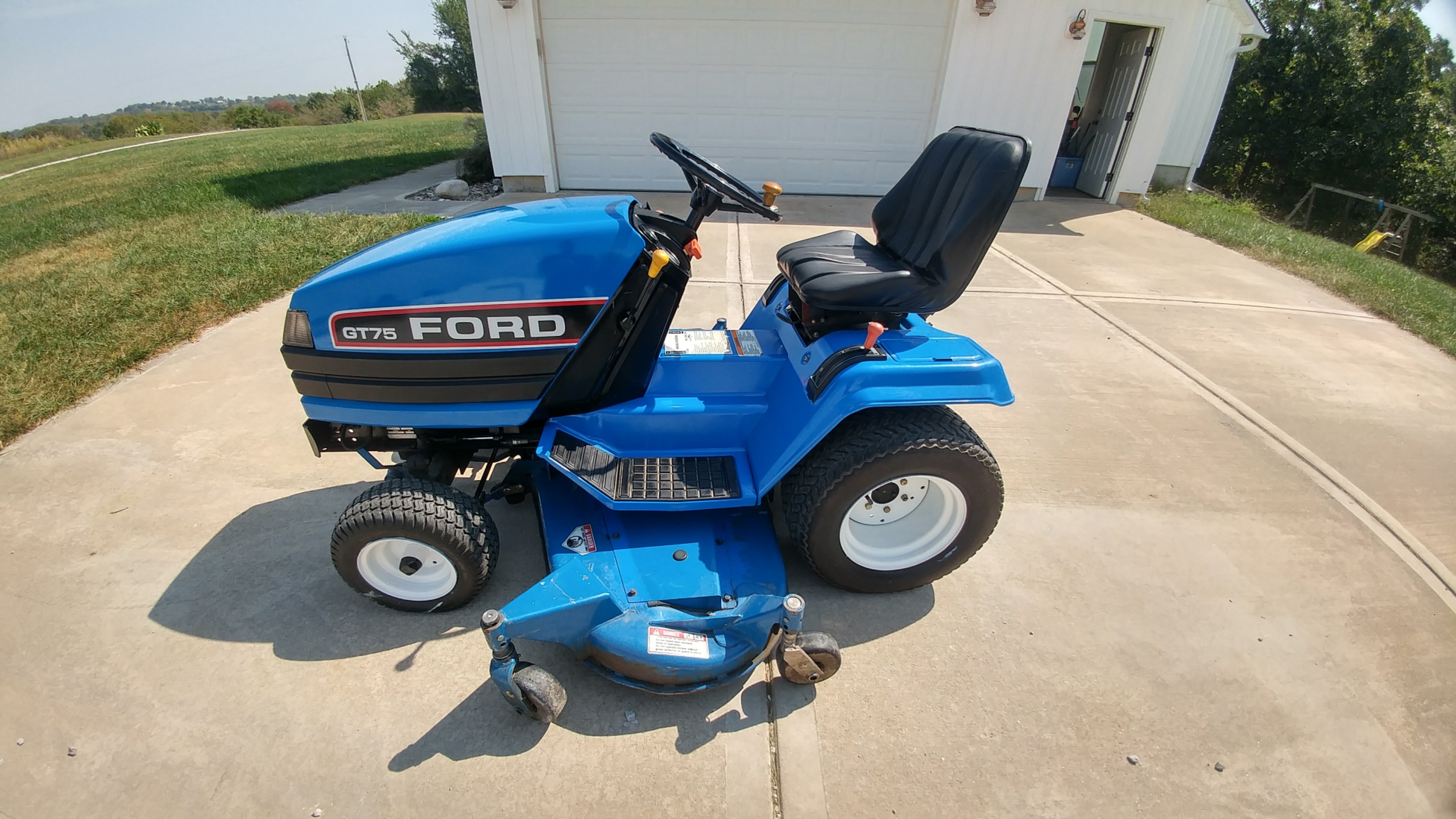

Hi there ETD - I too have owned an LGT17H, and an LGT18H those were magnum kohler engines - they had eaton hydro pumps in them with tecumseh gears/rearends. I NEVER had a problem with either of mine, i then graduated to a GT75 - GT75 Left Side.jpgGT75 Right Side.jpg it was a 1997 and sold then with power steering, hydraulic lift on deck, two speed hydro, cruise control, to the tune of 10K in 1997 - i bought it used in 2000 for 2000 bucks with 50 hours on it because the deck was damaged and unusable and the motor had been rebuilt at 50hours due to the owners 5y/o son spraying up the exhaust pipe and hydrolocking the motor and bending rods - it took a considerable amount of time to repair so the owner traded for a new mower.
you cannot find a beefy mower like that now w/out spending comparable money - i restored the GT65 machine last year, painted it, put in new axle seals, rebuilt deck spindles and sold it for 3K - that would have been perfect for you so start looking at older used units that are in great condition/restored, there are old guys that do it for a hobby because they are retired and you will find something that is well made and reliable. Like you have already stated the older CUB, Deere, Ford, Wheel Horse, Snapper, tractors were more substantial.
the older 400 series were good Deere, 430 is a heavy diesel.
the fords as you know are great
wheel horse made several options

Wow, that GT75 looks nice. I work own/work on a lot of machines, but not really riding mowers so don't know much about which ones are good etc. My house only has 1/2 acre lot, that's where I use the LGT17H, at my land (future home) I cut 5 acres, I use a Ford 1620 HST with 914 deck there.
I don't think I would be happy unless I found a good older unit on CL and restored it. I just wish I had the time to do that.
